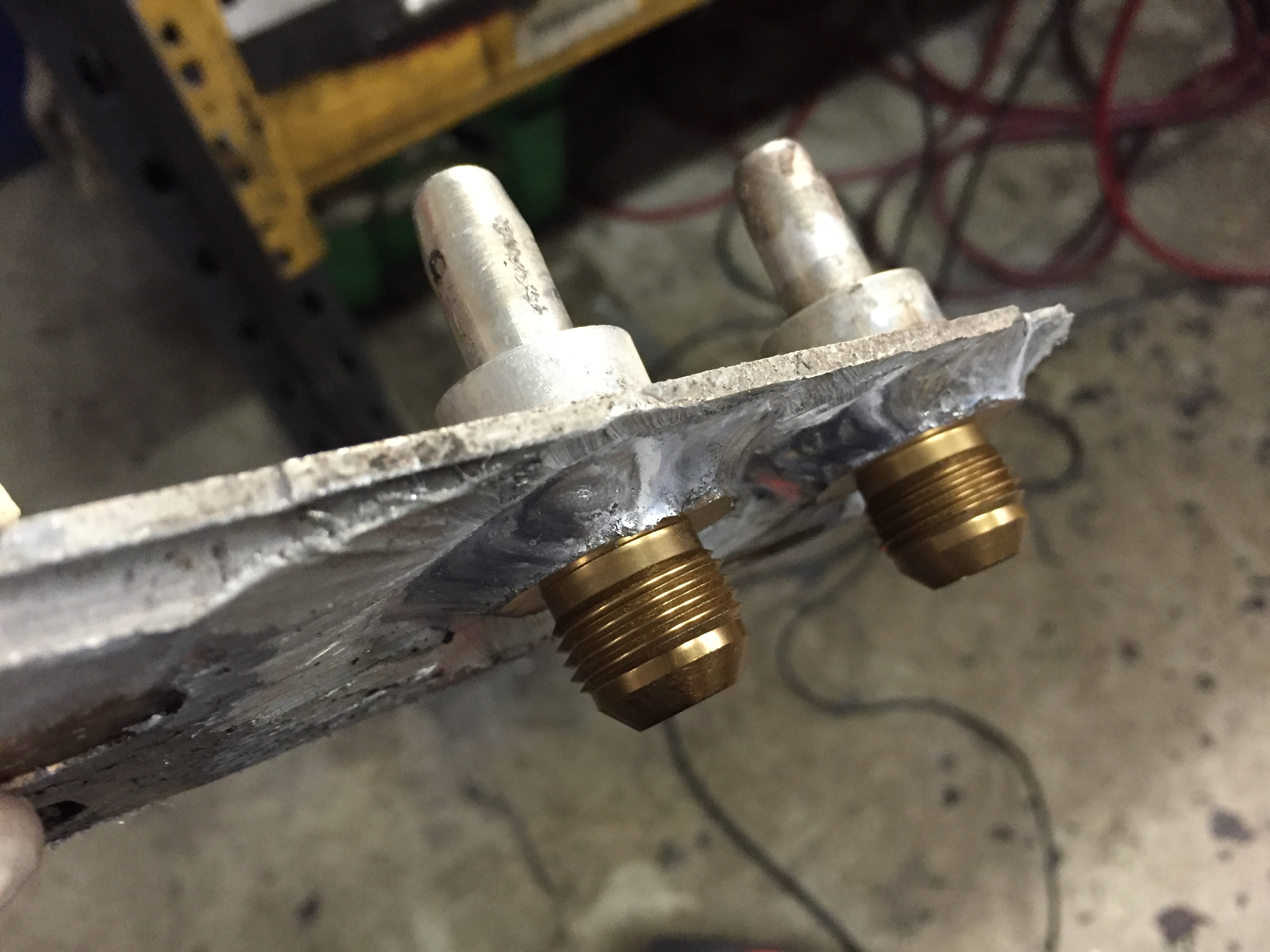

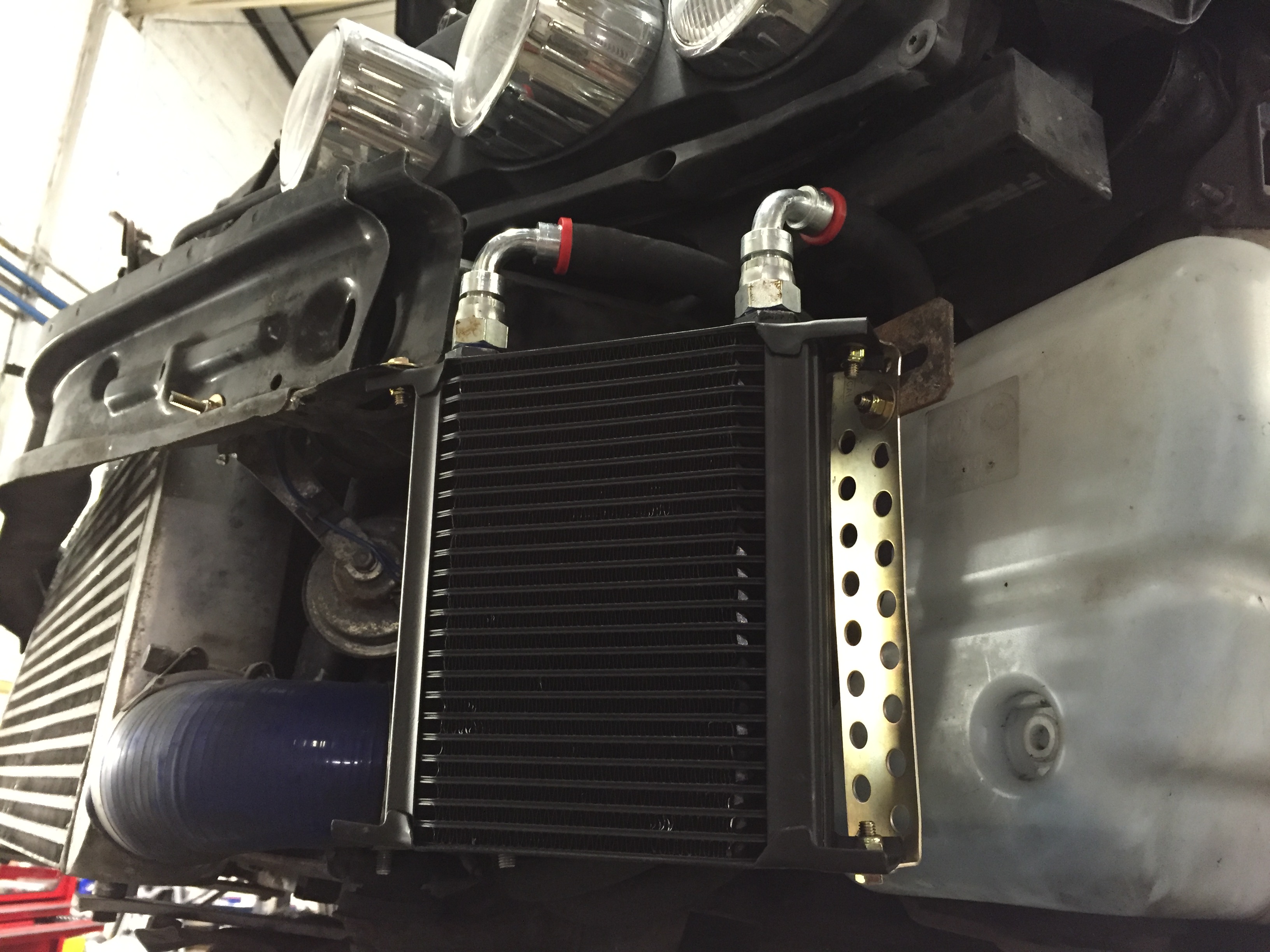

There's an excellent blog post here about someone doing this to a TF-80 on an Alfa, https://jabawoki.com/2016/01/27/alfa-15 ... ification/ He had to make his own adapter plate.
It looks like a good idea to me.

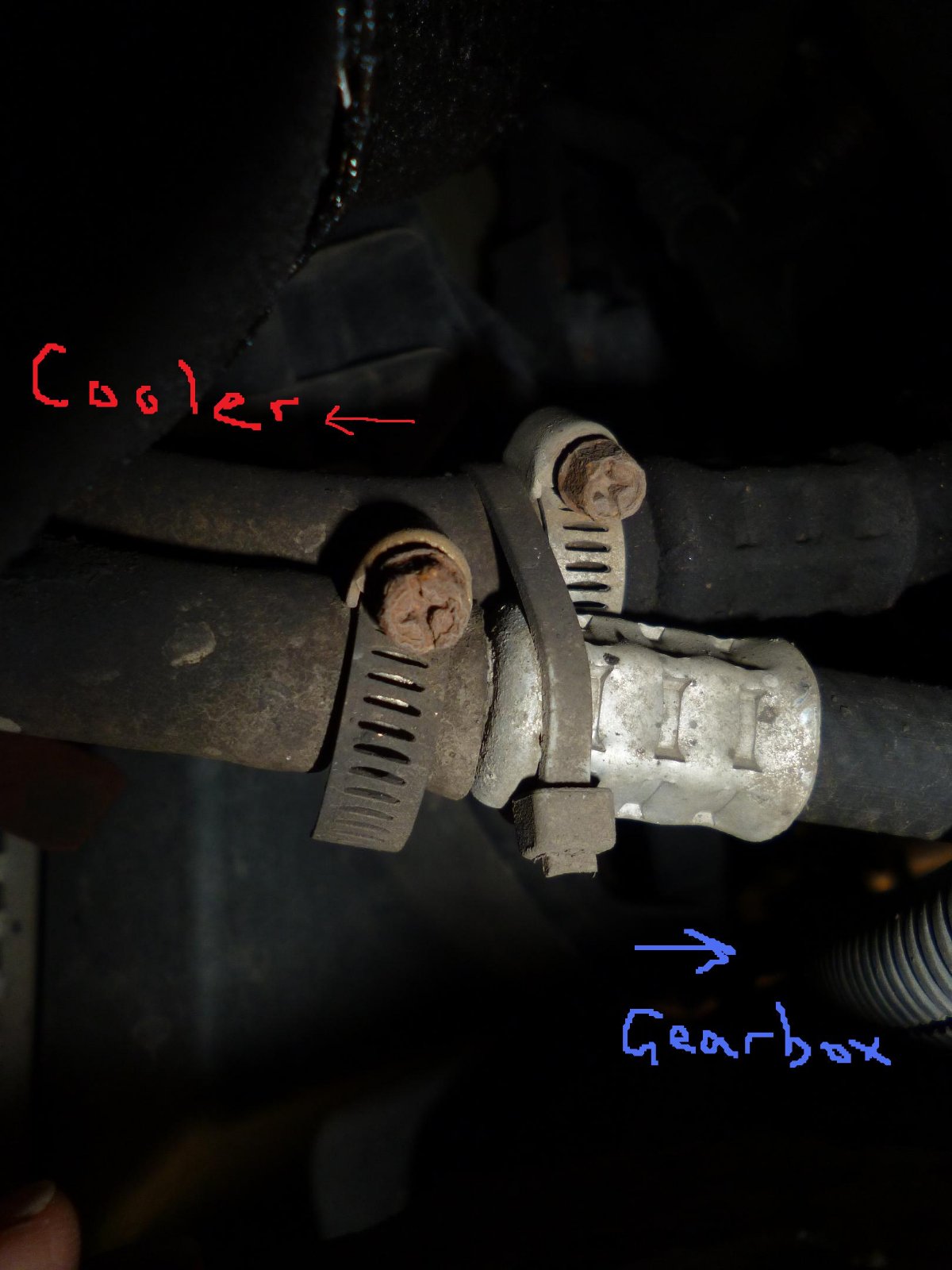

Apologies for the duff photography but this first one is the original connection/original pipes coming out of the box directly..no adaptions made as far as I know.
n falcon own work
n falcon own work

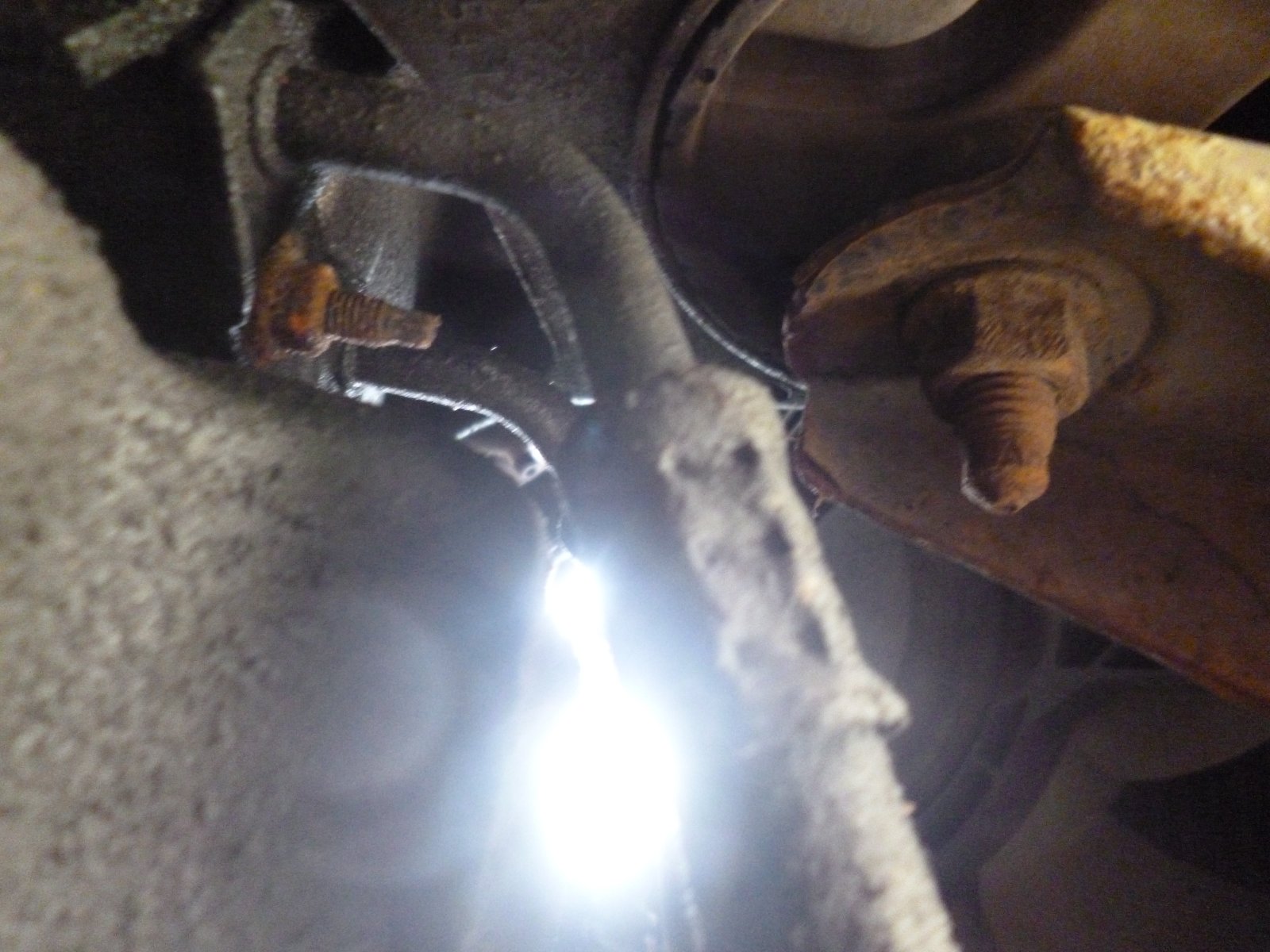

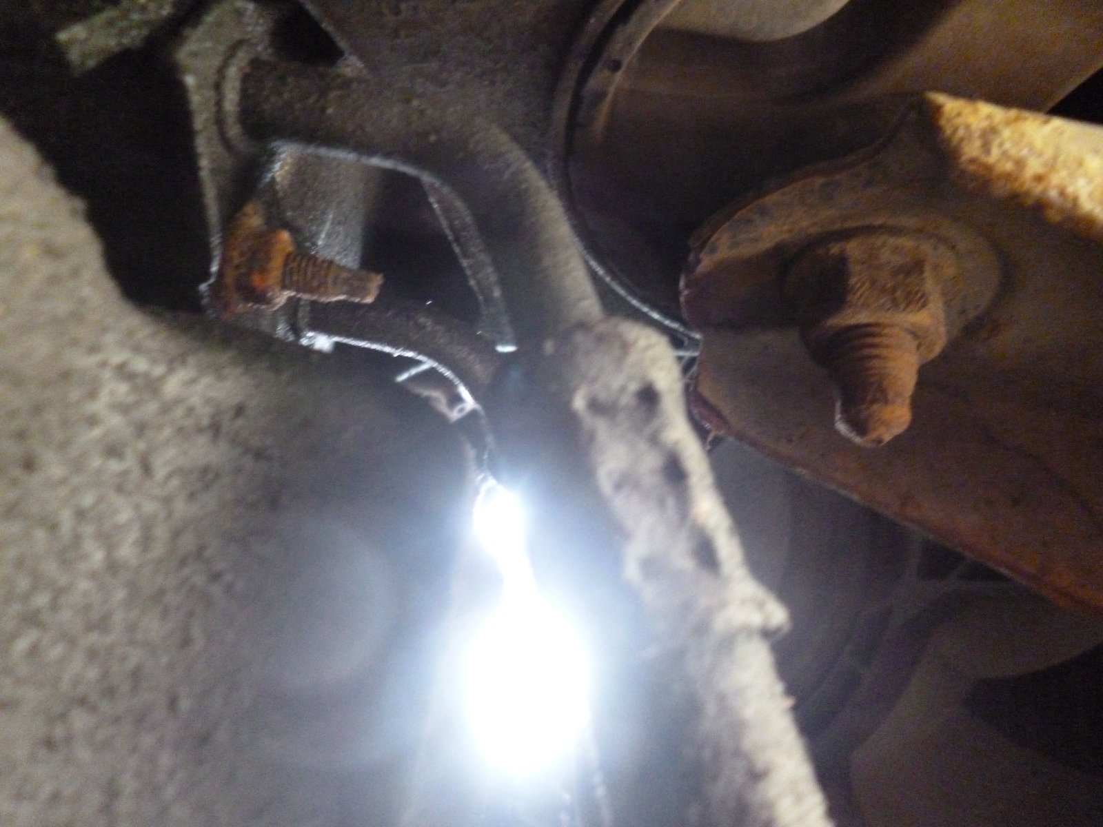

To fit the new cooler, I presume the 2 pipes running up to the radiator connections were detatched/cut and joined to the new cooler pipes. Cooler mounted at front just behind grill.
