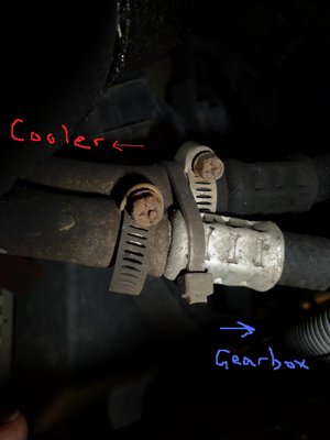

Apologies for the duff photography but this first one is the original connection/original pipes coming out of the box directly..no adaptions made as far as I know.
n falcon own work
n falcon own work
To fit the new cooler, I presume the 2 pipes running up to the radiator connections were detatched/cut and joined to the new cooler pipes. Cooler mounted at front just behind grill.

This makes things much clearer, rather than my dubious photography of the real thing :-D .
This diagram is from an Astra but you can see the pipes and how they connect to the box. Looks like the pipes are pretty easy to join up to the new cooler pipes preserving the "ends" at the end of the flexible hose bits.
