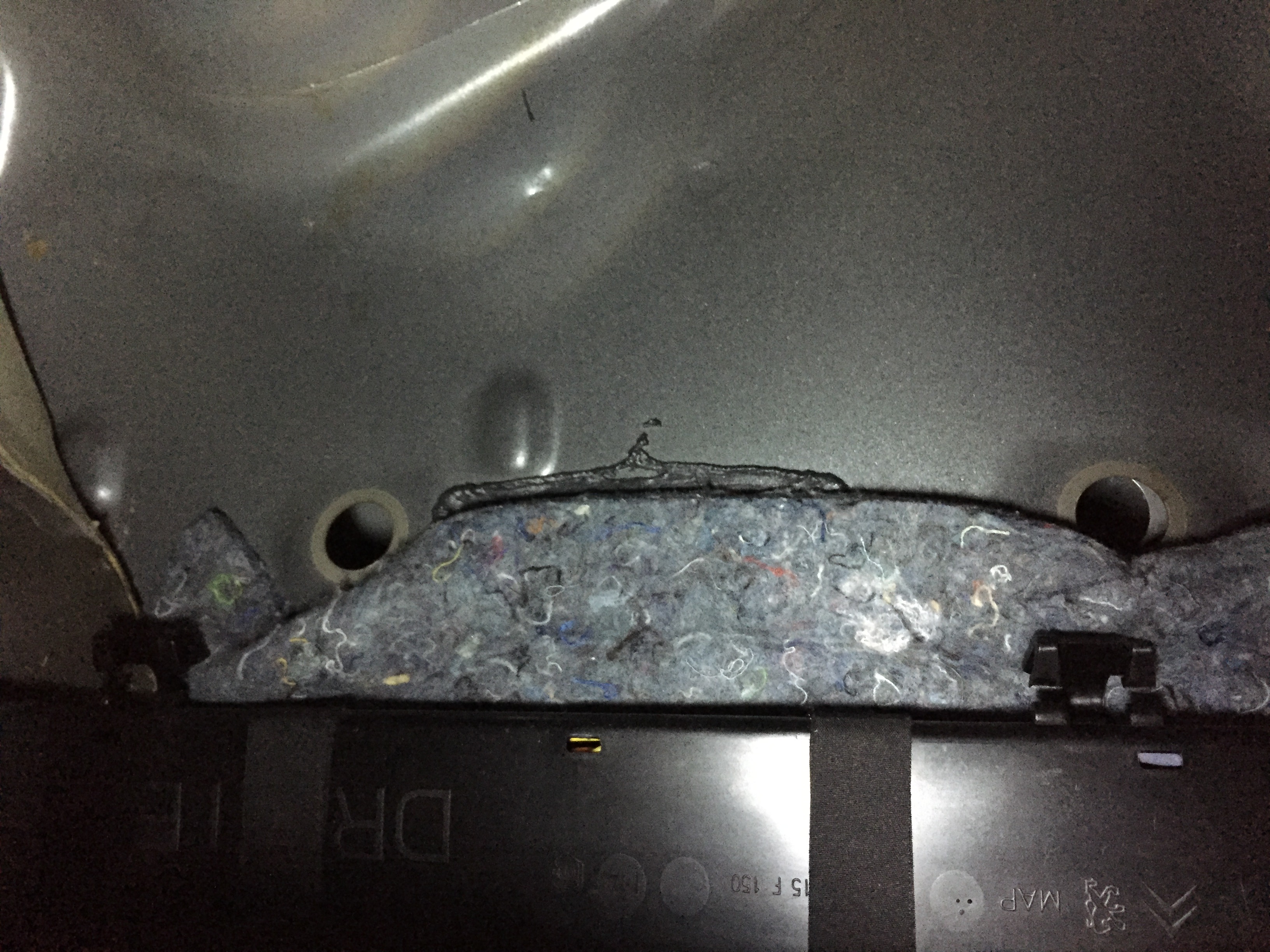

Some news from the battlefront:
I've found two holes with rubber covers in the passenger footwell, and they look like places for running a loom (probably on the rhd cars).
Does anyone believe this could be used?
Best regards,
AJ

Make sure to get a rubber grommet into one of those holes to protect the wiring as it passes through, otherwise you could have electrical issues later on.

My only problem right now is that both holes look like they don't have another hole in the inside.
I try to put the cable but it seems as there is no connection to the other side...
Should it be like this and I need to open an hole on the other side? Where should this holes run to?

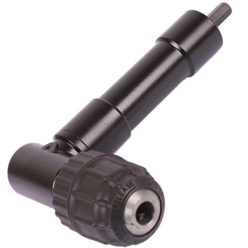

I think he just used drill with angle drive to drill that readymade hole all the way to the engine compartment. Other picture shows place where the hole is in the engine compartment. He made the hole for interior heater cable and that cable is armoured and visible in the center of the second picture.
ajorge
Posts: 20
Joined: 08 Oct 2016, 09:43
x 1
Re: Live feed from battery in C5 X7
Unread post by ajorge »
Thanks Xantippa.
Maybe my problem is the angle. I was trying to open the hole "straight ahead"
I'll look at it with an angle driver and with the car lifted.
Once again thanks for your kind help.
Best regards,
AJ
