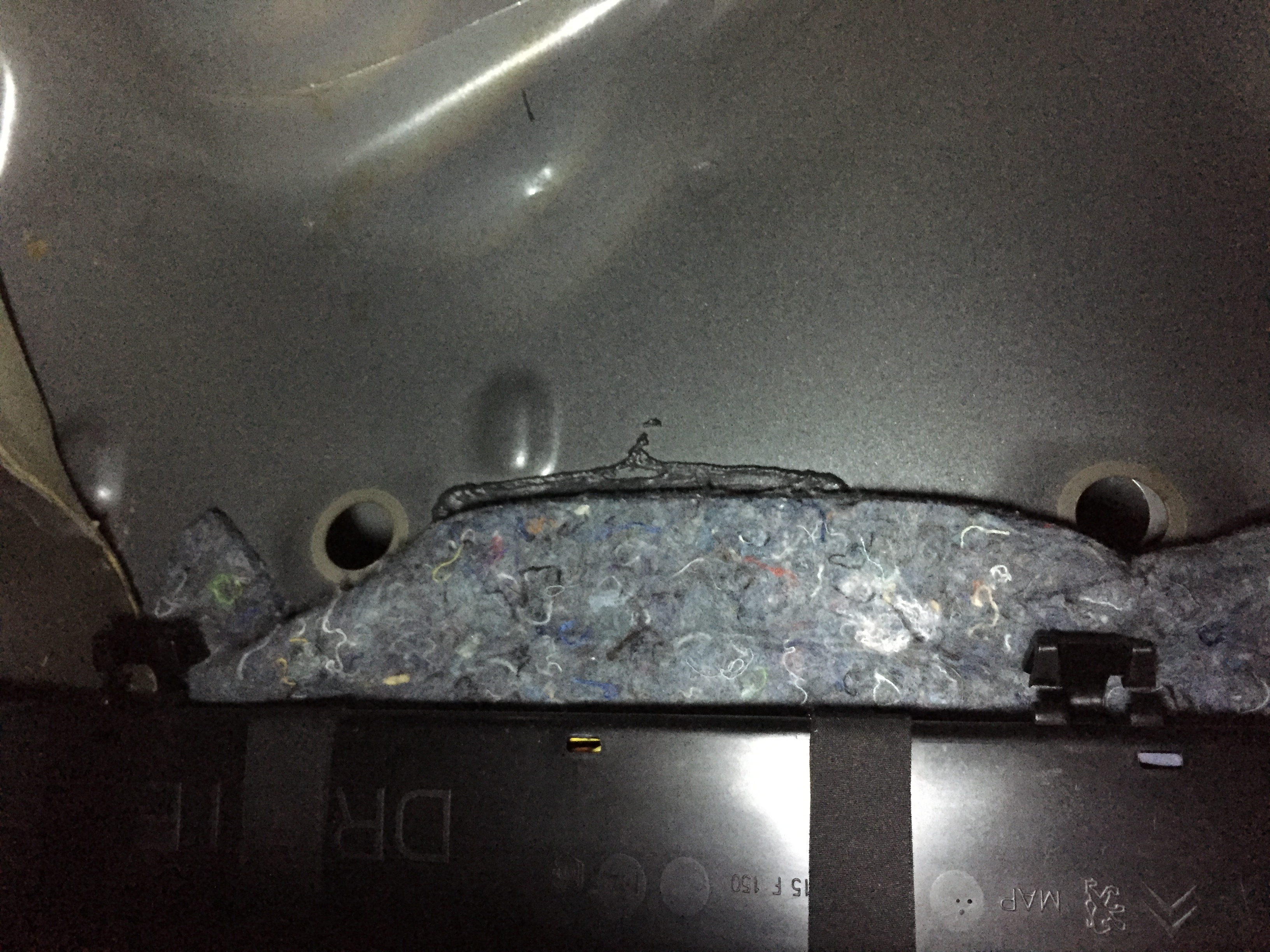

Some news from the battlefront:
I've found two holes with rubber covers in the passenger footwell, and they look like places for running a loom (probably on the rhd cars).
Does anyone believe this could be used?
Best regards,
AJ

Re: Live feed from battery in C5 X7
Post by Hell Razor5543 »
Make sure to get a rubber grommet into one of those holes to protect the wiring as it passes through, otherwise you could have electrical issues later on.

Post by ajorge »
My only problem right now is that both holes look like they don't have another hole in the inside.
I try to put the cable but it seems as there is no connection to the other side...
Should it be like this and I need to open an hole on the other side? Where should this holes run to?
