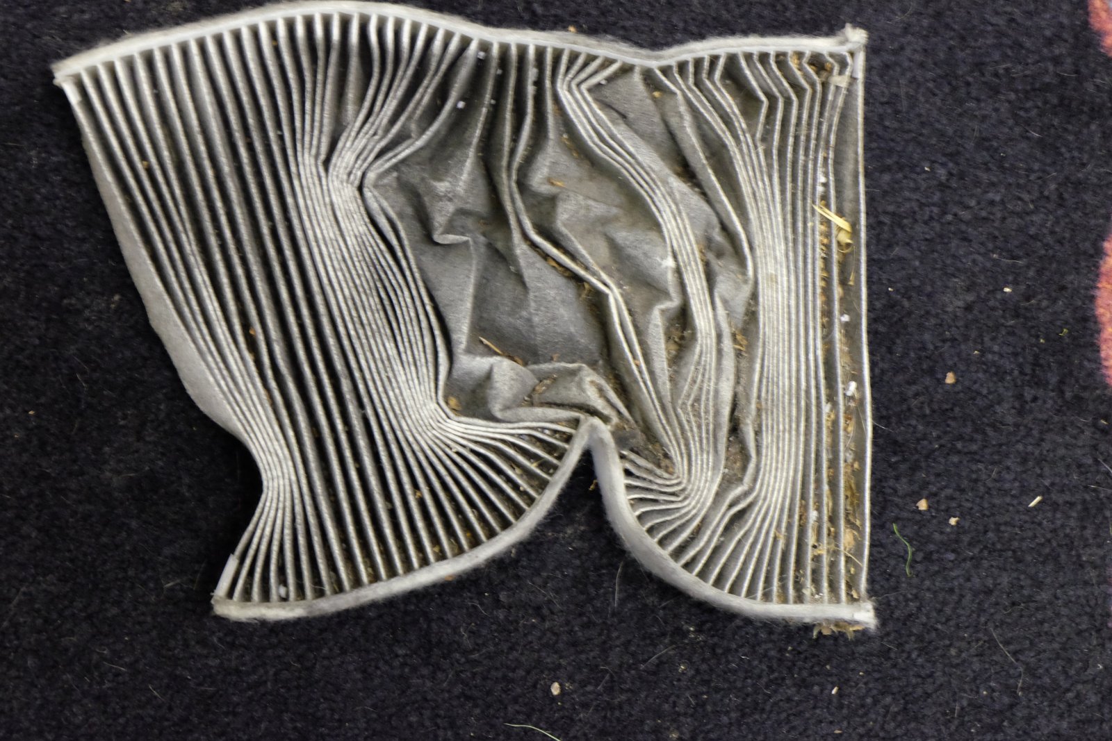

Phew! That's been an energetic morning. Thanks Marc for the write up regarding the pollen filter. I've just finished doing mine. First time on this car. Previously I've left it to the dealer to do. But I hope I've made a better job of it than the Citroen workshop did. This is how the old one came out.
I guess I'm at the bottom of the league table. The job took me 90 minutes..

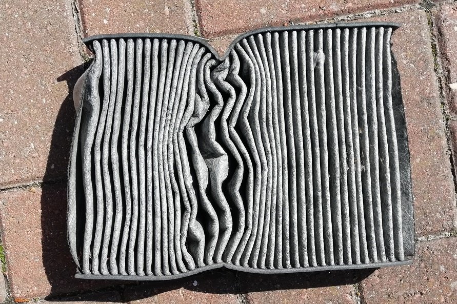

Decide I would replace my cabin/pollen filter today. Easily removed thaks to Marc's excellent guide. Somewhat disappointed with what came out! A busy day tomorrow with airline & vacuum cleaner. I will make a better job of fitting it than the last bloke!!!

Yep - when these go back in, you have to coax it in gently with a combination of manipulation at all the sides and the top / bottom whilst gently pushing it back, but without allowing it to bunch up in the middle, where you can't see it. Flat trim removal tools may help guide it in.
