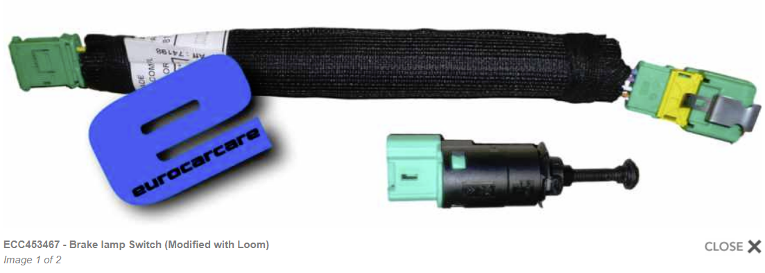

Re: Esp/asr system faulty on C5
There’s another one here that is complete with the loom
http://www.eurocarcare.net/switches-rel ... -loom.html
Or here
https://www.ebay.co.uk/itm/CITROEN-C2-C ... 1579819172
I gave you the part number in a previous post, so have a look around, but I really would avoid the really cheap ones.
I can't tell you why there are 2 types, but the part number is 453467.
One has to be manually set and the automatic one self adjusts once fitted. The part number above may also come with a modified loom - as can be seen from Euro Car Care:
I don't have the reason why the loom may be supplied and what this is for exactly - that may be a question for the dealer who may be able to answer it for you - as there could be a Technical Service Bulletin detailing the reason.
I thought it worth a mention before you embark on it yourself!
