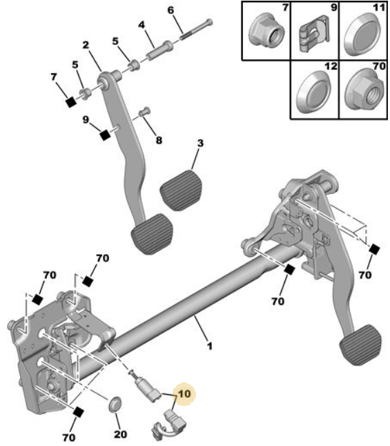

Hi Mikal
Here you go, item 10 in the diagram.
| Part No: 453467, price (UK) from Citroen: £38.03 inc. VAT |

So do you think If I took it out, gave it a filthy look, (cleaned it) and replaced it the "fault" I have might go or should I just get a new one.
