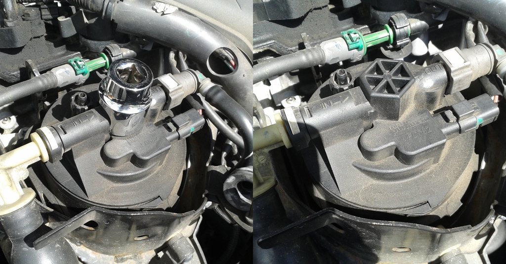

bobins wrote:If you're talking about having trouble removing the fuel filter, then some of the filters are best undone with a socket like this:
Laser tools part 5270 - other manufacturers are available.......
Are the cut-outs to clear fuel pipes? It doesn't specifically say so but I presume it's 27mm.
Yep, the cut-outs clear the fuel pipes to give a better fit over the 'nut' on the top of the filter, and yep - it's 27mm.
From what I understand though, this isn't a universal socket for all diesel filters !! It'll only fit the ones that it is designed to fit :)

The Xsara fuel filter has a plastic hexagon on top but it's considerably smaller than 27mm. The 2003 C5 has no hexagon and the 2013 C5 X7 seems to have no fuel filter that I can see! The oil filter on the X7 has a hex on the top and may be 27mm but there's so much stuff on top that there's no room for a ratchet or extension to go in.

C5 x7 163 has a tricky plastic oil filter with a 27.. not much room paul as you say..

bobins wrote:
this is probably the best tool. just need to make sure it is compatible with x7
Here's the socket fitted to my fuel filter top from about 5 minutes ago :)
The top of the housing is marked as Purflux FC582

Re: Tool to remove oil/fuel filter
Unread post by osx »
Done it this morning with the special socket. Did think of sucking some diesel out first to make it tidier next time - can you use that small valve just left to the socket?
Unread post by dnsey »
I open the water drain valve, so the fuel drains into a container as soon as air can enter the housing.
I think you can open the water drain valve at any time and possibly? pump the water out?
Yes, you can pump the water out, but only by pumping fuel in.
