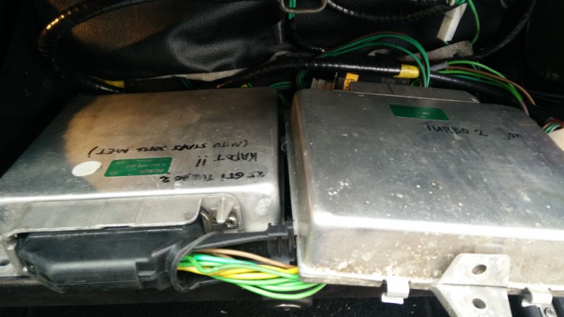

Well it started my ECU died without any reason.
battery was a bit weak seems ECU works only above 11.5V?
Few things I did before changing ECU.
Cleaning all the contacts blue relay and the main plugs.
All OK
Replaced the spark plugs just in case.
Checked for spark - OK .
Cleaned my injectors - OK
Checked fuel pressure - OK because, the fuel pump and filter is replaced two years ago.

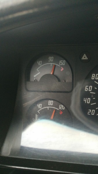

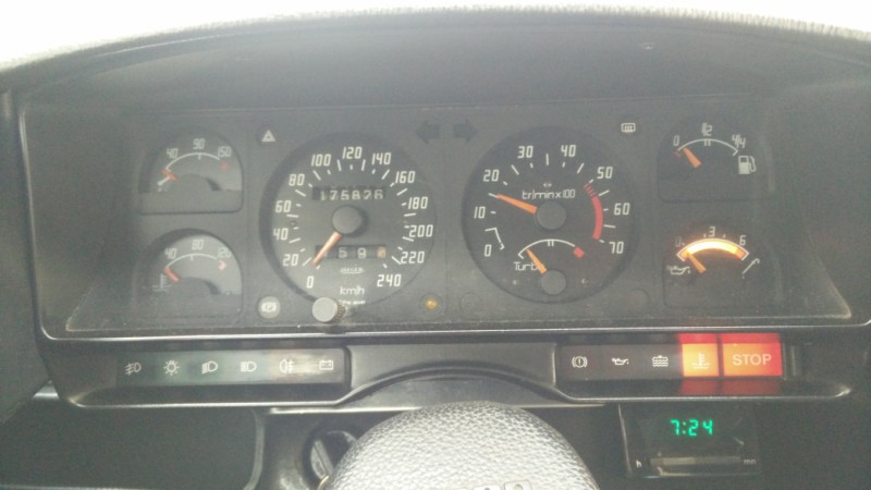

Like those shots of the dash. Almost identical "under the skin" to later BX, which of course it overlapped with.
XM is the same - ECUs do not like depressed battery voltage.
