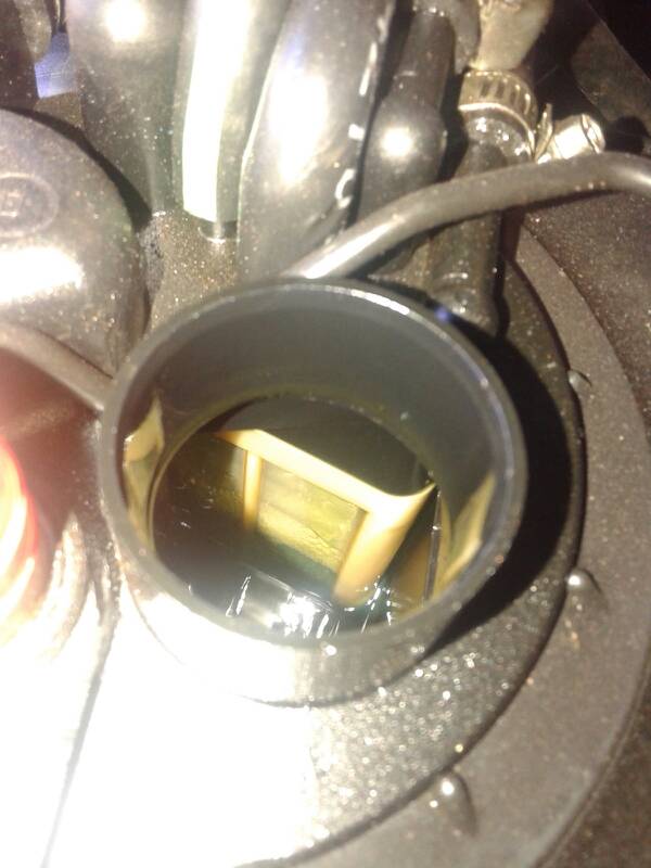

Also I noticed froth in the filter of the LHM tank when presing the brake pedal. Is this normal.
