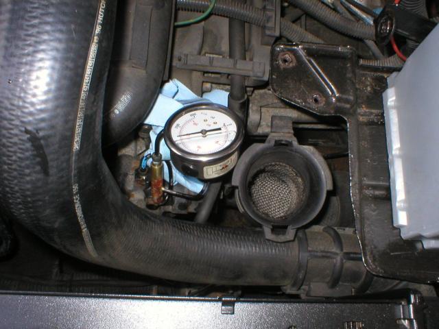

You need to tee in a pressure gauge between the regulator output and the security valve and then see how quickly the pressure decays whe the pump is nopt running... A good system should hold pressure for several minutes...Chetiya Dias wrote:How to check for internal leaks of the pump and regulator Jim
If you see the pressure fall immediately then you know you have an internal leak.
This is a gauge I made up to do exactly that on an Activa...
