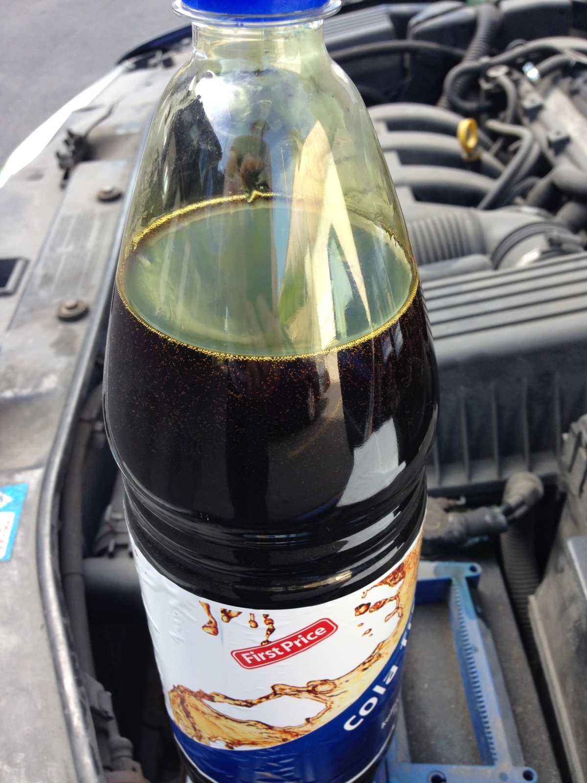

skog77
- Posts: 63
- Joined: 29 Dec 2009, 01:46
Re: My LHM is ORANGE o_O
It's weird. Spread thin it has that greenish LHM tint. Bit thicker and its mustard. Bit thicker than that, and it's red-ish Coca Cola.Mandrake wrote:Are you sure its not mustard ?
I'm not going to drink it though.

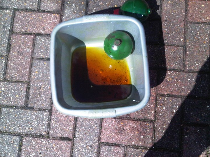

Northern_Mike
Here's some old LHM I took out of my Activa, complete with bits (!)
I'd not worry too much about yours to be honest.

Northern_Mike
It actually had a consistency of a bad pint of bitter when it came out! I guess then the car was 12 years old and had 95k on the clock and it had never been changed.
