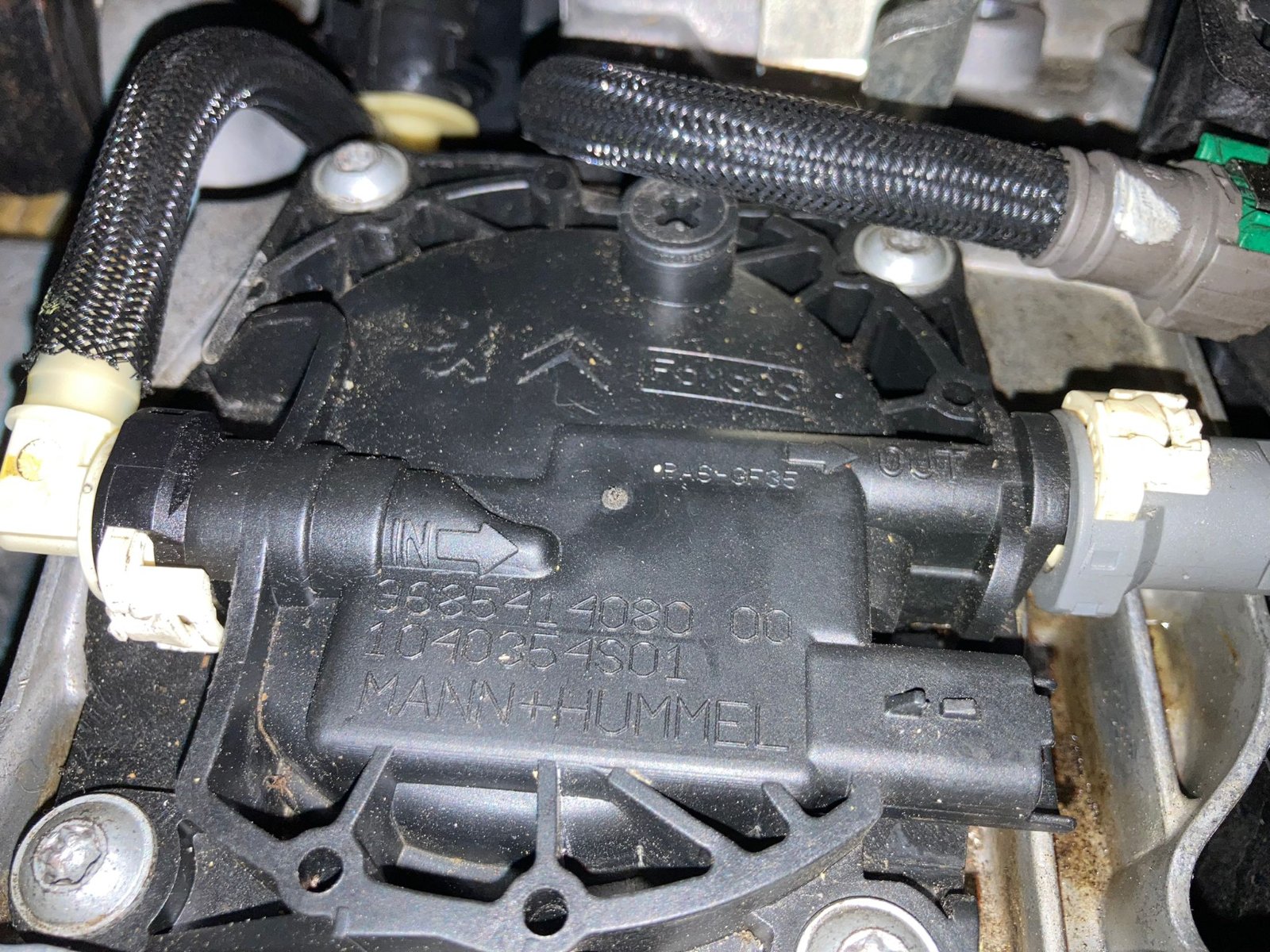

Looking at this thread , searching for others and videos on youtube I cannot figure out how to get off those hoses without breaking the clips.
I'm aware that my filter housing is quite different but if anyone can help I'd appreciate it - thanks!

The clips usually push into the connectors, which (because of the internal design) release the latch that holds it in place.

Re: 2.0 hdi changing the fuel filter
tried pushing down by hand - here's hopefully a better pic - there's a triangular plastic but in the middle. The filter housing is by Mann + Hummel if that's any help.

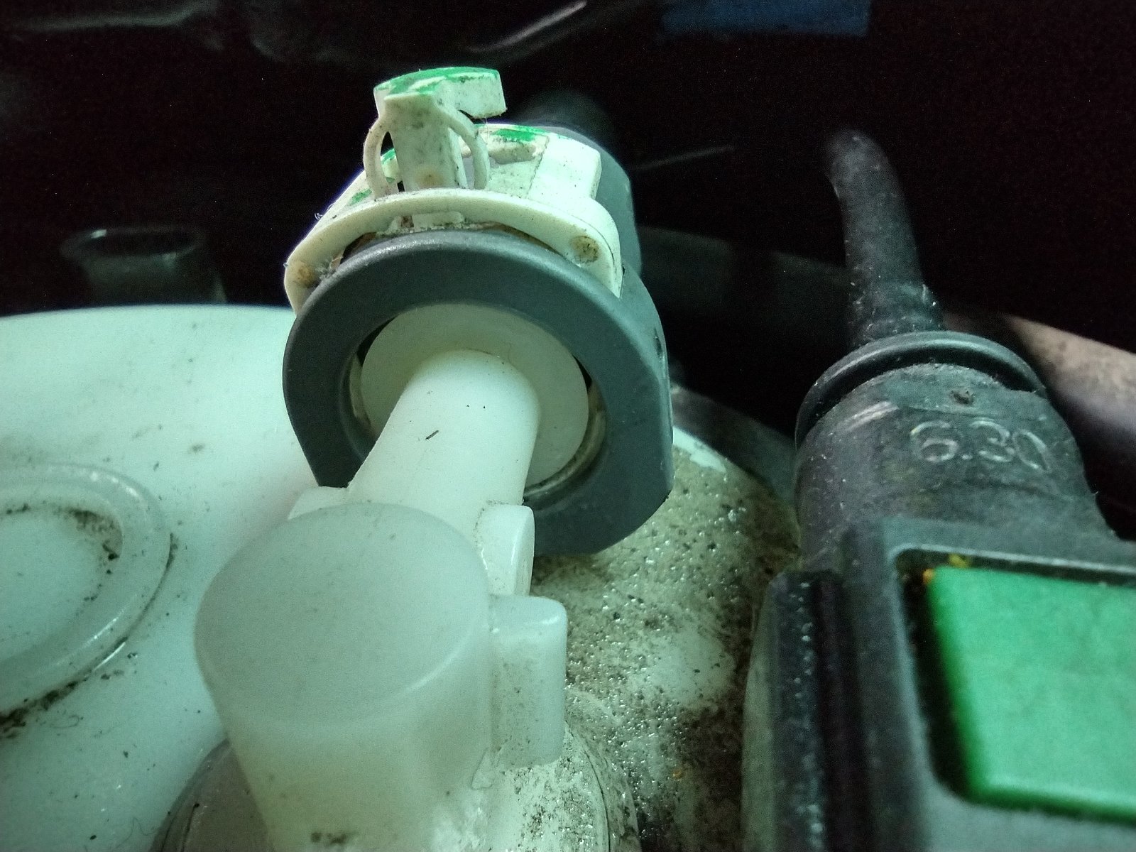

Ok this guy shows how to do it - I need to hook the middle UP and simultaneously push DOWN to release (!?!).

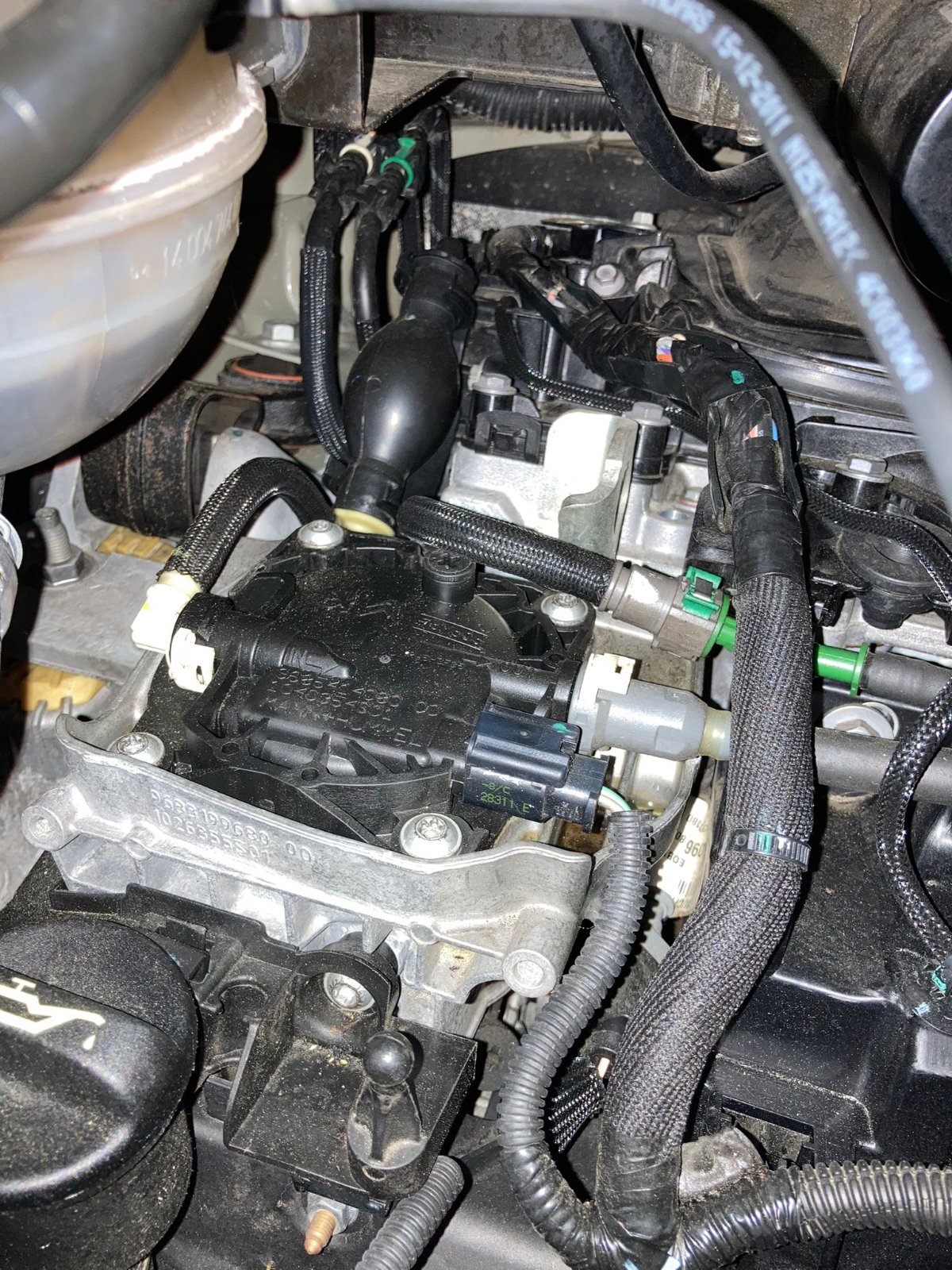

So one final question - the bleed screw at the top there - what is the correct procedure in order to remove any air ? Is it :
Unscrew the bleed screw slightly or completely
Use the hand pump to feed fuel back into the system until it expels any air from the top (i.e. diesel comes out the top) ?
Thx

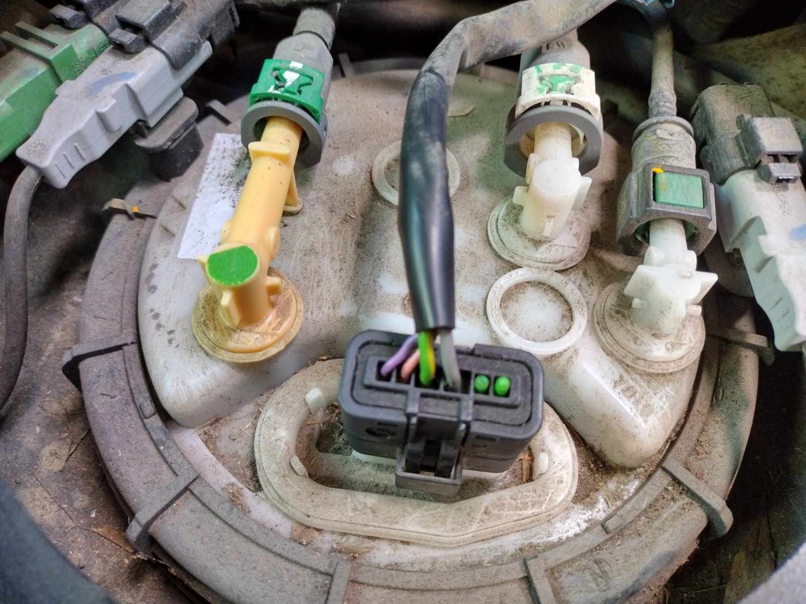

If it's like these on top of the fuel pickup, then the centre triangular tab pulls up and clicks into place. Like so:
Then you only have to push down the outer bits. Still awkward!

Thanks a lot Matt - yup I bought some hook tools to pull those things out without damaging them.
About the other question could you please share your view/expertise ? :
The black plastic bleed screw at the top there (see my pic) - what is the correct procedure in order to remove any air ? Is it :
1) Unscrew the bleed screw slightly or completely
2) Use the hand pump to feed fuel back into the system until it expels any air from the top (i.e. diesel comes out the top) ?

Sorry I am not best placed to help you there - I've only experience of 1.6 DV6 and my 2.2 DW12 HDi engines - both of which have fuel filters which are a sealed unit, pipe connections on top, so haven't had the joys of the battles described above.
Actually, scrub all that I was getting mixed up with the other pictures above! I've just realised you're asking me about a similar looking sealed unit. On the 2.2 the screw at the top is actually the drain screw - unscrewing it uncovers a hole in the bottom allowing water settled at the bottom to be drained off. I don't think it has any air bleeding function. Also it's retained so doesn't remove completely.

Looking at your pictures again. Your bleed screw looks a little different to the 2.2 so I may be giving you poor advice there.parnell wrote: 29 Jul 2022, 15:34 Managed to get the left one off - but the right one wouldnt move at all - hope I haven't damaged it
Hose connections look to be a male and female of the same thing. In any case they are awkward sods, just keep rotating, twisting and pulling by hand, it should let go. It is possible to prise but I am nervous given all is fairly brittle plastic.
