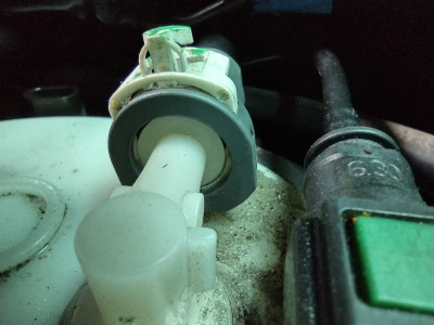

Re: 2.0 hdi changing the fuel filter
Looking at this thread , searching for others and videos on youtube I cannot figure out how to get off those hoses without breaking the clips.
I'm aware that my filter housing is quite different but if anyone can help I'd appreciate it - thanks!
- Posts: 14314
- x 3296
The clips usually push into the connectors, which (because of the internal design) release the latch that holds it in place.
tried pushing down by hand - here's hopefully a better pic - there's a triangular plastic but in the middle. The filter housing is by Mann + Hummel if that's any help.
If it's like these on top of the fuel pickup, then the centre triangular tab pulls up and clicks into place. Like so:
Then you only have to push down the outer bits. Still awkward!
Thanks a lot Matt - yup I bought some hook tools to pull those things out without damaging them.
Managed to get the left one off - but the right one wouldnt move at all - hope I haven't damaged it
Looking at your pictures again. Your bleed screw looks a little different to the 2.2 so I may be giving you poor advice there.parnell wrote: 29 Jul 2022, 15:34 Managed to get the left one off - but the right one wouldnt move at all - hope I haven't damaged it
Hose connections look to be a male and female of the same thing. In any case they are awkward sods, just keep rotating, twisting and pulling by hand, it should let go. It is possible to prise but I am nervous given all is fairly brittle plastic.
