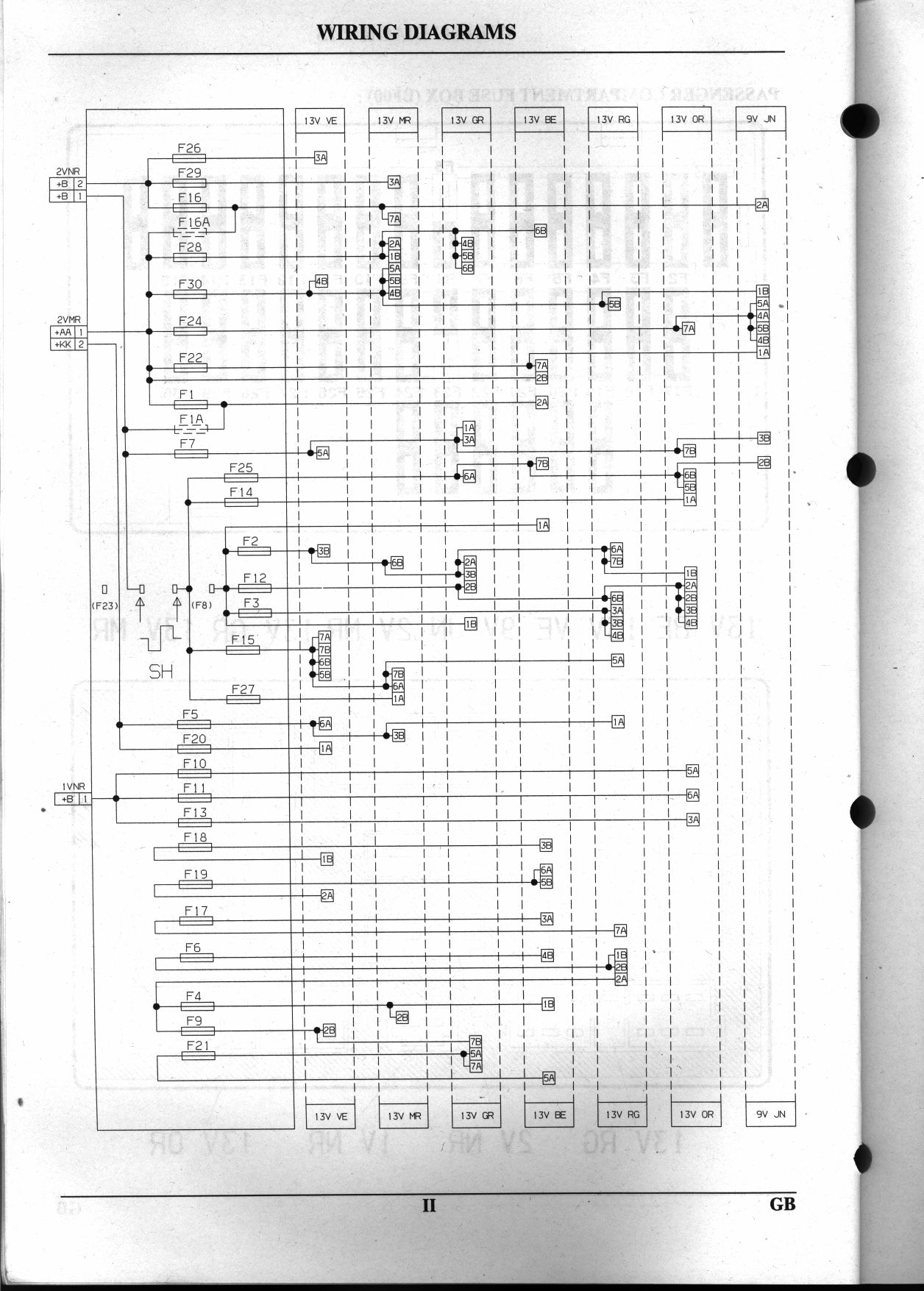

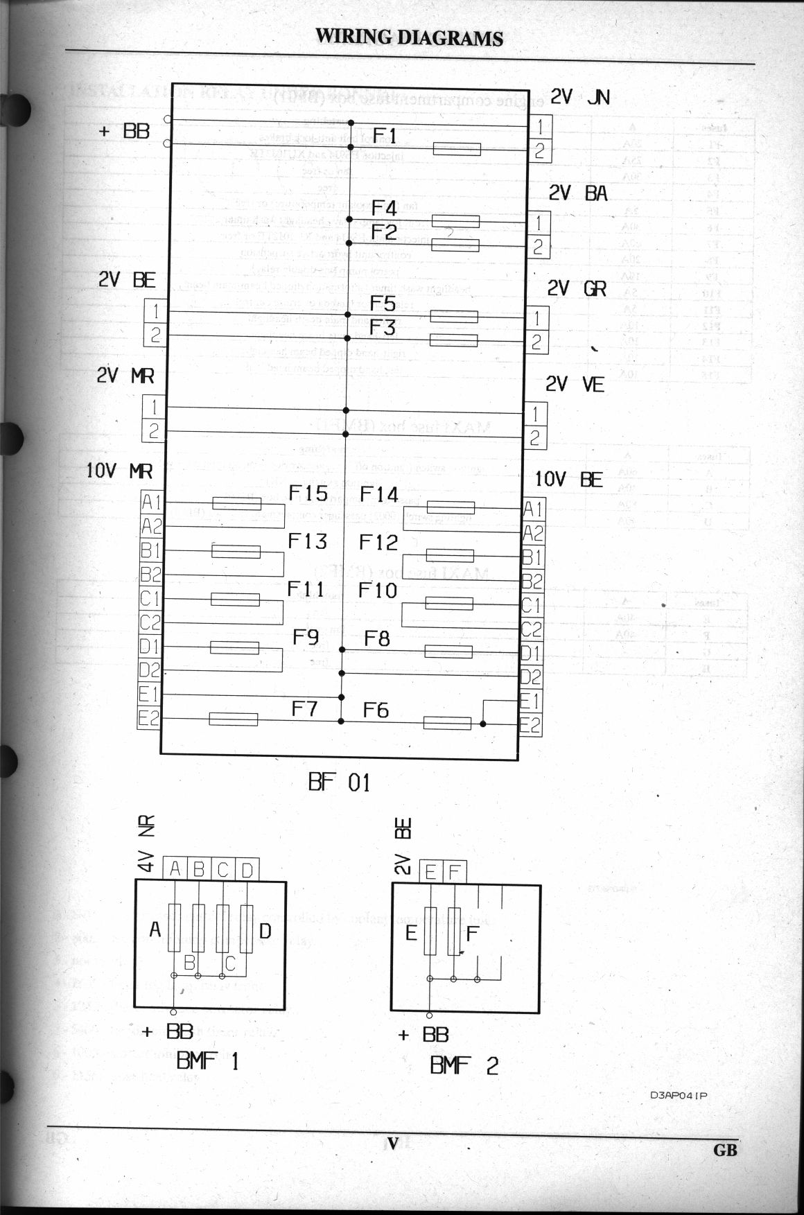

Mike,
Fuse Box Diagrams :)
Engine Bay Physical
Engine Bay Schematic
Engine Bay Fuse List
Cabin Box Physical
Cabin Box Schematic
Cabin Box Fuse List
Scanner is ever-ready for the next lot of diagrams you may need Mike :wink: :)

+BB means it is fed direct from the battery Mike...
