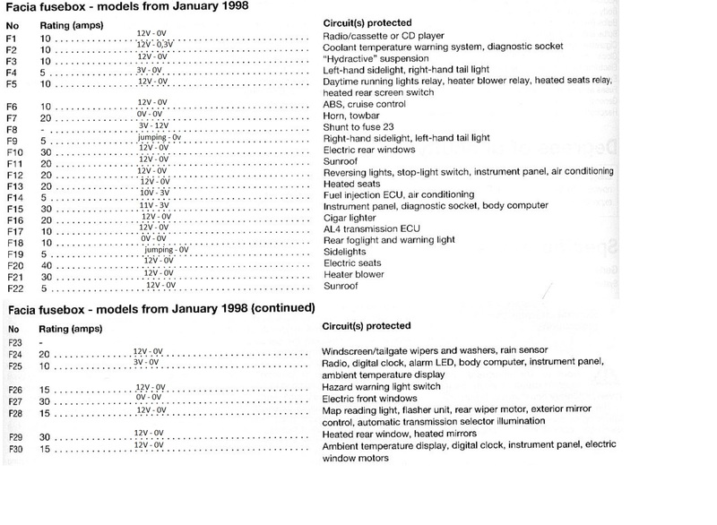

This is how I aproached the problem...
I meassured every pin in the cabin fusebox (ignition on). One cable from multimeter to fuse pin an the other to ground. Mark value. Change pin (the same fuse), mark value. You should get 0,0 or 0,12 from each pin. If you get something else (in my case I believe it was somethin like 0,3 or 12,3) that's your problem. Then I traced from the wiring diagrams which cable feeds the pin in question. And it was one (the same) cable responsible for the three pins that were showing odd figures. Luckily evers cable has a unique mark so I just found the right one and managed to trace the corroded part. Corroded part meaning where two parts of the cable are put together and soldered (not connector like to relays or ecu).
Sorry for my bad english explanation, but it's not my native language...

Mike, that fusebox is a well-known probelm that can cause exactly the fault(s) you have... Swap it and it's possible all your fun will go away... Generally, most fuses will be alive but some won't be...
I do have the fusebox layouts and diagrams you need but not up on my webserver. I'll need to scan them. I may be short of tine this evening but I will try to get it done as soon as I can...

Here are my readings:
I just went through the wiring diagrams and found out which wire is sending electricity (+) to fuses. Came to a conclusion that only one wire is responsible for all those fuses that readings were incorrect. My thinking is that it's highly possible you have a similar problem especialy when your car was sitting quite for a while...

Re: Activa no2 help needed
Just a thought.. I remember that a friend of mine who is a car electritian "bricked" (+) to fuse 25 (body computer) from a fuse that had correct voltage (12,0). Used a piece of cable and wired it from fuse to fuse. It's recommended to wire another fuse in the middle of the cable just to be sure you don't burn something! It was just s temporary solution so that I could use the car as I need it daily.
Had a quick look through the wiring and if I remember right it was cable BMF1 or BMF4B, one of the thicker red (pinkish) one. Try to identify the marks...
