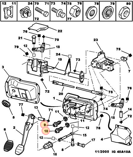

Hi
Here's the Brake Switch and also the Clutch Switch (which is no longer available from Peugeot) but I included it just in case.
(9) Brake Lamp Switch, part: 453451, £20.90
(10) Cruise Control Switch Regulator, part: 16287P (no longer available from Peugeot), £19.06

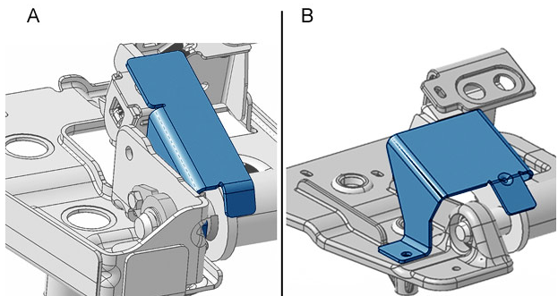

However, although I don't have the specifics for this vehicle, I know there have been similar issues with other PSA vehicles where there can be random braking. This has been down to braking caused by the passenger pressing on the pedal bracket lever (on right hand drive vehicles).
On the C5 MK II as shown above, the intervention was to fit either A or B (pedal bracket lever protector) according to the version fitted as seen above.
As I said I don't have the specifics for the 406 but I expect it to be a similar intervention. So my advice would be to contact your dealer and tell them there is a Technical Service Bulletin under the 'Pedal Bracket' section of 'ServiceBox that is titled: "Flat spot on acceleration/hesitation/lack of power/unwanted operation of the brake lights",
They may be able to advise if there was a modification or advise you further.

Thank you so much for this -- I'll track down and order that part today. I'm glad that there is awareness of this issue out there! It took me a good while to realise it was connected to the brake lights.GiveMeABreak wrote: 07 Jun 2023, 11:46 Hi
My problem manifests itself regardless of anybody in the passenger seat (most of the time it's just me anyway!). Lifting the brake pedal up has cured it on a number of occasions (before I need to press the pedal again) so I'm convinced it's in the pedal switch. I'll mention the service bulletin to the local dealer though in case they can recall it.
