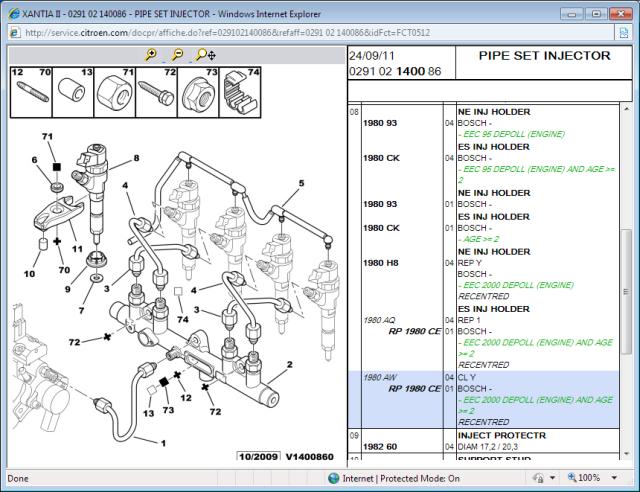

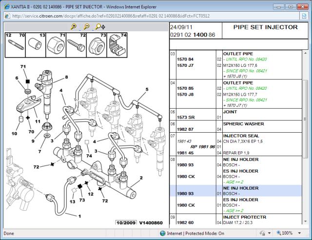

Kenny, here's a diagram of the injectors showing the seal at Item 7...
What to? 'Breakfast at Kenny's'?Xantidote wrote: Enjoying the humour, but perhaps the post's title needs changing to suit??

Jim got the picture, £8 from dealers for 4 seals.

Kenny, the injector is Item 8 in the picture above. Only problem is I'm not sure what they mean by NE and ES Injectors and what the difference is. Not sure what they mean by Age =>2 either
Now they're the part numbers for 110 HDi injectors...
I'll go check if they are different for the 90...

Looks like the 90 engines shares the same injectors but has others too...
This from the bay of fleas. Gives a Bosch-like part number...
The Bosch part Number 9640088780 seems about correct after a few more searches....
