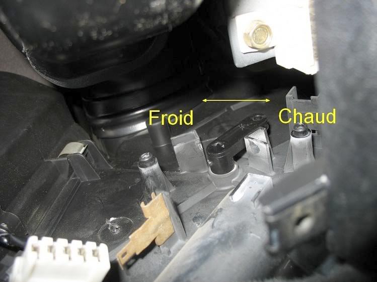

You'll have more fun with the heater flap thing. Have you discovered the "manual" control flap under the dash? It flips through 90%. Pointing forwards gives you hot air, pointing to the drivers side gives you cold air. The fault with the temperature control is that the stepper motor is lying on the floor under the dash somewhere and is U/S. I never bothered with it as you know. I set it to blow hot in winter, and cold in summer, though with the recent odd weather, I've actually got quite adept at moving that flap while driving, though I recall I am a little taller than you and probably have longer, if not as nimble arms..

It's well hidden MikeActiva_Mike wrote: You'll have more fun with the heater flap thing. Have you discovered the "manual" control flap under the dash?

Found the lever now following a natter on FB with Mike and searching this fair forum for a Clogzz post and this picture:
Thanks Mike and Clogzz
I never knew you could get your hand that far up the heater box!!!!
The phpBB search function works a lot better as well
