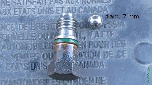

Ref wrote:... what if it's not there i don't think they stock a ball and a spring :roll:
I hope you'll find it but in case you don't you have to look for a 7 mm diameter bearing ball.
Edit: There is no spring behind it. Check PM for shop advice.
Form a scrap yard they'll most probably sell you the complete regulator set :(
No worries if you don't find, I can buy it here and post it to you :wink:

Try a bicycle shop if you don't find it. You may need to buy a pack with a couple of dozen. I doubt if it needs to be stainless. If the correct size is 7mm, then quarter inch might be worth a try.

... and it looks like this.

Seriously the kind of help i get here is beyond words, VertaVega sent my the 7mm bearing ball with a diagram in a nice looking envelope :) now this's really something, i'm very grateful to all of you and to VV for the class A Offline help :)
on the other hand the car running great after new LHM and clean filters the ride is silky smooth :D and the steering seems to be alright no issues so far.

... Image
