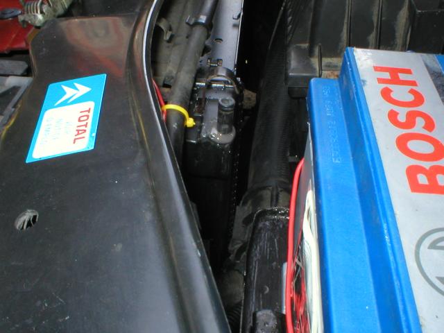

I've done a repair. I turned up a brass sleeve that would fit tightly into the spigot and the hole remaining in the rad. I opened the spigot and rad holes out to 5.5mm; there was about 2mm of hole depth in the rad before it opened out into the end tank. I bored the sleeve to 4.5mm so that water flow would not be adversely affected...
Once that was done, the sleeve was coated in Plastic Padding SuperSteel and gently pressed home. A coat of SuperSteel was applied around the spigot and the rad base to hopefully give a little more support.
Here's what the finished job looks like:
I just have to patiently wait a couple of hours now for the epoxy to set hard...
Fingers crossed...

Looks like I may have saved my rad :D Reassembled and ran her up to temperature until the fans cut in and so far, touch wood...
