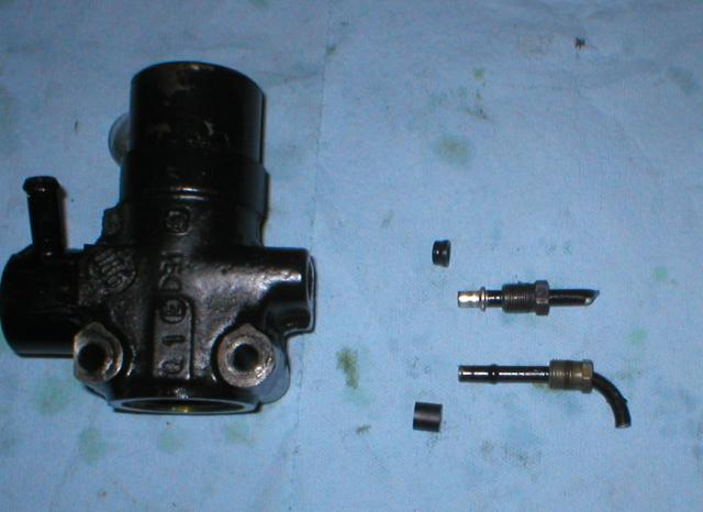

Dave,
This may help. This photo shows a pressure regulator with a metal seal and flare at the top and a rubber seal and flare at the bottom showing the slight difference between the two...
The metallic seal is shown in the correct way it should go in. The shorter flare used by the metallic seal can be used with a rubber seal but the seal must be shortened a tad so that a short length of pipe pokes out of the end of it.
I'd pull the pipe right out and dig in to the pressure regulator bore and see if you can find a seal. A mirror on a stick and a pair of tweezers will help.
I'm concerned you may have a metal seal and it's upside down or you have an over-length rubber seal in there and a metal seal both at the same time. Both scenarios will cause the union not to bed down and make it potentially susceptible to undoing itself.
Also, have you checked the tick rate and more critically, can you feel any vibration on the regulator body that may account for it.
Finally, are all the "P" clips correctly in place along the whole run of pipe from the pump to the regulator. These are INCREDIBLY important and if any are missing it might give rise to the problem. There should be four - two along the run of pipe above the exhaust manifold, one on the side of the engine and another on the run of pipe where it runs across the top of the regulator and down to its union.
As the pipe is mounted on the engine all the way, a bad mount should not cause the problem.
