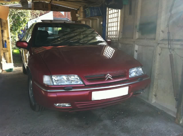

Looks nice, not my favorite colour though..

Sorry for the poor quality pictures, but just been down the garage to take them.....
Also took a short movie, and the engine did not appear to move at all :?
