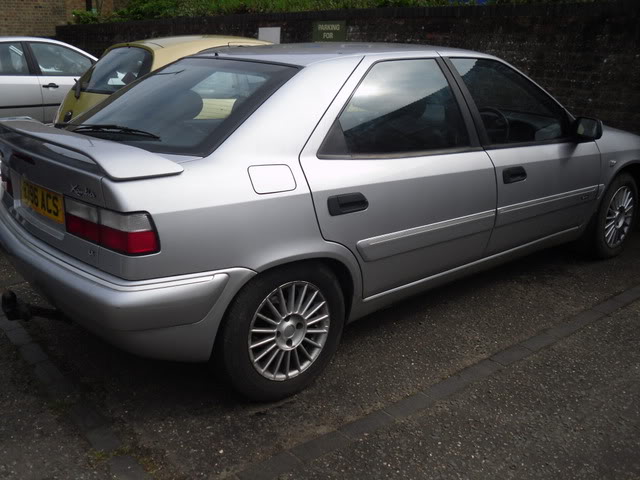

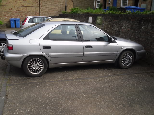

Today I got round to fitting the rear spoiler
. I am rather pleased with the result! Couldnt resist taking a couple of pics.
Now it just needs a damn good clean!

Thanks!
Well they say the camera never lies, but in this case it does! (although i did clean all the veg oil stains off near the fuel cap for the pics!)
The alloys came with the car, i think they are rather tasteful too!
