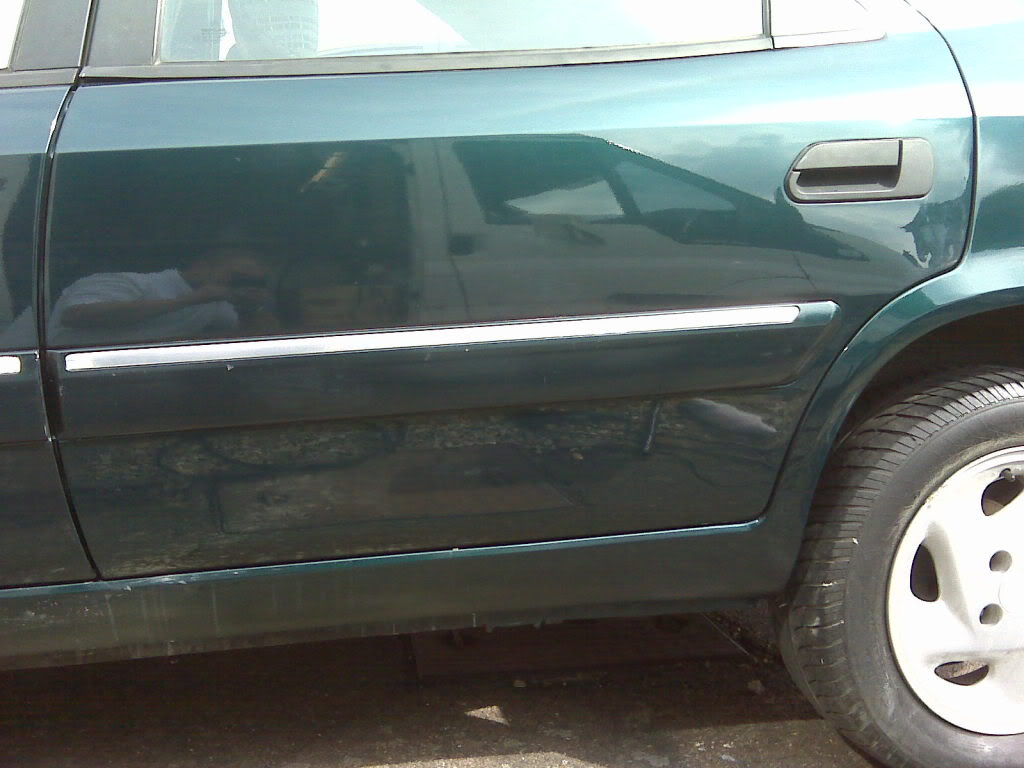

Right, here goes!
Door before, during and after shots + wheel arch.
I'm very happy with the end result, its pleasing to get hold of something that needs a little bit of love, and then onto a new home to be looked after further.

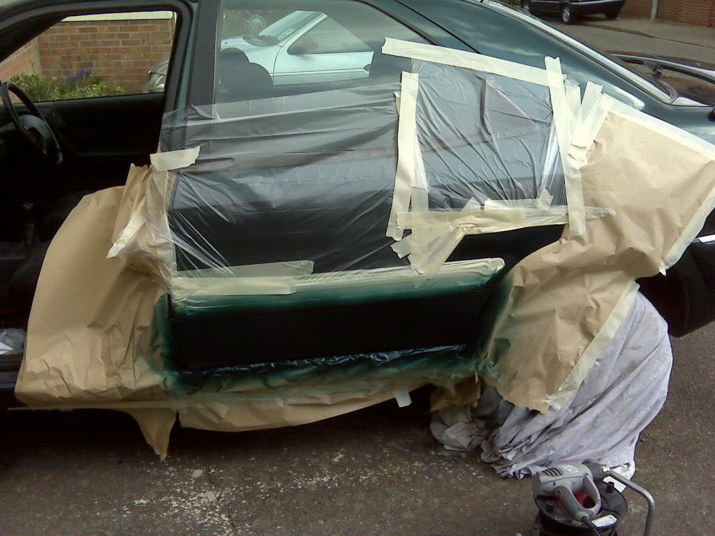

The work could be done in about 4 hours. Arch and door had to be painted seperatly as I had to blow it into the shut.
I actually did the work in stages. Last wednesday I ground it all back and applied the rust treatment, gave it two coats, it was then left for 2 days and by this time the rust had turned black.
Couple of days ago I primed it and then added a couple of skims of filler to cover deep pitting, sanded and primed again to shape and then this morning it was all painted up, only took 2 hours to do this.
The paintwork has a lovely deep shine to it, it mopped up far easier than my own car! Great colour in the sun.
