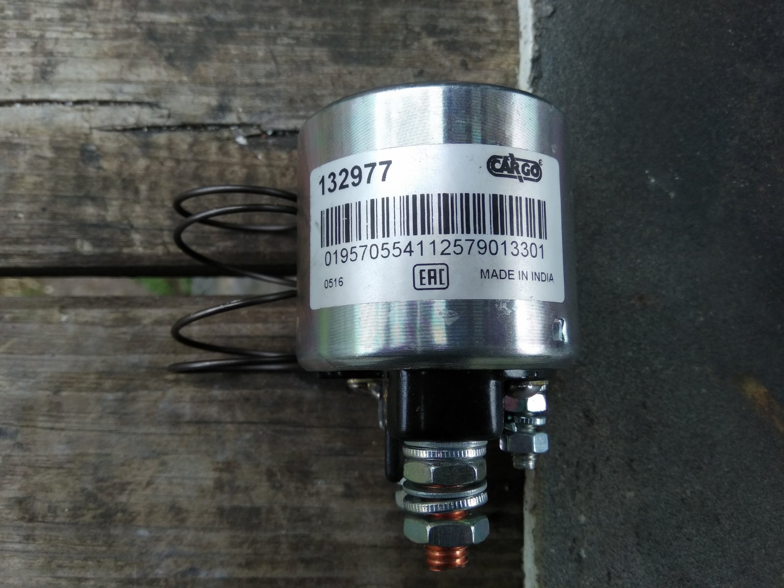

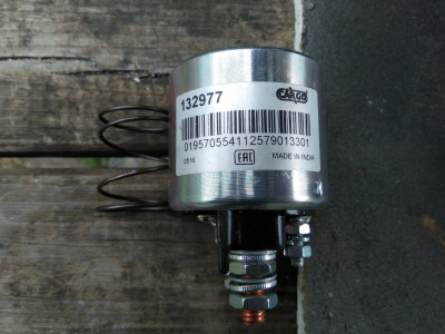

For the sake of 15-20 quid I'd change the starter solenoid. Not sure whats on yours but on my 2.0 136 Hdi is one of these.
I changed mine because it started popping the fuse when warm due to gunge. Damn sight cheaper than a starter.
Pete
moizeau
Posts: 1865
Joined: 12 Jan 2015, 16:08
x 429
Re: C5 X7 no start (or only runs for fraction of a second)
Post by moizeau »
Looking at that now, I may have posted my S111 Landy one...........
Pete

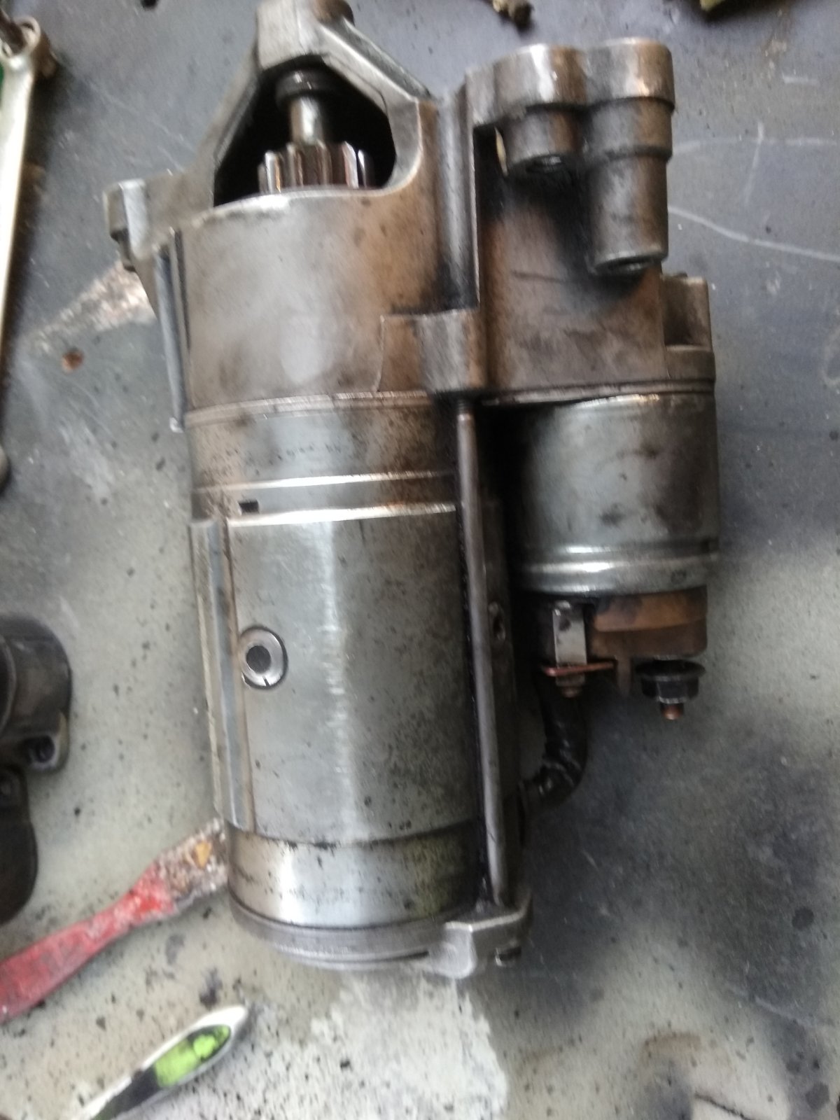

Started fine twice today, so faffing about at Barton Grange garden centre car park fortunately avoided. Wasn't even raining so car decided not worth playing up.
Quick use of camera phone in macro video + torch mode since got home had revealed the following numbers from the current starter:
96 562 627 80-03
M000T20871ZE
B8 12
12v Mitsubishi Czech
From this, so far I have learnt that many second hand car parts breakers are also able to read these labels and not much else yet! Was hoping to confirm power rating or anything else of note.
If someone has a good source / link for a mitsubishi catalogue / lookup table, then yes please!
(Side note: Wondering if "B8 12" is a batch number, and made 2012? Hence not original fitment)
