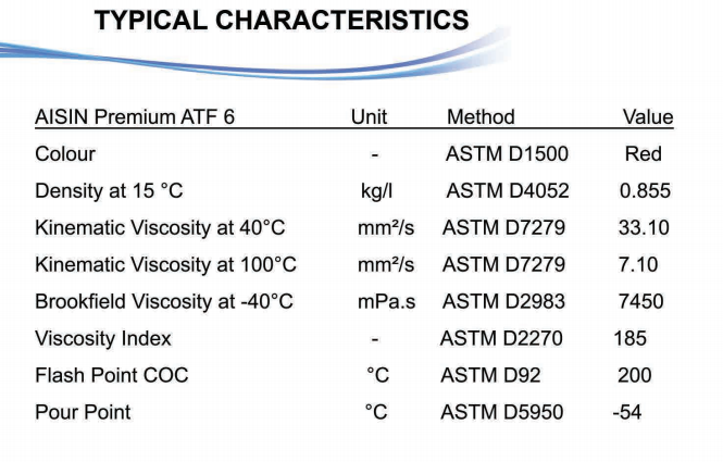

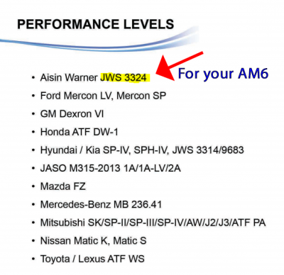

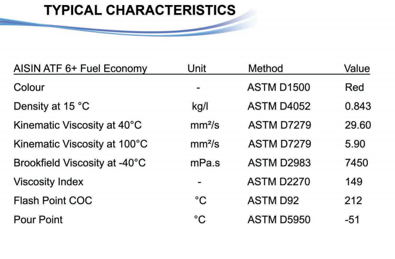

Re: Aisin Tf-80 / AM6 Oil Change Questions (Mini-Guide Page 4)
Ok, so you have a Euro 5 standard car, so your officially recommended oil is JWS 3324 or equivalent.
Now, to go back to your original question about the Aisin Oils. The difference is the type of formulation. The later ATF 6+ FE (Fuel Economy) is designed for the later AM6 gearboxes that includes the one fitted on your 508. As you can see, the JWS 3324 oil is specifically designated on the ATF 6+ FE data sheet, so is designed to compliment the later AM6 boxes.
I've put the main characteristics below too, so you can see the differences:
So if you want to use Aisin oil, then make sure it meets the JWS 3324 standard as shown.
| Characteristics | Characteristics |
| AISIN Premium ATF 6 | AISIN ATF 6+ Fuel Economy |

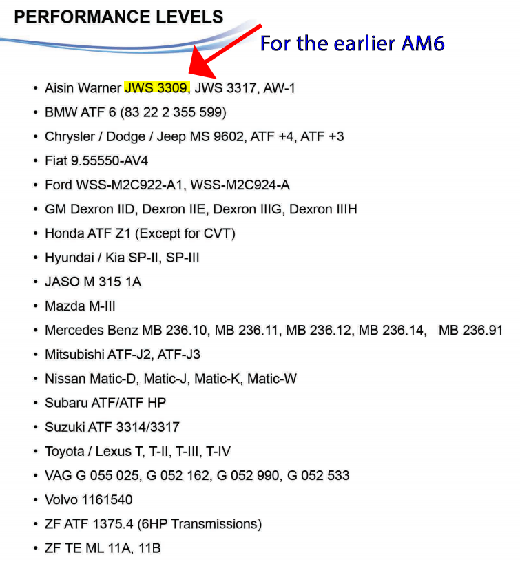

One more question.
The previous owner changed the oil by flushing the transmission, and inside is now the Mobil JWS3309.
Would anything hurt the gearbox if I make 4-5 partial exchanges with Aisin 6+ oil?
Thanks
So the previous owner has used the wrong oil.
As you can only partially drain the torque converter, you can never fully flush all the oil out. So often it takes about 3 flushes to get it as near as you can to a full change. If you do a lot of mileage, then you could do 3 changes over a shorter period, but if used only occasionally, then I would wait a few months in between doing the 3 changes. It will take some use to get the new oil circulating and mixing with the remaining old oil so that you get more of the old oil out each time you do the change.
Don't forget you'll need Diagbox to reset the Oil Counter on the Gearbox ECU after each change - or certainly after the last oil change at least.
I would suggest that given the expense of the premium oil, that you maybe use a cheaper (that still meets the specifications) for doing the first couple of flushes and then keep the expensive oil for the last change.
