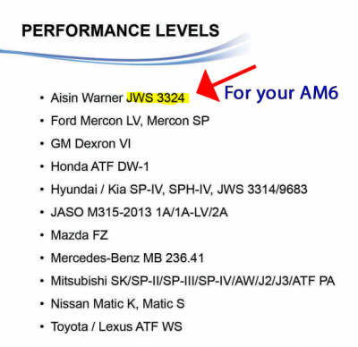

Ok, so you have a Euro 5 standard car, so your officially recommended oil is JWS 3324 or equivalent.
Now, to go back to your original question about the Aisin Oils. The difference is the type of formulation. The later ATF 6+ FE (Fuel Economy) is designed for the later AM6 gearboxes that includes the one fitted on your 508. As you can see, the JWS 3324 oil is specifically designated on the ATF 6+ FE data sheet, so is designed to compliment the later AM6 boxes.
I've put the main characteristics below too, so you can see the differences:
Characteristics
Characteristics
AISIN Premium ATF 6AISIN ATF 6+ Fuel Economy
So if you want to use Aisin oil, then make sure it meets the JWS 3324 standard as shown.
