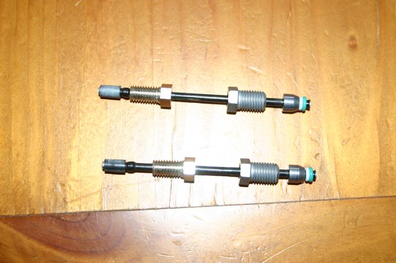

Just to finish off this thread...
I thought some of you might be interested in this
Late Xantia 2 /C5 conversion to Xantia fittings for both front and rear cylinders.
Made up by Big Mick at http://www.Eurocarcare.net" onclick="window.open(this.href);return false;.
Notice how their Xantia fittings are larger and less prone to rounding that the standard citroen fittings.
