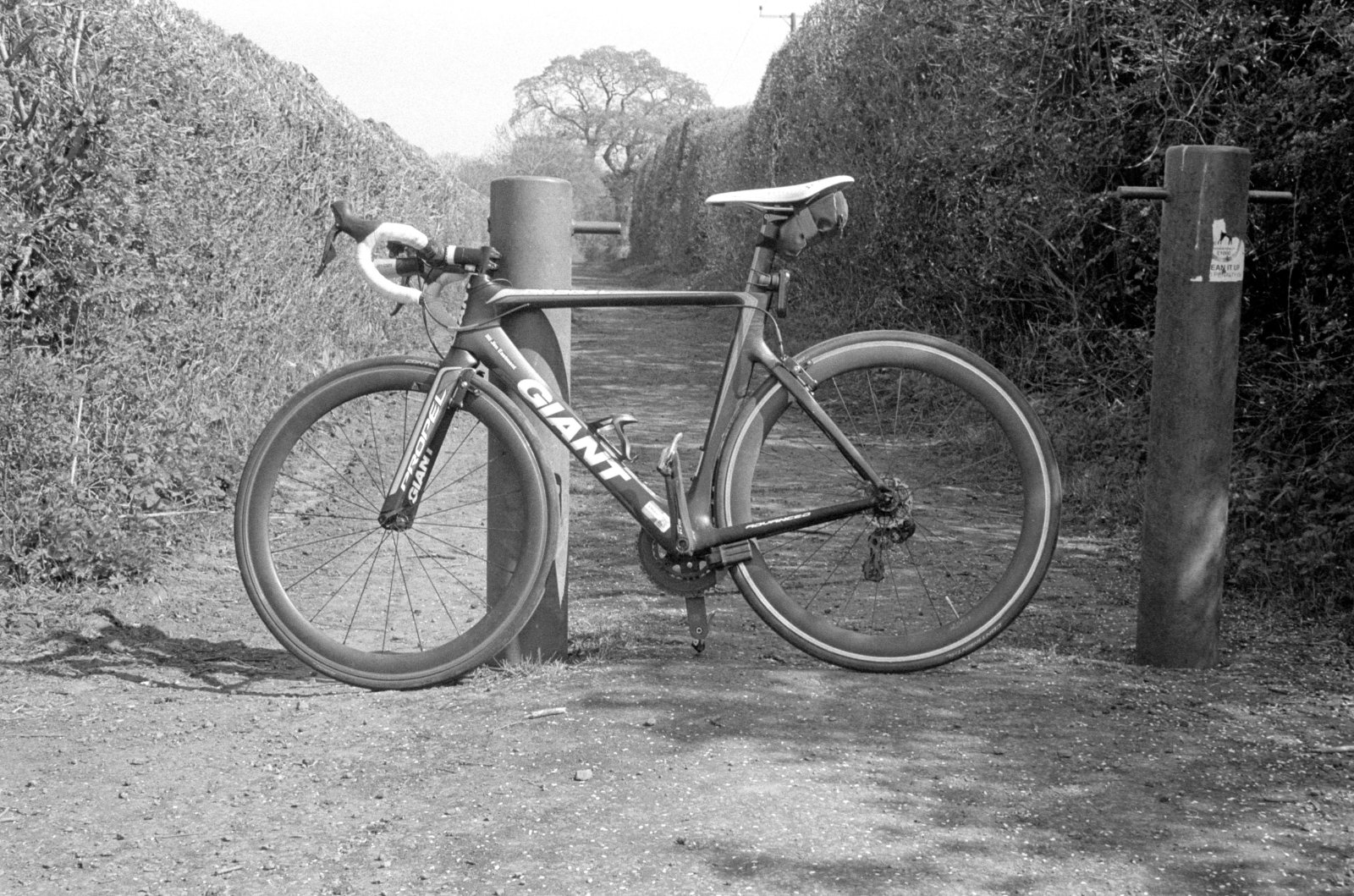

Here it is before they invented colour....
I love this bike and despite it's great age, it's going nowhere. It has the distinction of being a custom build and has the original version of Ultegra Di2* fitted - a real revolution in its day :D
It's still works very well even if it does lack the bells and whistles of the latest versions of Di2... On the plus-side its battery lasts forever...
It had tremendous brakes too, due to custom calipers and carbon wheels with alloy brake tracks... And lastly, it's feather-light and fast :D

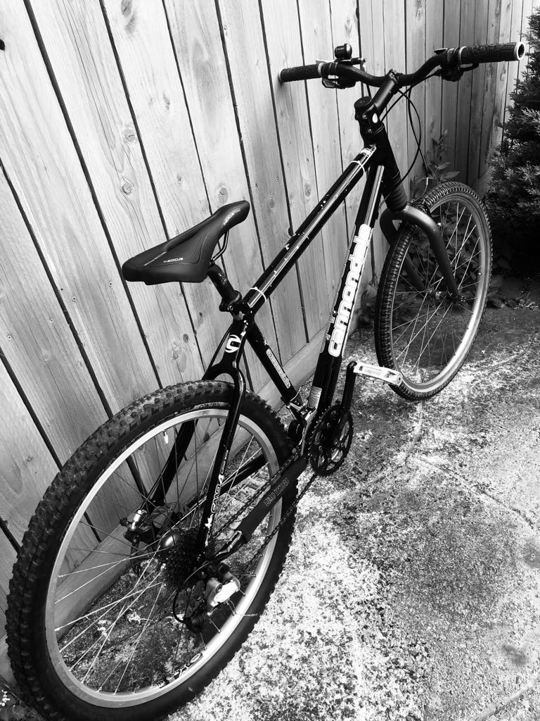

Skull's - Cannondale F900SX

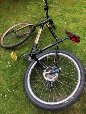

Cannondale F900SX - modified from a 'lefty' with front rim brake Head-Shok Fatty 'D' forks.

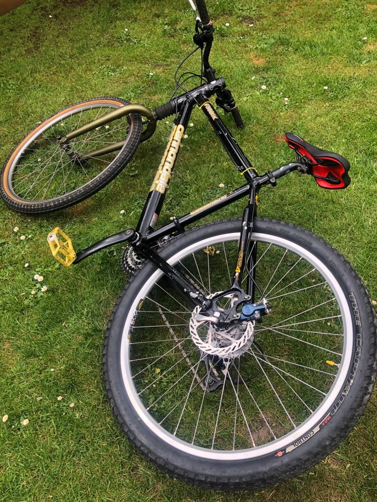

I'm not expecting too much for £50 but so far I have found a couple of things need attention before a decent ride out:
Head bearings need tightening [-o< or replacing.
Front Vee brake not releasing on one side - strip, clean, lube?
Front Vee brake threaded adjuster is badly stripped.
Pedals will be changed for flat ones as I mainly ride on road.
Other than that it looks OK - weighs 26Ibs - No Batteries Required Jim .
Just for you Jim .

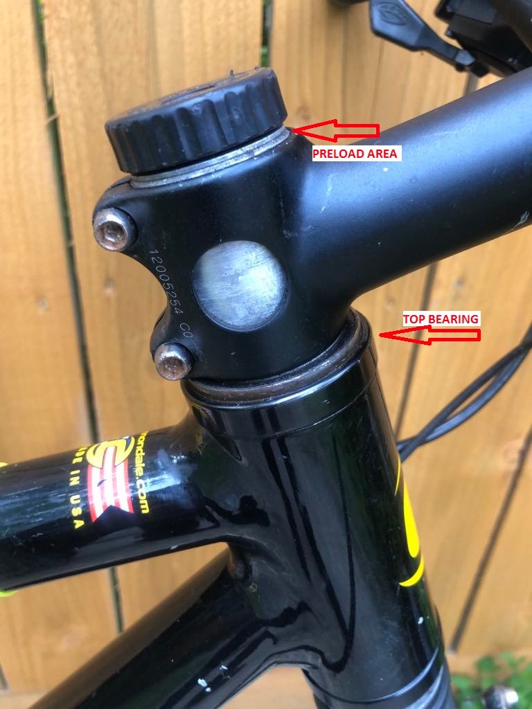

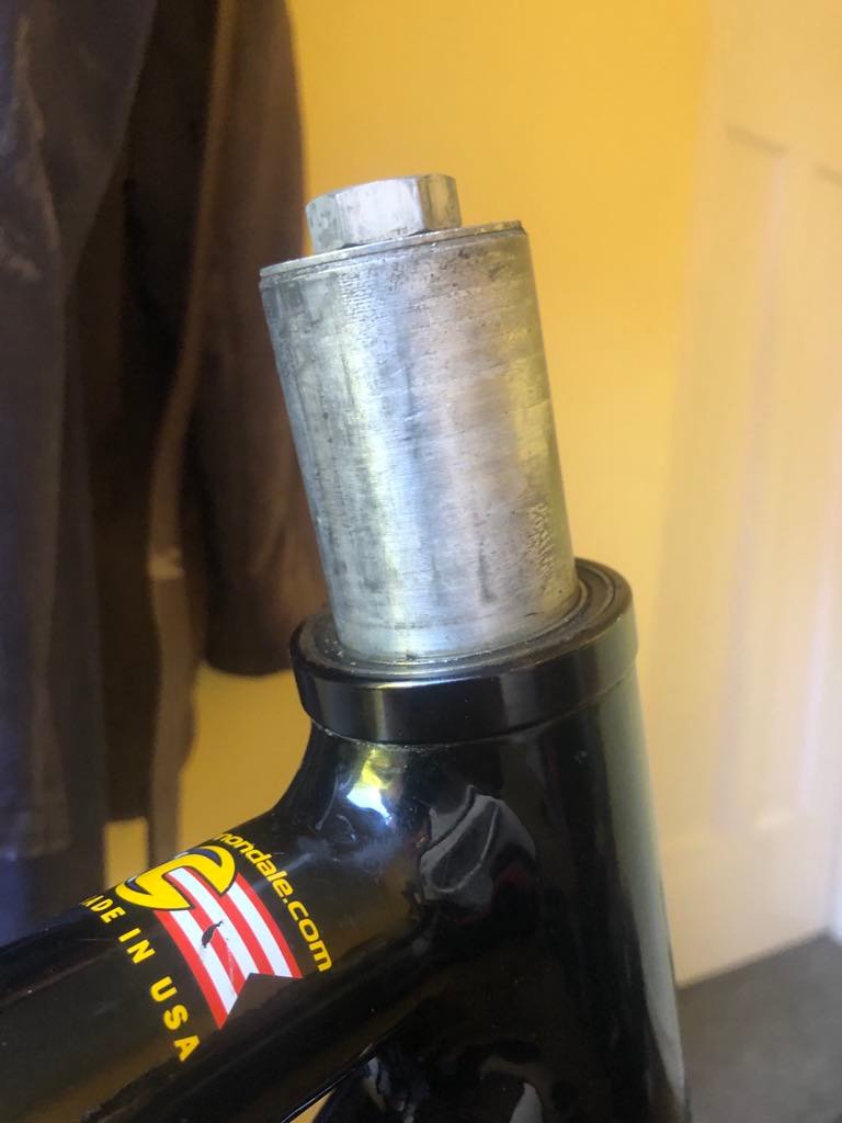

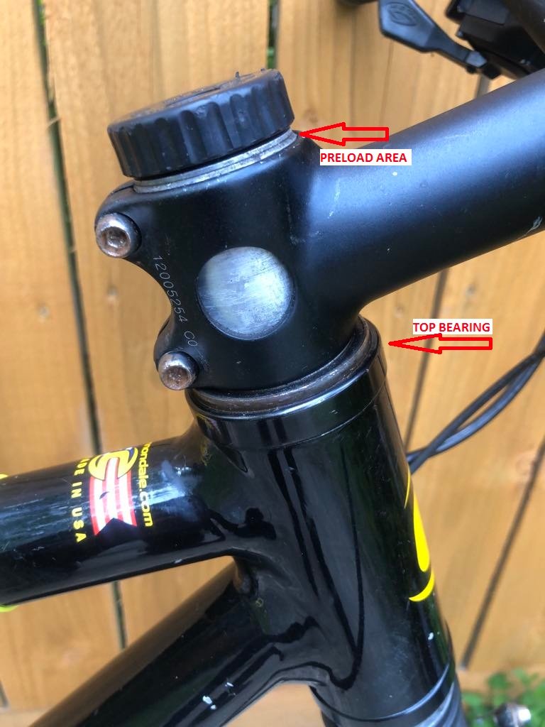

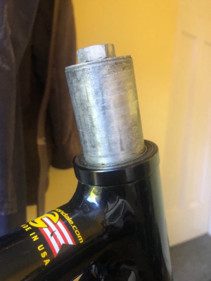

I've tried to have a play to tighten up the bearing slack which makes the forks judder when the front brake is applied, there doesn't seem to be lots of information out there on this system.
Does there look like something is missing from this picture of the headset - the top bearing looks over-exposed to the elements and I can't see how the pre-load could be applied with the gap between the top cap and the head tube?
Maybe it just needs a spacer and a bearing cover :?: but the top cap - a knurled cap is only plastic and operates the lockout and also is a similar diameter as the stem - no overlap :?:

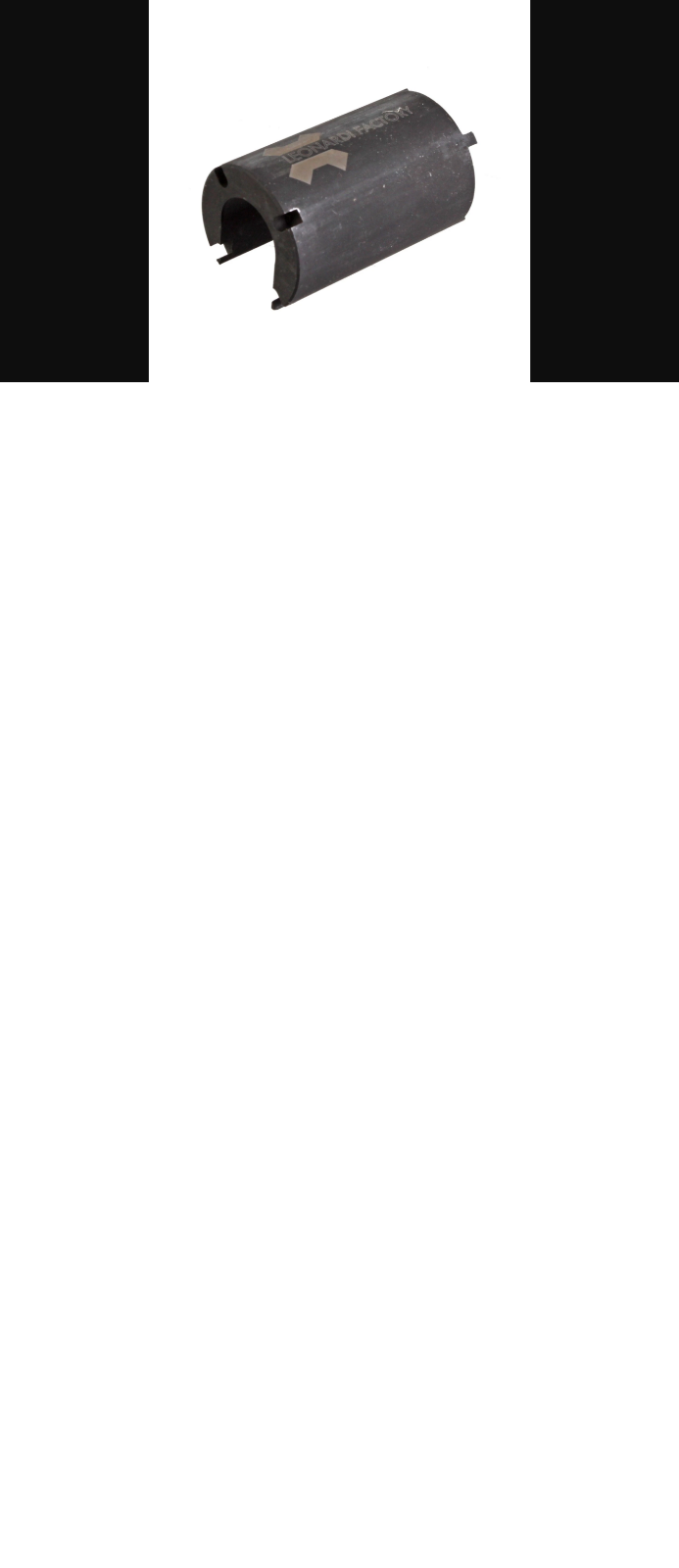

Tool required for removing headshok cartridge unit if anyone has one in their collection I could loan?
Tool - Leonardi Factory

Skull wrote: 07 May 2025, 21:18 Maybe it just needs a spacer and a bearing cover :?: but the top cap - a knurled cap is only plastic and operates the lockout and also is a similar diameter as the stem - no overlap :?:
Whilst I'm not familiar with this exact species of bike, all mine do have a collar and spacers between the top bearing and the steerer so that adequate pre-load can be applied to the bearings and the correct steerer stack-height can be obtained... The top bit should be able to be screwed down tightly enough, with spacers, to enable the correct pre-load to be achieved...
I'd say there's a collar and some spacers missing... I had just this on a TT bike I once purchased for a silly price. It's horrible to ride with loose headstock bearings...

Skull wrote: 06 May 2025, 07:05
I'm not expecting too much for £50 [or am I :roll: ] but so far I have found a couple of things need attention before a decent ride out:
Just for you Jim .
CitroJim wrote: 08 May 2025, 05:57
Cheers Jim I'll have to search out a (alloy ?) set specific to the lockout system as that plastic knob still needs to rotate to operate whilst still allowing some pre-load which is what's confusing me :spineyes: and then once it's pre-loaded I'll be able to feel if the bearings are still servicable ...

Skull wrote: 07 May 2025, 21:18 I've tried to have a play to tighten up the bearing slack which makes the forks judder when the front brake is applied….
EDIT: NO PRE-LOAD REQUIRED ON HEAD SHOK SYSTEM
After much research it appears these Head-Shok systems DON’T have any pre-load so I got the hammer and a deep matching diameter (138mm ish) cylinder out of my bush/ball joint kit and hit it several times …
RESULT
I think as a result of the ‘adjustment’ the top bearing has now seated deeper, maybe the lower bearing too but I didn’t examine or hit that end (yet), there’s still a tiny bit of movement stationary but once loaded with my massive god-like body it’s rideable…so that’s what I did - a little fly infested ride provided light refreshments in flight. The gears change better than my Huffy so that will be my winter bike now - sorted ? although I still think it needs a top bearing cover but not many 1 1/2” or 1.56” headsets around - depending on who you believe!
Skull’s - shakedown ride
27-speed !
Note the clean line - mainly from the top bearing I think!
Skull’s - reseated top bearing
