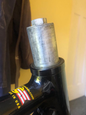

I've tried to have a play to tighten up the bearing slack which makes the forks judder when the front brake is applied, there doesn't seem to be lots of information out there on this system.
Does there look like something is missing from this picture of the headset - the top bearing looks over-exposed to the elements and I can't see how the pre-load could be applied with the gap between the top cap and the head tube?
Maybe it just needs a spacer and a bearing cover :?: but the top cap - a knurled cap is only plastic and operates the lockout and also is a similar diameter as the stem - no overlap :?:

Skull wrote: 07 May 2025, 21:18 Maybe it just needs a spacer and a bearing cover :?: but the top cap - a knurled cap is only plastic and operates the lockout and also is a similar diameter as the stem - no overlap :?:
Whilst I'm not familiar with this exact species of bike, all mine do have a collar and spacers between the top bearing and the steerer so that adequate pre-load can be applied to the bearings and the correct steerer stack-height can be obtained... The top bit should be able to be screwed down tightly enough, with spacers, to enable the correct pre-load to be achieved...
I'd say there's a collar and some spacers missing... I had just this on a TT bike I once purchased for a silly price. It's horrible to ride with loose headstock bearings...

Skull wrote: 07 May 2025, 21:18 I've tried to have a play to tighten up the bearing slack which makes the forks judder when the front brake is applied….
EDIT: NO PRE-LOAD REQUIRED ON HEAD SHOK SYSTEM
After much research it appears these Head-Shok systems DON’T have any pre-load so I got the hammer and a deep matching diameter (138mm ish) cylinder out of my bush/ball joint kit and hit it several times …
RESULT
I think as a result of the ‘adjustment’ the top bearing has now seated deeper, maybe the lower bearing too but I didn’t examine or hit that end (yet), there’s still a tiny bit of movement stationary but once loaded with my massive god-like body it’s rideable…so that’s what I did - a little fly infested ride provided light refreshments in flight. The gears change better than my Huffy so that will be my winter bike now - sorted ? although I still think it needs a top bearing cover but not many 1 1/2” or 1.56” headsets around - depending on who you believe!
