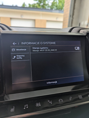

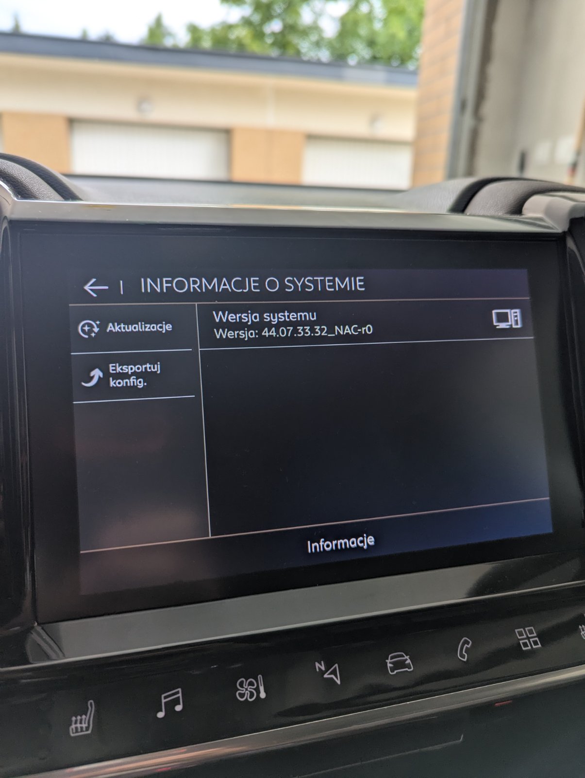

A few days ago, my Citroën started recognizing my radio as NAC Wave 4. So today I decided to try updating it—and it worked! The update went through successfully, and everything seems to be functioning properly so far.

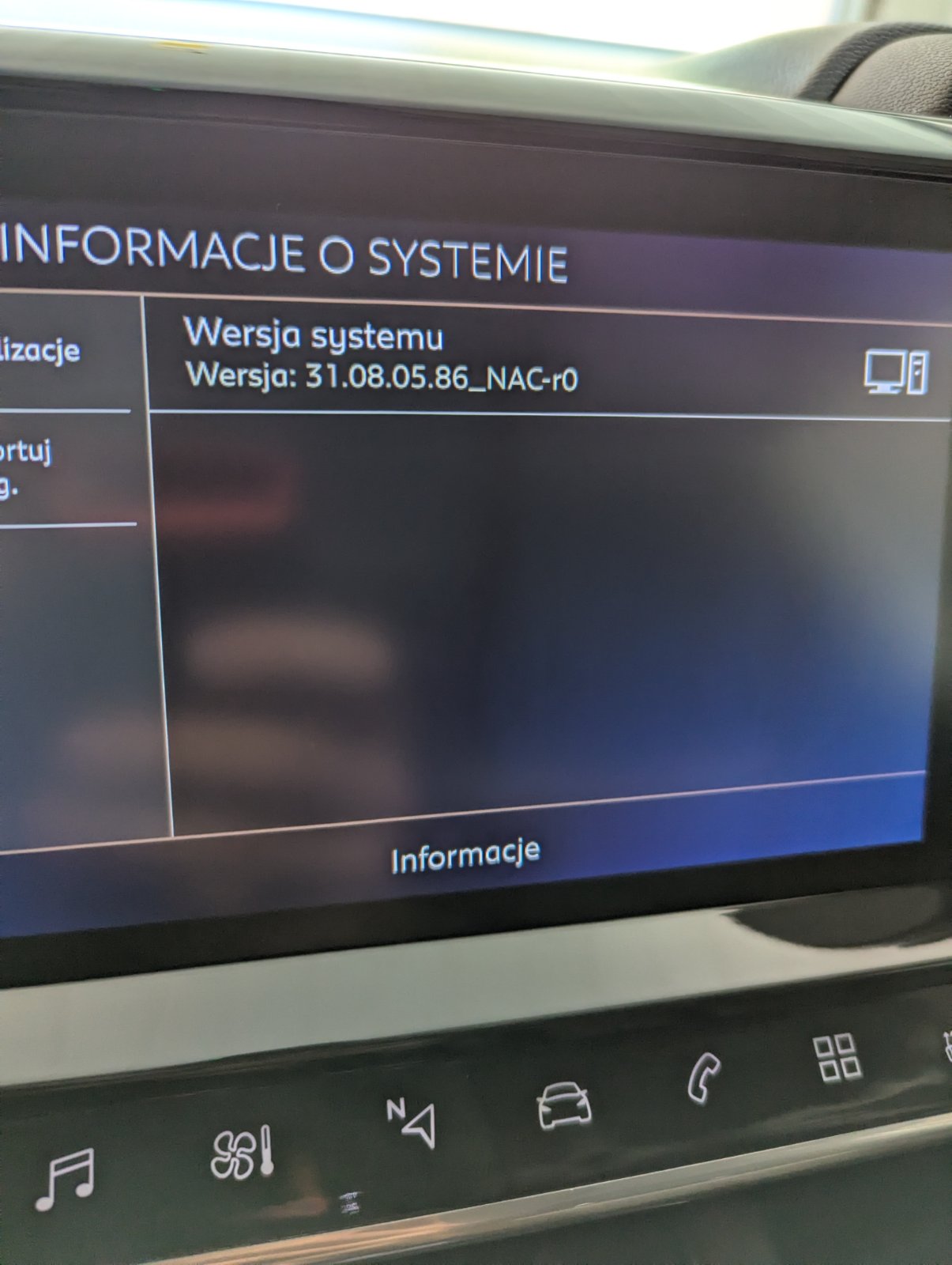

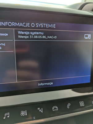

Hello, I'm new here. After a failed update from a USB drive downloaded from Peugeot Update, I have a blue screen. What's the best thing to do now?
pasiek78
Posts: 7
Joined: 13 Jul 2025, 01:10
Re: PSA NAC RCC Updates
Unread post by pasiek78 »
I wanted to add that I tried the trick with just the map to reset the system, but after inserting the USB drive, the screen goes from blue to black for about 5-10 minutes, then returns to blue.
Which firmware version should I use, and where’s the best place to download it for my Peugeot 508? The version I wanted to install is 44.07.33.32_NAC-r0, but I can’t download it anymore because Peugeot Update thinks I already have it installed.

dudra92 wrote: 13 Jul 2025, 10:13
makap42 wrote: 11 Jul 2025, 15:25 A few days ago, my Citroën started recognizing my radio as NAC Wave 4. So today I decided to try updating it—and it worked! The update went through successfully, and everything seems to be functioning properly so far.
Can you please give us step by step details. I'm in the same situation as you, but I still get "Version not compatible with hardware" issue.

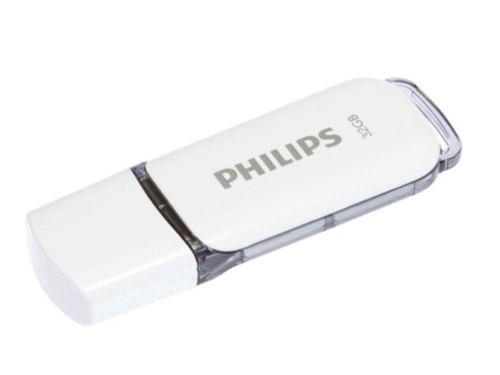

Citroen Update recognizing my radio as NAC Wave 4 (site: https://sites.google.com/view/nac-rcc/system also recognizing my radio as NAC Wave 4), so i create USB drive (Pendrive PHILIPS Snow 32GB, USB 2.0) with update (44.07.33.32_NAC-r0) and i update system in my car. Thats it.

pasiek78 wrote: 14 Jul 2025, 09:29 Did you have to change anything else in the files on the USB stick?
Did you download the system from that site and just copy it to the USB stick—without any activation key?
I’m getting a blue screen after a failed update, and I wanted to put the same firmware on a new USB stick like you did.
I didn’t modify any files. I created the flash drive using the Citroen Update app.
Check your VIN in site https://sites.google.com/view/nac-rcc/system. If recognize as Wave 4, update must go on.
