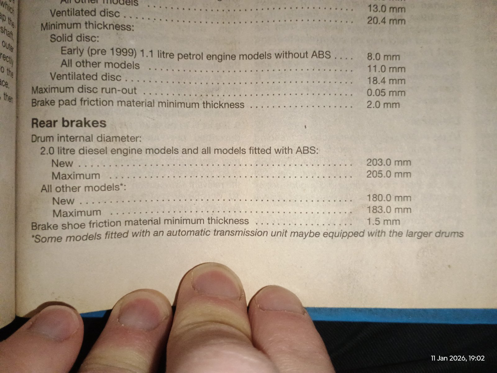

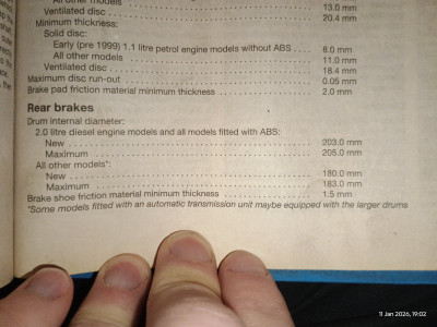

Anyone know the thickness the brake drum should be ? Untill they need new ones ?
:-D
Posts: 5364
Joined: 25 Apr 2022, 09:03
x 2367
Re: Peugeot 207 1.6hdi (New edition to the fleet)
Unread post by MattBLancs »
Huskyxantia wrote: 11 Jan 2026, 18:52 Anyone know the thickness the brake drum should be ? Untill they need new ones ?
Sorry drum maximum inside diameter or shoe friction material thickness?
Sorry I haven't a book of lies for 207, if they've carried over same drum setup as the 206 uses, then here's the figures from Haynes:
206 rear brake data
206 rear brake data
306 has
New 180mm to max 181mm or Bendix new 228.6 to max 230 mm
Shoes new 4.85 mm to minimum 1.5 mm
Huskyxantia
Posts: 3944
Joined: 30 Jul 2018, 22:11
x 928
Unread post by Huskyxantia »
I'd say the 2.0L is same size as the 1.6 , thanks Matt
:-D
Posts: 5364
x 2367
Huskyxantia wrote: 11 Jan 2026, 19:25 I'd say the 2.0L is same size as the 1.6 , thanks Matt
I'd guess so, sorry I should have explained: that 206 manual only covers the earlier ones, so predates the 1.6 diesel existing (was only the 2.0 HDi and 1.9 DW8 engines back then, can't recall if that manual covers the 1.4 HDi engine or not)
