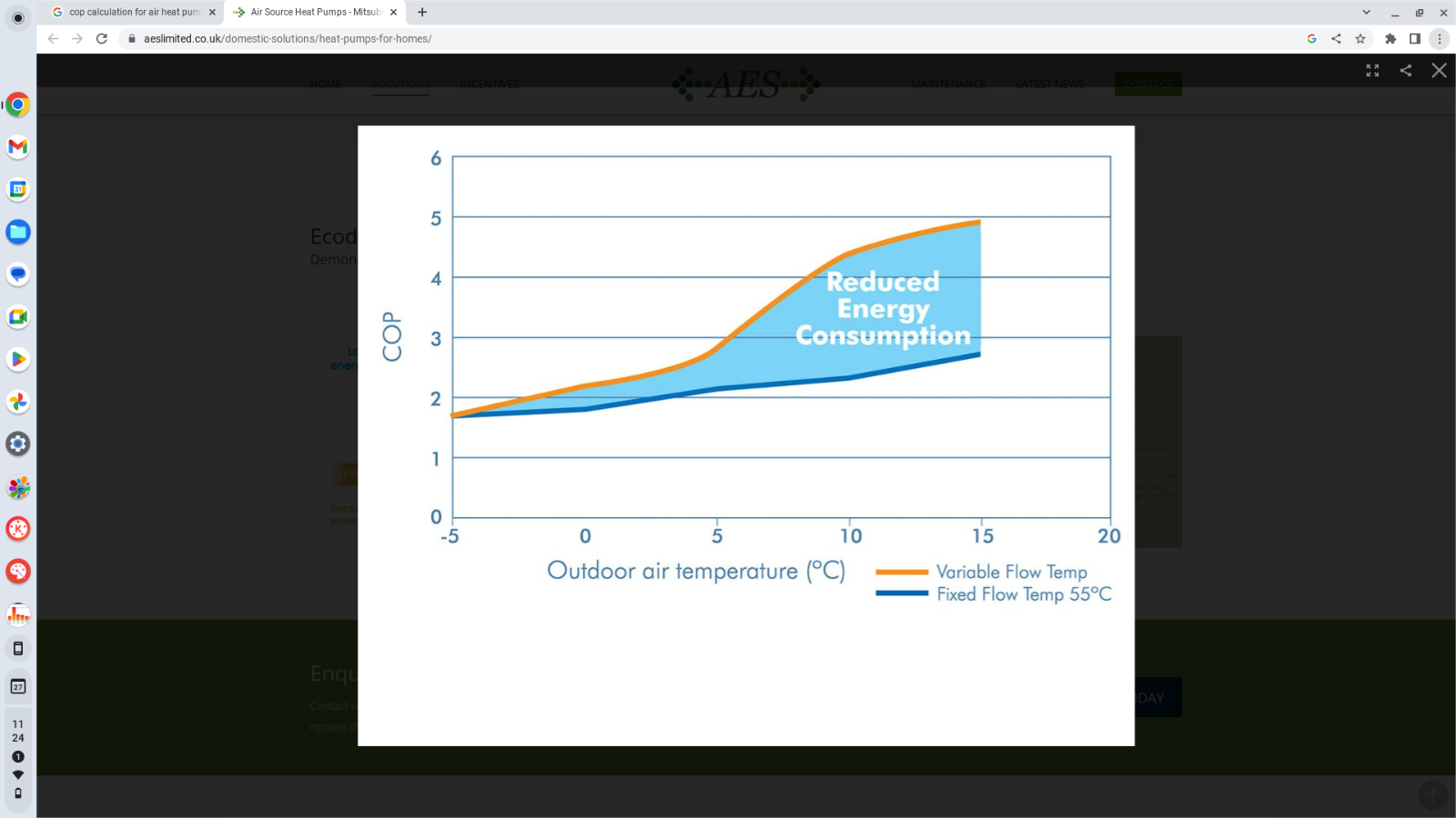

I have looked at several Manufacturers and this interesting graph came up for European Markets.
Notice the blue line which is the closest to a domestic water CH system with radiators. It never reaches 3.3 COP. So, not only won't this particular ATW heat pump work efficiently on a wet CH system (only 55`C ) it will never match the COP needed to break even let alone offer savings

Just for fun, here is the average outside temperatures this month in Fife
Only on fleeting times this month would the COP of the Orange Line ( underfloor heating ) reach anything close to 3.3 COP and above needed to break even in cost/save money.
Eventually I will badger this Market Harborough firm into giving me a quote for a system for my house ( though I am not going to hold my breath ) so I can see how much money I have to spend to "save" money.
