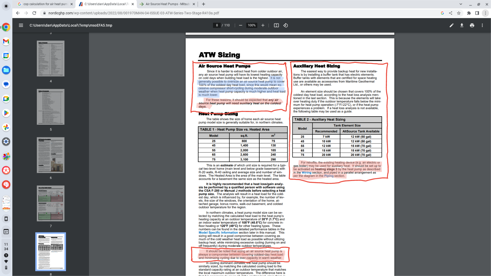

Out of curiosity, I applied to a scheme for such a green exchange. Where is the firm based? Market Harborough. Not East Kilbride or even Eyemouth. My nearest installer is Market Harborough!
Anyway, I have been doing rough calculations for my house and I have found that over the last month, as an example, a ATW Heat Pump would have needed to have achieved a COP of 3.3 to cost the same as my gas system. Now, trying to find the engineer's calculations to achieve this was all but impossible in the UK. But, go to Canada and not only do you get all the information you need but you also find a set of disturbing conditions.
The nail in the coffin is the very last paragraph.
It is recommended I retain my existing heating to top up the shortfall!!!!!!
This is from a company that relatives in eastern and western Canada know of and is rated as an OK firm but I only got this information from their Engineer's Manual which in Canada is a lot more readily available than the UK.
