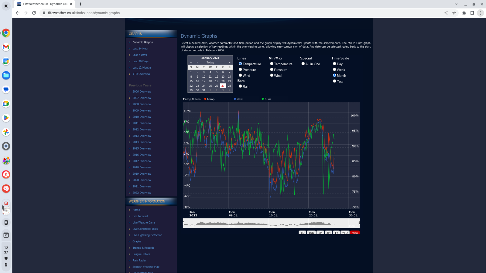

Just for fun, here is the average outside temperatures this month in Fife
Only on fleeting times this month would the COP of the Orange Line ( underfloor heating ) reach anything close to 3.3 COP and above needed to break even in cost/save money.
Eventually I will badger this Market Harborough firm into giving me a quote for a system for my house ( though I am not going to hold my breath ) so I can see how much money I have to spend to "save" money.

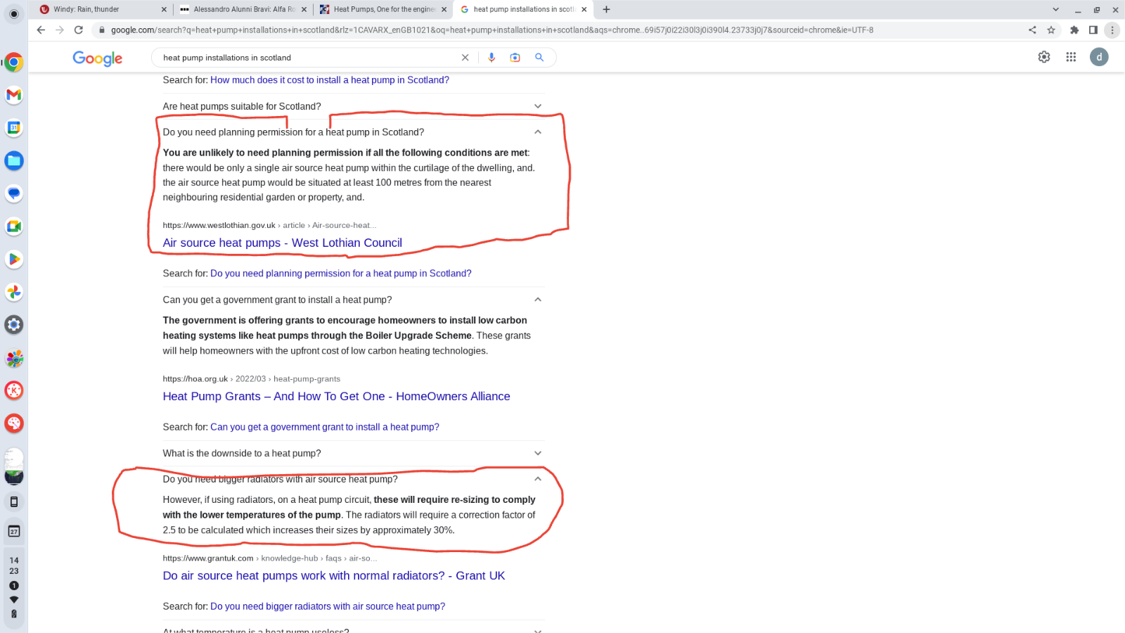

When you make enquiries about Heat Pumps to Councils in Scotland it is pointed out that you may require Planning Permission
It is also recommended that existing CH Radiators may be out by about 30% capacity.
The more you research, the more questions need to be answered.
