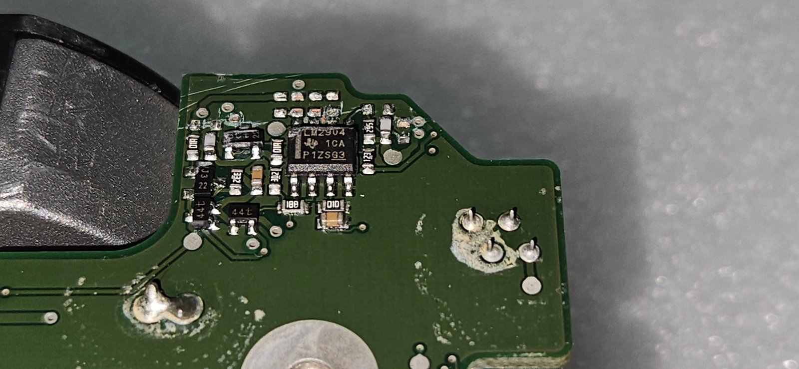

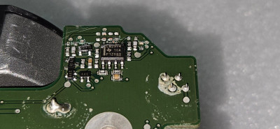

Hello, I'm looking for a photo of my RNEG BE 6428 board. On mine, 7 elements are scratched. In the area of LM2904. If anyone has a diagram or a photo of this part of the board, I would be very grateful if they could share it.

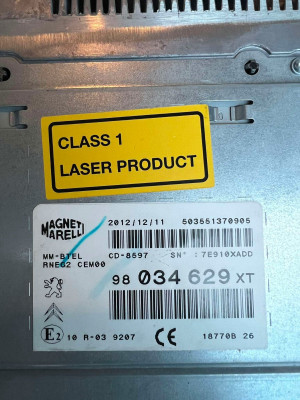

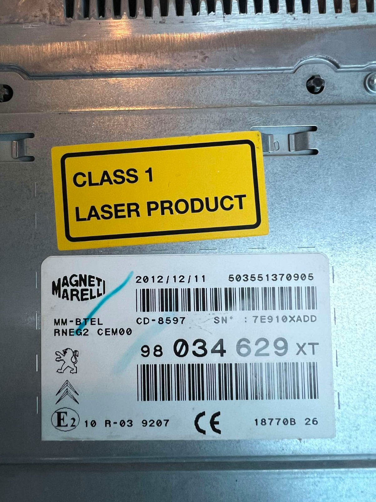

I have Magneti Marelli MM-BTEL RNEG2-CEM00, car is Citroen C4 Piccasso 2012
When switch on the ignition, screen turn on backlight for a secondt, than go black again, and i hear fans in radio to start turning for 2 seconds.
Unit dont take CD inside.
I take it out, and there is no SD card inside, tray is empty.
But radio and maps works normaly 2 weeks ago.
What to do.
Can someone send me firmware with the instructions?
What to do.

Re: MyWay / RNEG Issues
It's a common problem with these - start looking for a repairer for these units or a replacement and coding. Flash memory failure (no HDD in these) or motherboard chip issues.
