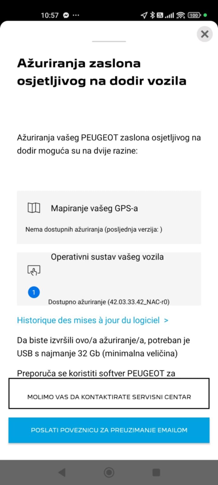

Hi, I also have a same problem updating software and maps on my Peugeot 508 2019. I saw on MyPeugeot app that there is software update (attached) but no maps update (installed maps are 2018) not sure why is it that I don't have Navigation Services subscription or something else, do I have pay subscription or can I install them manually?
I entered my VIN number in Peugeot Update on Windows and it created USB for update, but when I insert USB I also get errors
"No content on the USB drive" & "Version incompatible with the hardware."
I read here that its certificate issue, how can I solve it?
