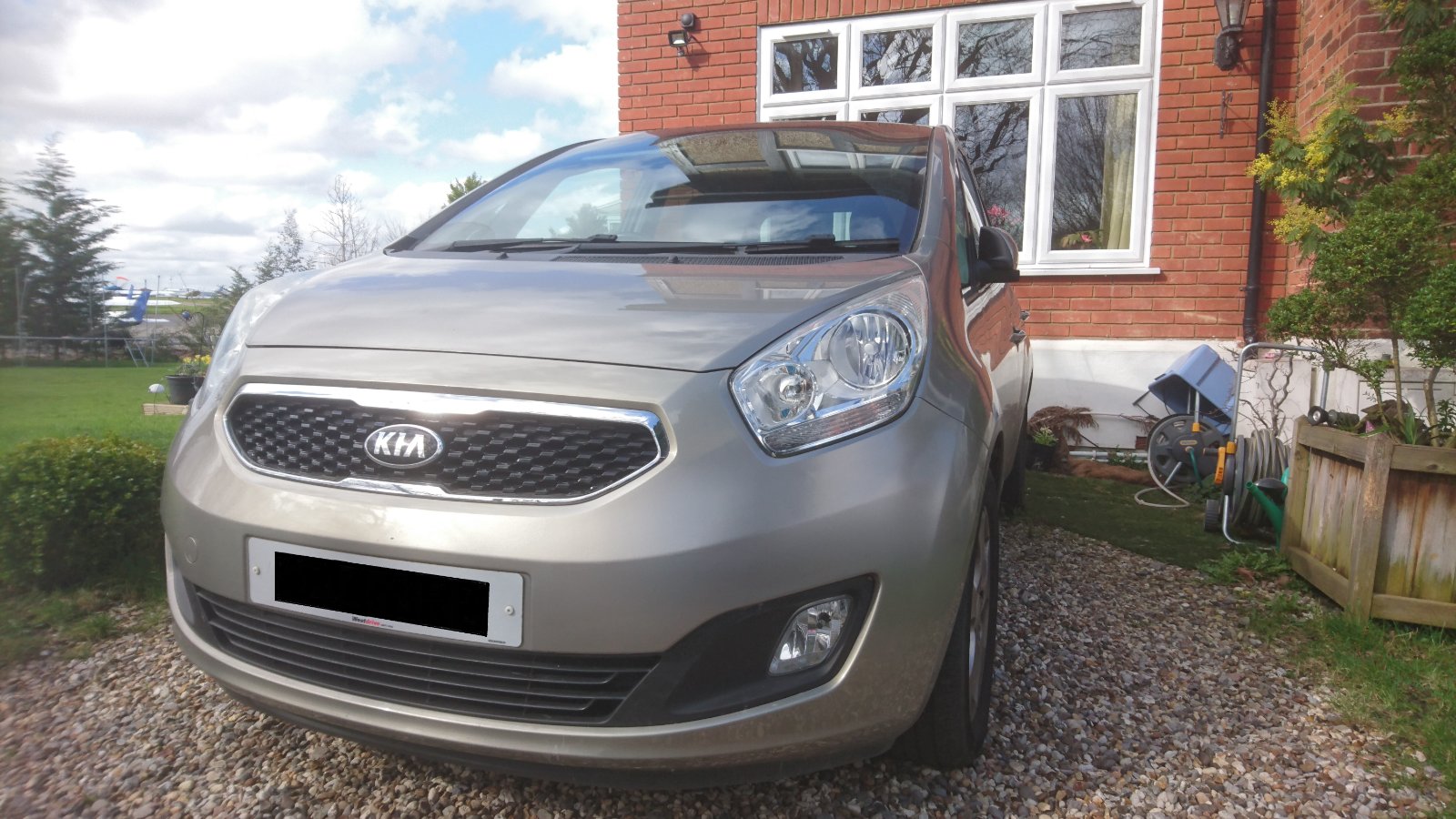

I had to go and finish off a bumper repair on the fleet Venga this morning. It had been scuffed in a car park by a driver who refused to take responsibility claiming "my parking detectors didn't even sound!" Hmmm. So to avoid a long nasty argument I said I'd do what I could and this is the result:
Own work
Own work
As ever I forgot to take a picture before I started but suffice to say there was considerable scuffing and a dink just above the end of the centre crease line. Not a perfect job by any means but in my view presentable enough for the sale of the car!! :-D

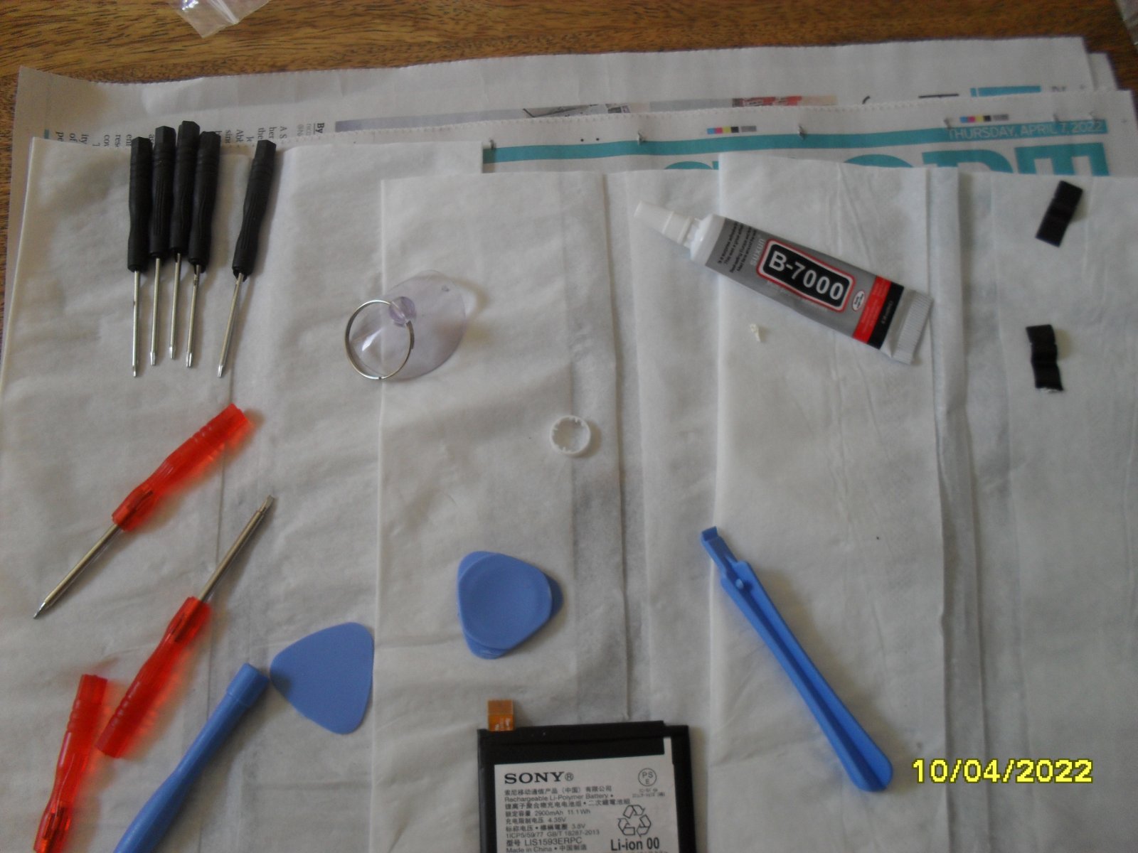

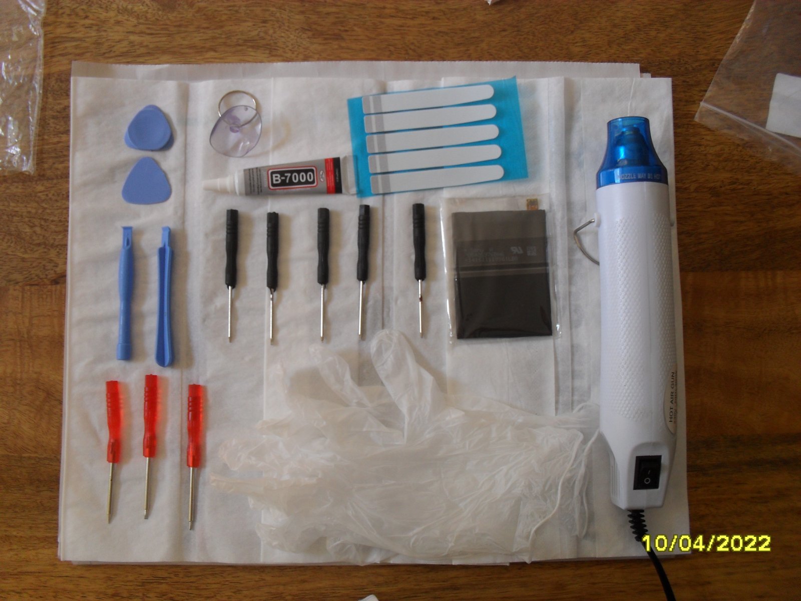

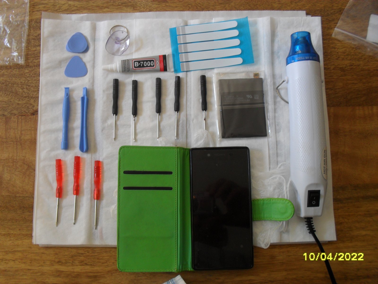

Over the last month or so my phone has been throwing wobblies for no apparent reason. I would charge it overnight and then maybe after viewing a couple of posts on here and watching a video it would just die. On plugging it in it came to life after a couple of minutes showing 2% battery and charging. So after that happening 3 times I decided my battery had come to the end of its life and needed replacing. Being an Xperia Z5 the battery is fully enclosed and has no unclippable cover so a certain amount of dismantling was required to replace the battery. I set about ordering the new battery, tools to remove the back cover, glue strips to fit the new battery, glue to refit the case and a low wattage heat gun to soften the existing glue to release the back:
Tools required!
Tools required!
So this morning after watching the Grand Prix I decided it was time to bite the bullet and get the job done.
The phone added to the workspace

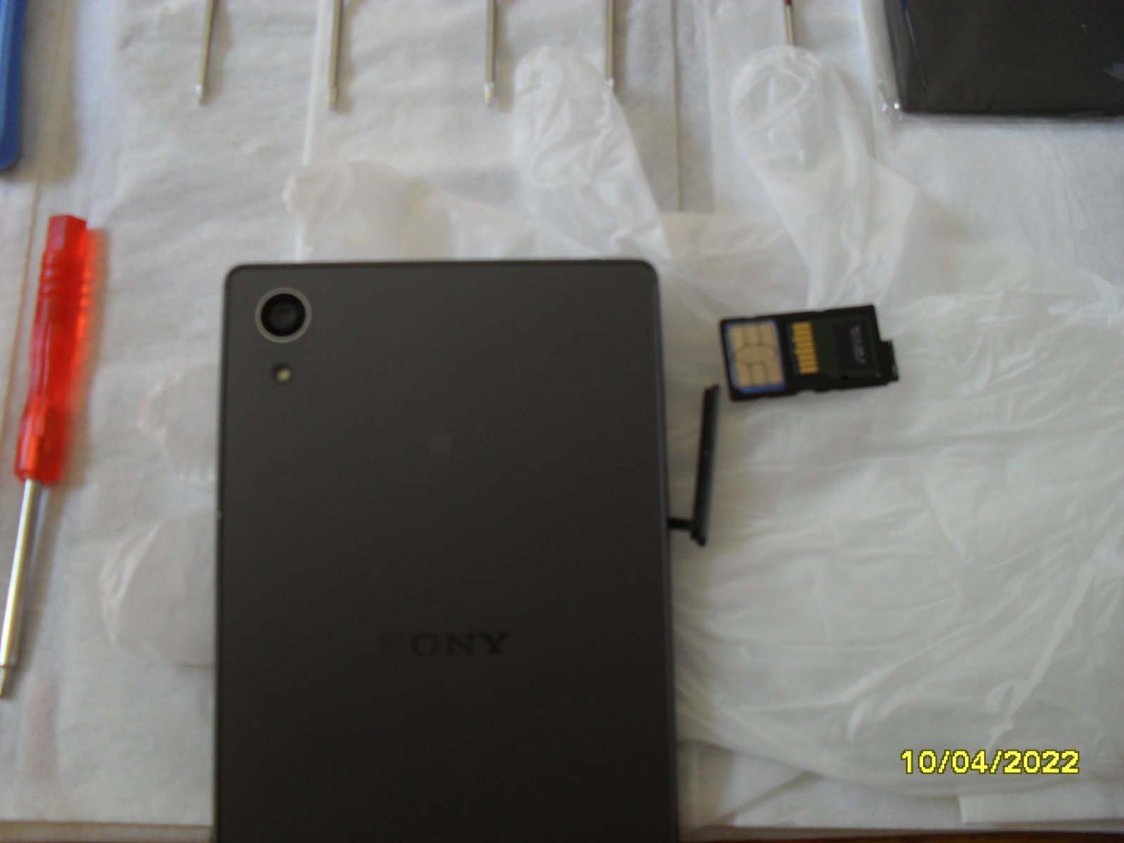

The first job is simply to remove the SD card and Sim card which are held in the same carrier.
The cards removed.
The cards removed.

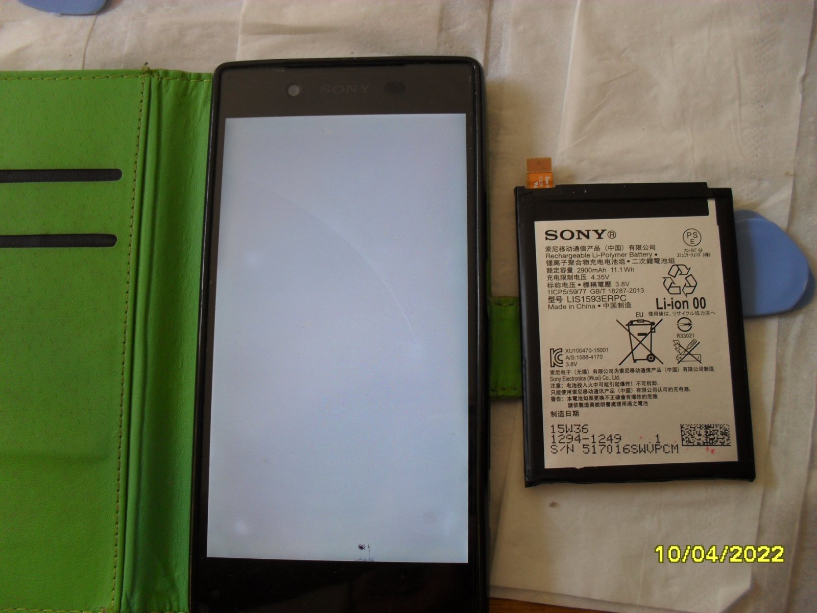

The next job is to heat around the edge to melt the glue and then prise off the back cover. As I forgot to take any more pictures, having become involved in releasing the back I will post a video of another chap doing exactly the same job at the end of this post.
Then, as you will see it is a matter of releasing the glue strips from under the battery, unplugging the battery and lifting it out. Then reverse the process using new glue strips and the adhesive to refit the back. Re insert the cards and finally the moment of truth when you press the power button with baited breath!
Success!!
Success!!
It lit up as expected showing 00.01 on 01.01.70!! Hmmm! Not to worry it is set to use system time and once reconnected to the network it set the date and time correctly. The battery level showed as 60% so I will run that down before charging and hopefully all my troubles with it will be over!!
All that remained was to clear up and put away the kit for the next time!! :-D

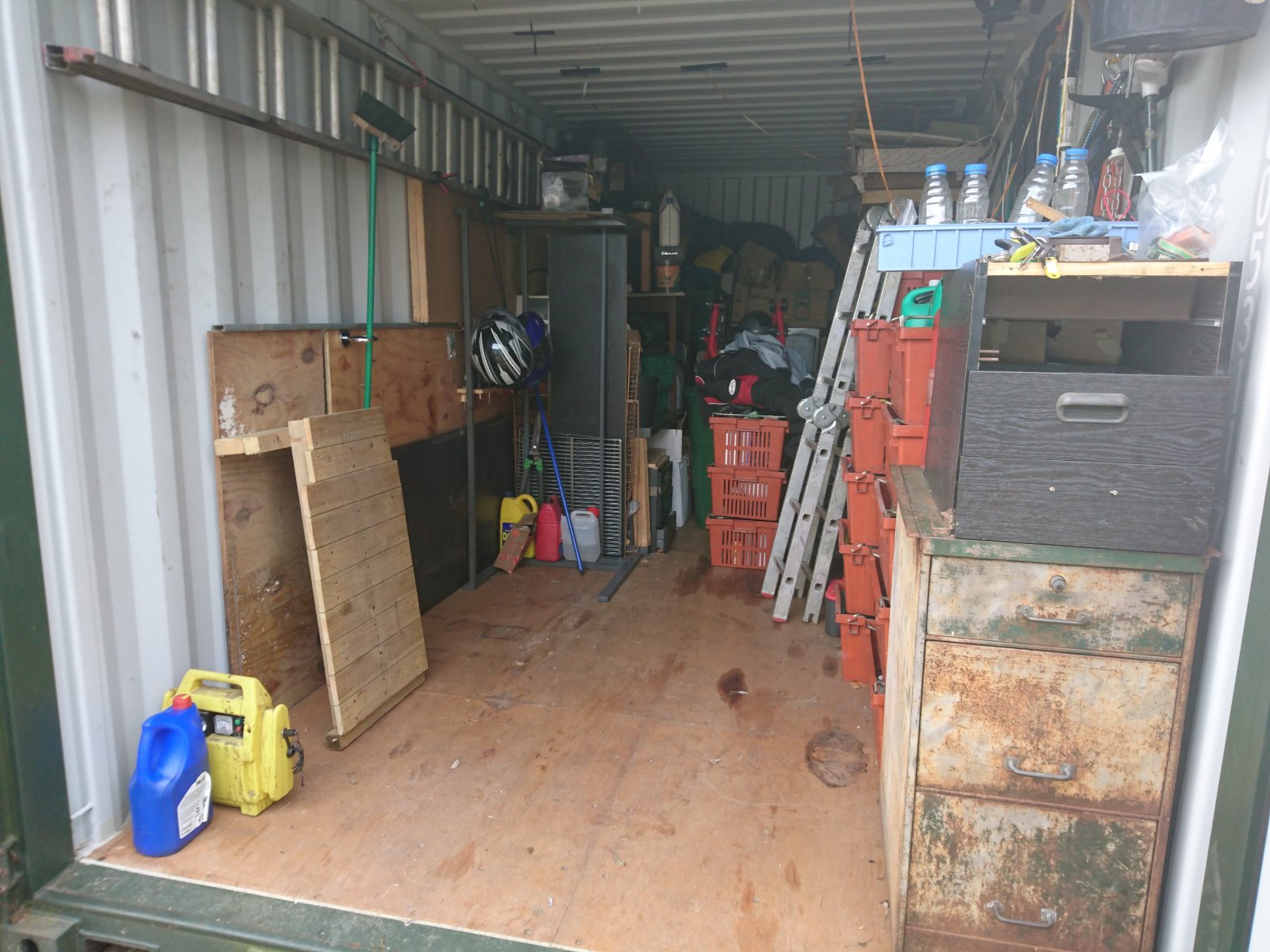

Two days in and I'm pleased to report all is well with the phone. Takes a lot longer to charge to 100% and correspondingly lasts a lot longer in use. Over the last two days I have only used around 25% per 24 hours compared to the 90% in 5 minutes I had experienced a few times!! :-D

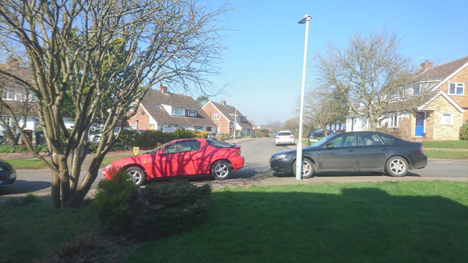

So on to the next project which began this morning, spot the project! (you may need to refer to a few posts back on this thread!) :-D
Own work
Own work

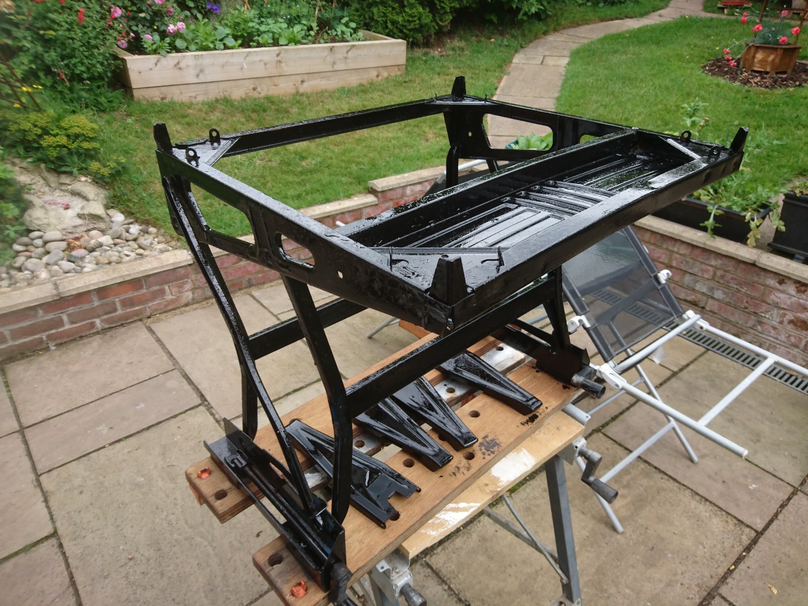

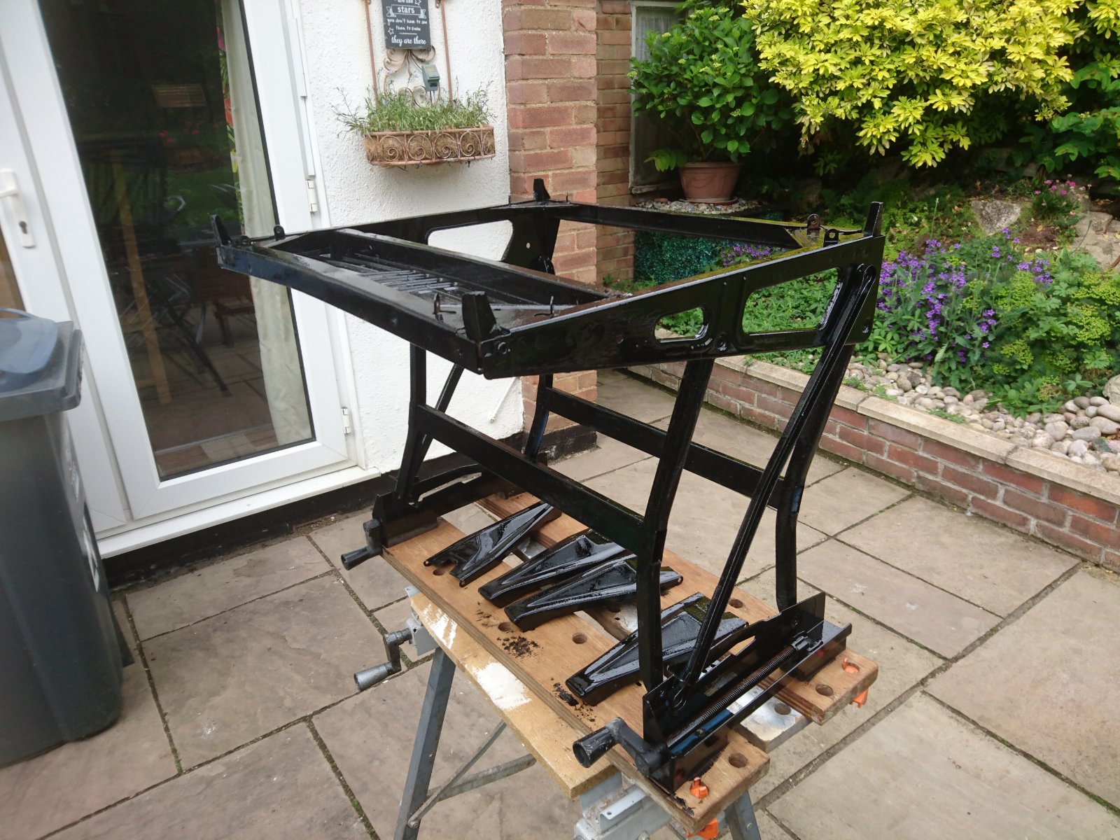

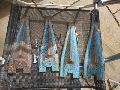

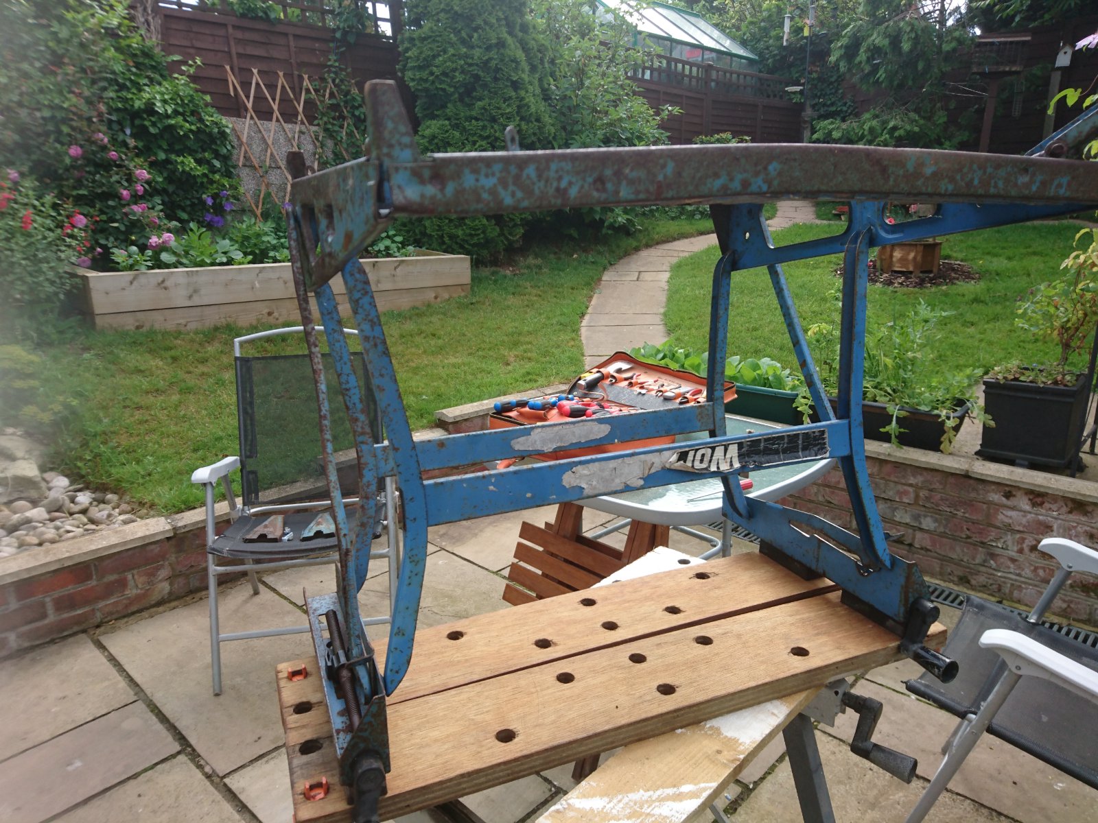

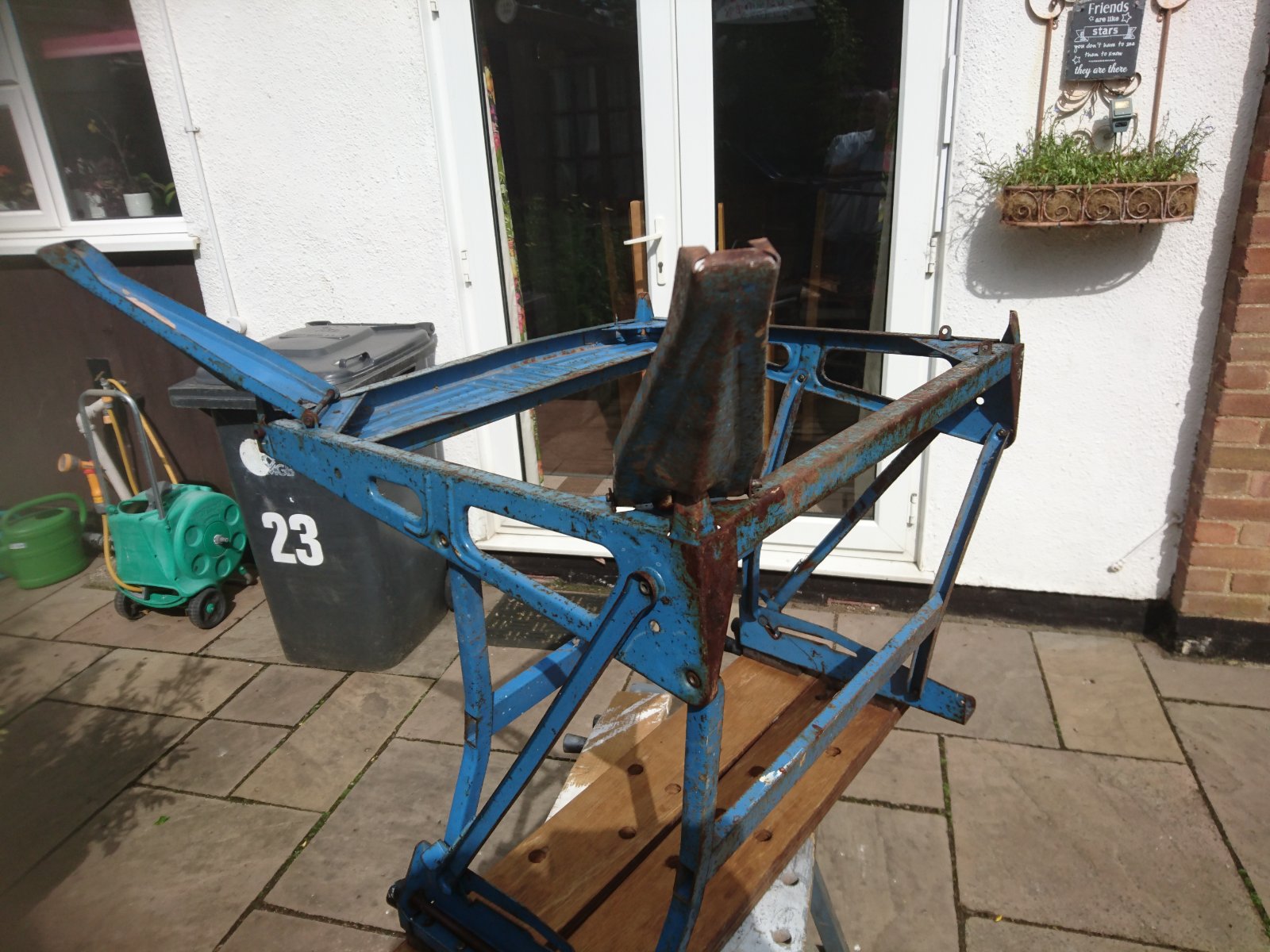

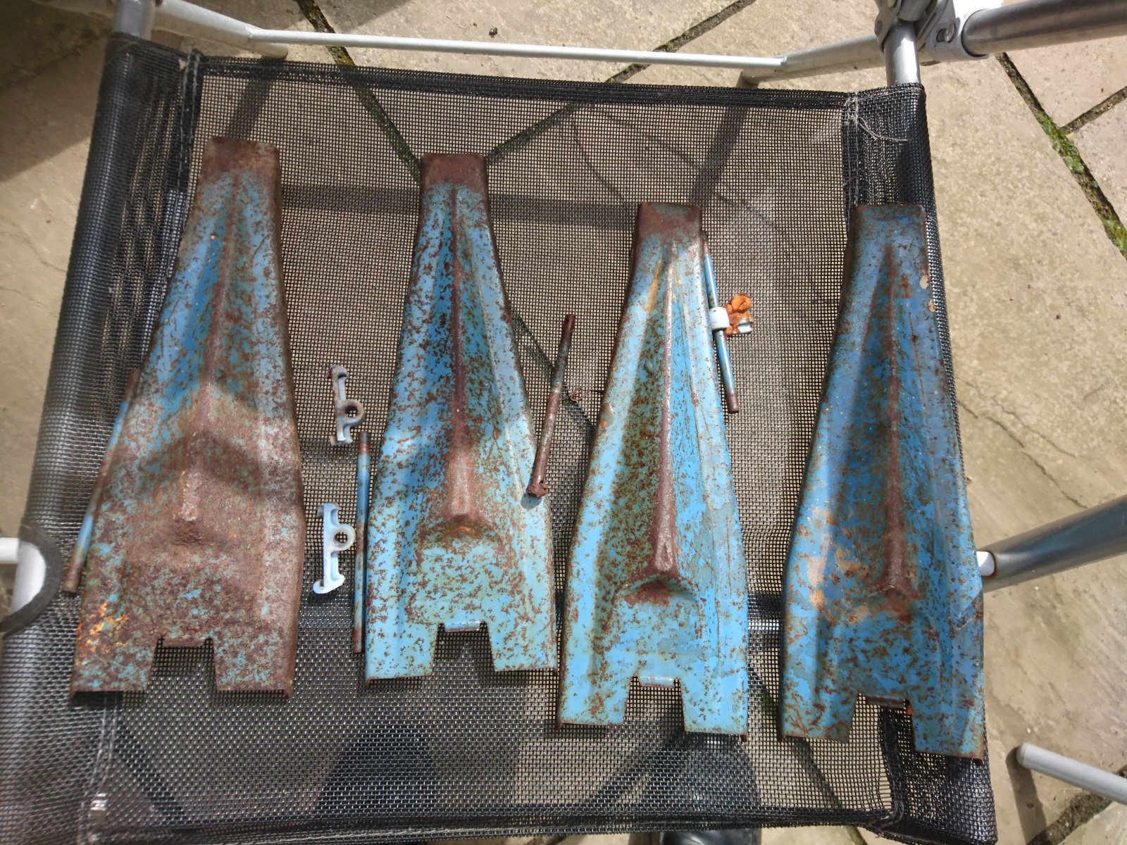

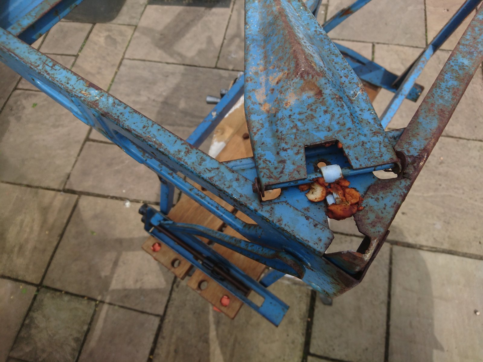

Another lot which I collected from the auction on Monday was this dual height Black & Decker Workmate. I only have the cheapo version so I thought it was worth a shot for a tenner which won me the lot! :-D
So the first thing I realised when I collected it was that all its rubber feet were missing and all four leg catches had broken away. However I know the parts are available so I was not too worried about that. On getting it home on Monday I gave all the moving parts a good dose of WD40 and left it in the shed until this morning when I decided to start restoring it. The feet and catches have been ordered and should be here today/tomorrow so I set about preparing the frame for them. First up was a good wire brushing and some use of the flap disc on the angle grinder followed by a prime of the bare metal, which I forgot to snap, and then the finishing coat. The pictures tell the story so far: :-D
Own work
Own work
Own work
Own work
Own work
Own work
Own work
Own work
Own work
Own work
Own work
Own work
x 2941
I've got a well used one of those Mick, bought it for dad a long long time ago then when he passed we found a label tied to the leg saying 'For Eric' :)
