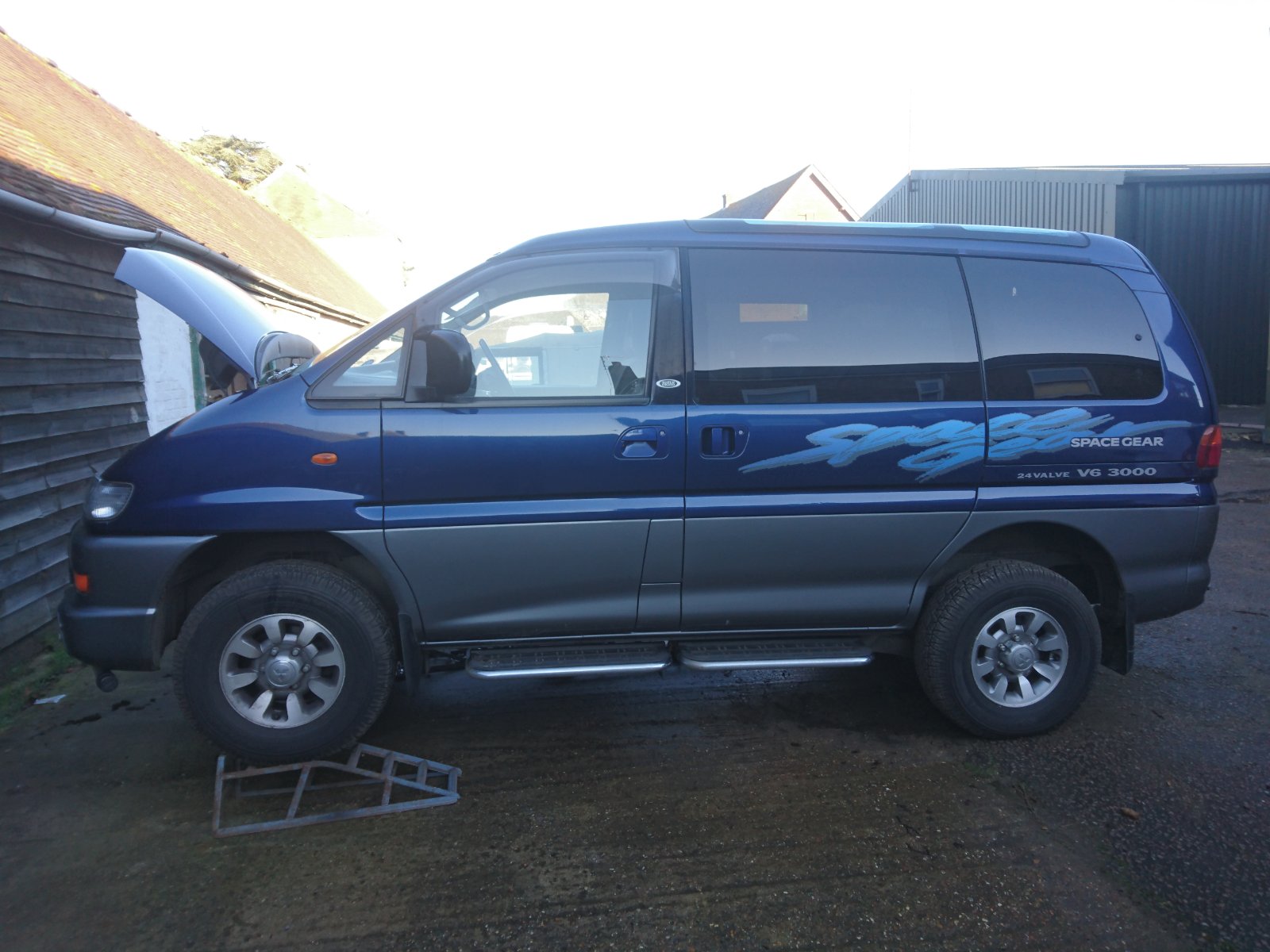

As the day dawned dry and sunny I decided it was time to visit the mancave and catch up with goings on there. My mate Dave, whose brother owns the mancave, was over there working on his V6 Delica:
Having got it on the ramps the front exhaust section was removed:
Dave then cut out the fractured expanding joint:
and settled down to play with his new toy.
After half an hour's work we had the exhaust ready to refit:
Unfortunately I had to leave him before the refit was complete but as he had to go home in the Delica and I have not heard anymore I'm sure it all worked fine. Before I left I took a quick shot of his brother's Minis which still await rebuilding!!:-D
For the record this all started when Dave built a new exhaust in stainless steel (practice with his new toy I suspect
) but used the original expansion joint which promptly began to whistle annoyingly at 3000rpm. So he had to dismantle the front end to fit the replacement today!!

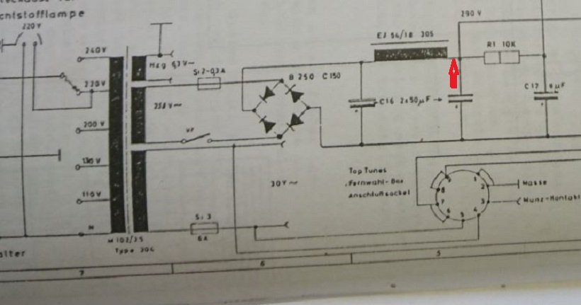

Calling vintage electronic buffs!!
Today brought a visit to my friend's in Dunstable to see if I could discover the problem with his Wurlitzer Lyric jukebox. Apparently he switched it on the other day, all the lights came on as usual and the selection process began as expected and loaded the single he had chosen. He then watched the stylus move onto the disk and heard.....nothing!! Putting his head close he could just hear the direct sound from the stylus thereby confirming that the problem was in the amplification and/or speaker system. At that point he called me for advice so I popped over this morning for a preliminary assessment! Here is what I found:
I decided the best thing to do was bring it home and have a good look. As I gently worked through the wiring this happened:
So with reference to the diagram in the manual I was able to work out where it came from and refit it.
This picture has the red arrow indicating which wire it was. You can see that without it there is no power feed through to the audio circuits so I am hoping it is the problem.
However the power transformer has signs of significant burning and I discovered that the twin speakers (8 ohm) in the jukebox had been wired in parallel and connected to just the right channel, presumably because at some point in the past the left channel had failed and so the bodge was made by someone with little understanding. That would have meant loading a single channel with a 4 ohm load and hence doubling the current draw from the designed level which may have resulted in the burning of the transformer!!
So in view of that and the potential unreliability of the circuitry remaining, we have decided to replace the amplifier altogether so a bit of rewiring will be necessary to still feed the lights and selector mechanism as they currently operate as slaves from the amplifier power supply. I expect we will fit a modern preamp to the turntable output and then feed that into a modern stereo amplifier to drive the speakers. Fingers crossed!!

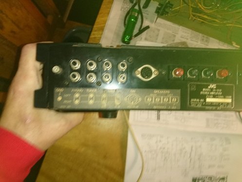

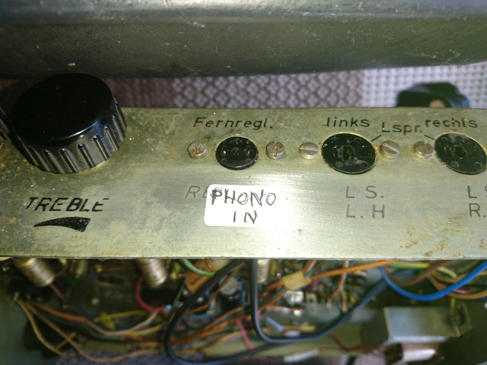

A quick update on the jukebox problem.
I looked around and found a JVC amplifier equipped with a phono input so I don't need the preamp.
That meant some jiggling with the original amp wiring to divert its phono input (3 pin din from the turntable) to a pair of output phono sockets which I could then connect to the new amps phono input with a standard phono-phono lead. In the end I noticed the original amp had a 3 pin din socket for a remote volume control which obviously is no longer going to be needed so I simply cut two plugs off my lead and connected them directly to that 3 pin backside and fed them out a spare hole ready to plug into the new amp.
Now we just plug the turntable lead into that socket instead of its original phono input and thereby ensure complete separation of the old amps audio circuitry from the new amp.
Because the jukebox's lights and selector mechanism are powered from the power supply on the original amp I will refit that just as a power supply to avoid changing all the other internal plugs. The old audio circuitry is now isolated and will not therefore overload the power supply so hopefully all will be good.
I am slightly concerned about the burning in the main transformer but we have been unable to find a replacement so the only option there may be to have it rewound. However I am going to take it over and test it in the jukebox on tuesday so watch this space!!
