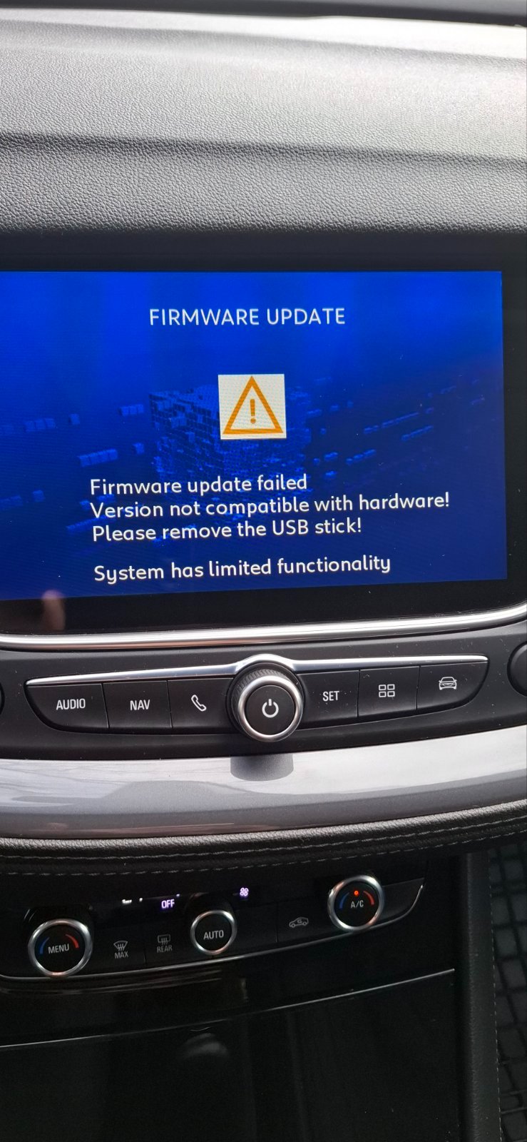

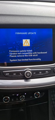

Are you sure the USB flash drive doesn't have the firmware update? The "Firmware update error" implies that it tries to update the firmware...Paulus33 wrote: 23 Feb 2025, 12:55 . . .
I inserted the USB with the map data, again the message: Firmware update error. Please remove...
If you have the SOS and the Assistance buttons, it means you have a BTA (Boîtier Télématique Autonome) / ATB (Autonomous Telematics Box) - so, yes, the infotainment system can verify the license online, and you don't need that file on the USB flash drive.
But the signing certificate and the firmware license are 2 distinct entities. The former confirms that the firmware came from PSA/Stellantis and wasn't tampered with, and the latter allows your system (serial number) to install that particular firmware version (UpdateID).
The current problem is the signing certificate, and only PSA/Stellantis can fix it by releasing a new firmware update with a valid certificate (public key stored at SWL/00*/Certificates/PSA-OVIP-CS-G1.crt) and the file SWL/001*/MediaHeader/MediaVersion.ini signed with said certificate (their private key pair). The new (valid) certificate already exists - http://pki.p3cs.com/PSA-OVIP-CS-G1.crt - and was used to sign the latest NAC Wave 2 and Wave 4 firmware versions. They just need to use it to sign the MediaVersion.ini file in the NAC Wave 3 firmware...

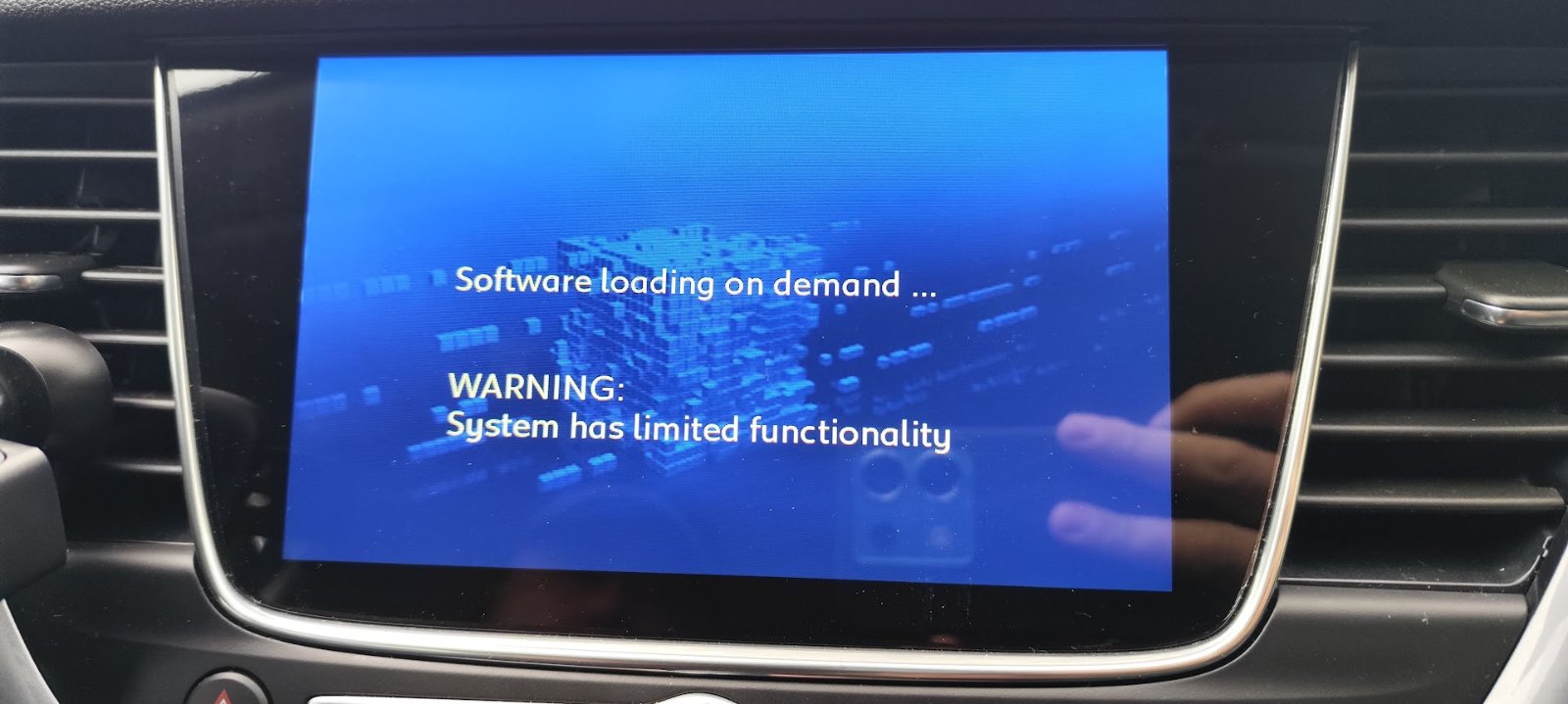

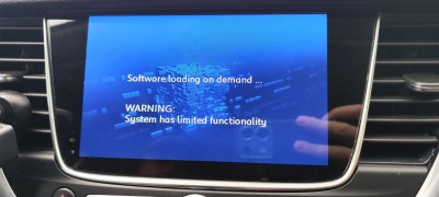

@Paulus33 How did you fix the multimedia problem?
This screen appears when I start the car: After inserting a USB flash drive with a firmware update, this screen appears: Please provide more details about the problem you are experiencing. I have contacted the manufacturer's support and described the issue, but I am still waiting for a response. I mentioned that after attempting a firmware update, the multimedia system does not start.

Please read the reply to you that has already been made by Rui regarding this!:Paulus33 wrote: 26 Feb 2025, 18:39 @rui_saraiva
Yes, there are only maps...
Thank you for your help.
and here:rui_saraiva wrote: 21 Feb 2025, 10:49 @plamen_333
Just insert a USB flash drive with the map update - for your NAC Wave 2 system, the latest European map is 28.0.0-r0.
When the car asks for your confirmation to install that map update, just cancel it. The system should start operating normally, without the "Software loading on demand" blue screen.
rui_saraiva wrote: 22 Feb 2025, 15:56 @Paulus33
This also applies to you: viewtopic.php?p=830789#p830789
Because you already have the USB flash drive with both the system/firmware and maps/cartography updates, just delete the SWL\001*\ folder (system) and leave only the SWL\002*\ (maps) folder.
In other words, to recover a system with the "Software loading on demand" blue screen error, it's usually enough to insert a USB flash drive with the map update, without even needing to really install it.
