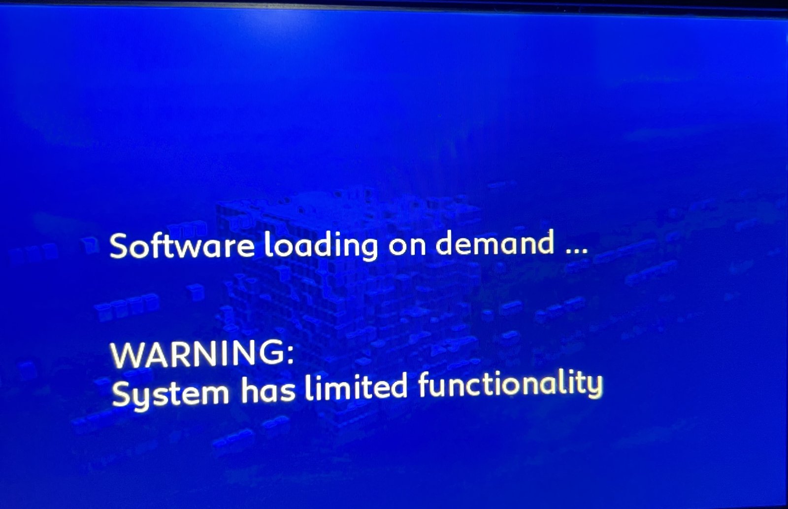

Just insert a USB flash drive with the map update - for your NAC Wave 2 system, the latest European map is 28.0.0-r0.
When the car asks for your confirmation to install that map update, just cancel it. The system should start operating normally, without the "Software loading on demand" blue screen.

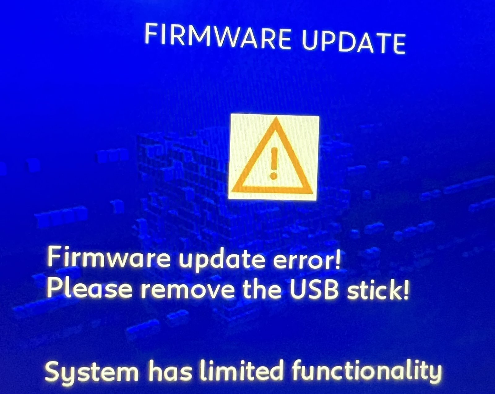

Hi. I'm new here. I updated the firmware and maps on my Citroen C4 Grand Picasso 2017 and it ended fatally. I used the Citroen Update app (Windows 11).
Please help.

The old version was:
21.08.87.32_NAC-r1
20.0.0-r0
new version
21.08.90.52_NAC-r0
28.0.0-r0
I've already disconnected the car battery for 30 minutes and it didn't help.
Please help.
My VIN: VF7**************[VIN obfuscated, can be read by forum staff]
21.08.87.32_NAC-r1
20.0.0-r0
new version
21.08.90.52_NAC-r0
28.0.0-r0

@Paulus33
This also applies to you: viewtopic.php?p=830789#p830789
Because you already have the USB flash drive with both the system/firmware and maps/cartography updates, just delete the SWL\001*\ folder (system) and leave only the SWL\002*\ (maps) folder.
In other words, to recover a system with the "Software loading on demand" blue screen error, it's usually enough to insert a USB flash drive with the map update, without even needing to really install it.

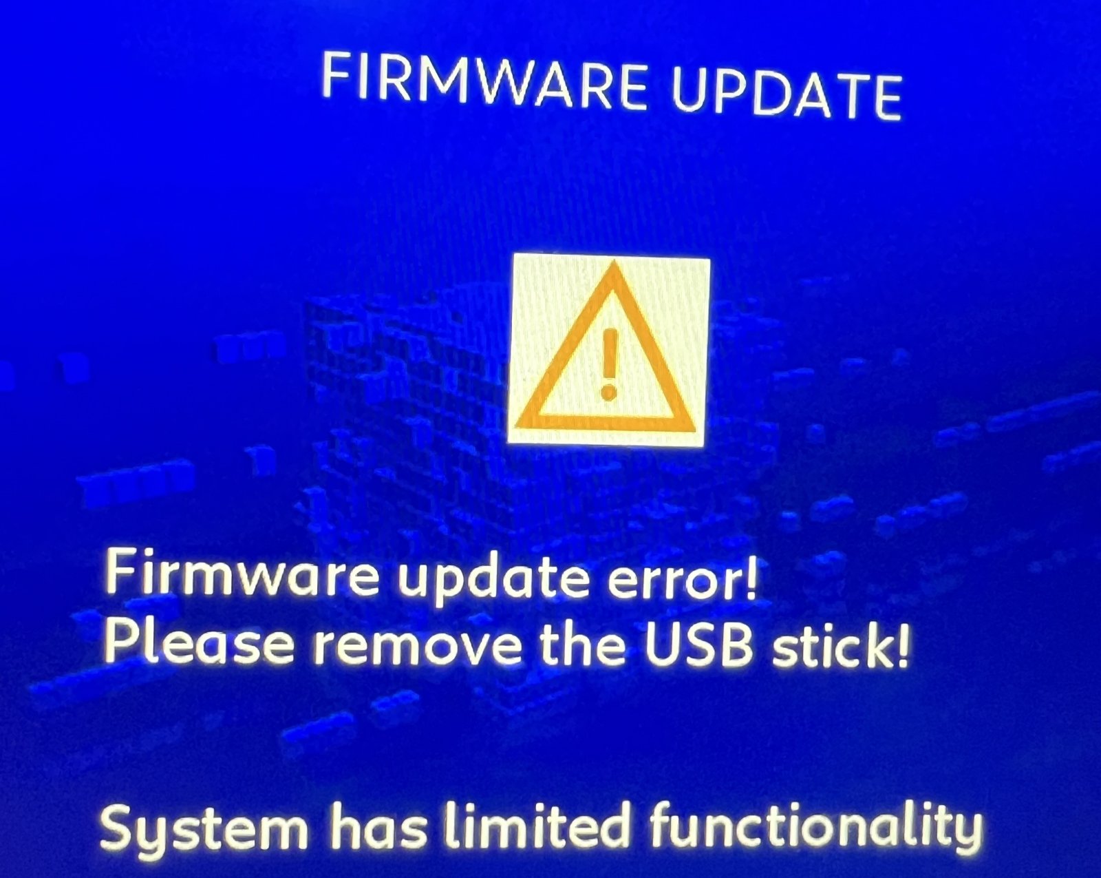

@rui_saraiva
Hi.
Unfortunately, it doesn't work. The blue screen persists, I inserted the USB with the map data, again the message: Firmware update error. Please remove...
I tried many USB sticks. It didn't work.
I did a reset according to: BSI Reset / Battery Disconnection / Reconnection
Again, nothing, it doesn't work, still the blue screen. I'm desperate and angry with the PSA concern. I should have just given up on the update...
I don't know what to do next.
Hi.
