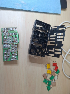

I then turned my attention to Bluebell's fusebox intermittency; a problem that was getting progressively worse during the last times I drove her...
The fusebox was easy to remove for a close look on the bench...
The fusebox is all plastic welded together and not intended to be dismantled. A bit of careful dremel, drill and scalpel work soon had it in pieces...
The problem was immediately obvious... A very dry joint on one of the connector spades:
And signs of overheating around it.
I now need to procure some small nylon screws to properly reassemble it and do a proper job but for now it will hold together well enough to prove all is now good.
Reassembly today and a test run. I'll be good to take Bluebell out for a drive again without her electrics dying on a regular basis!
