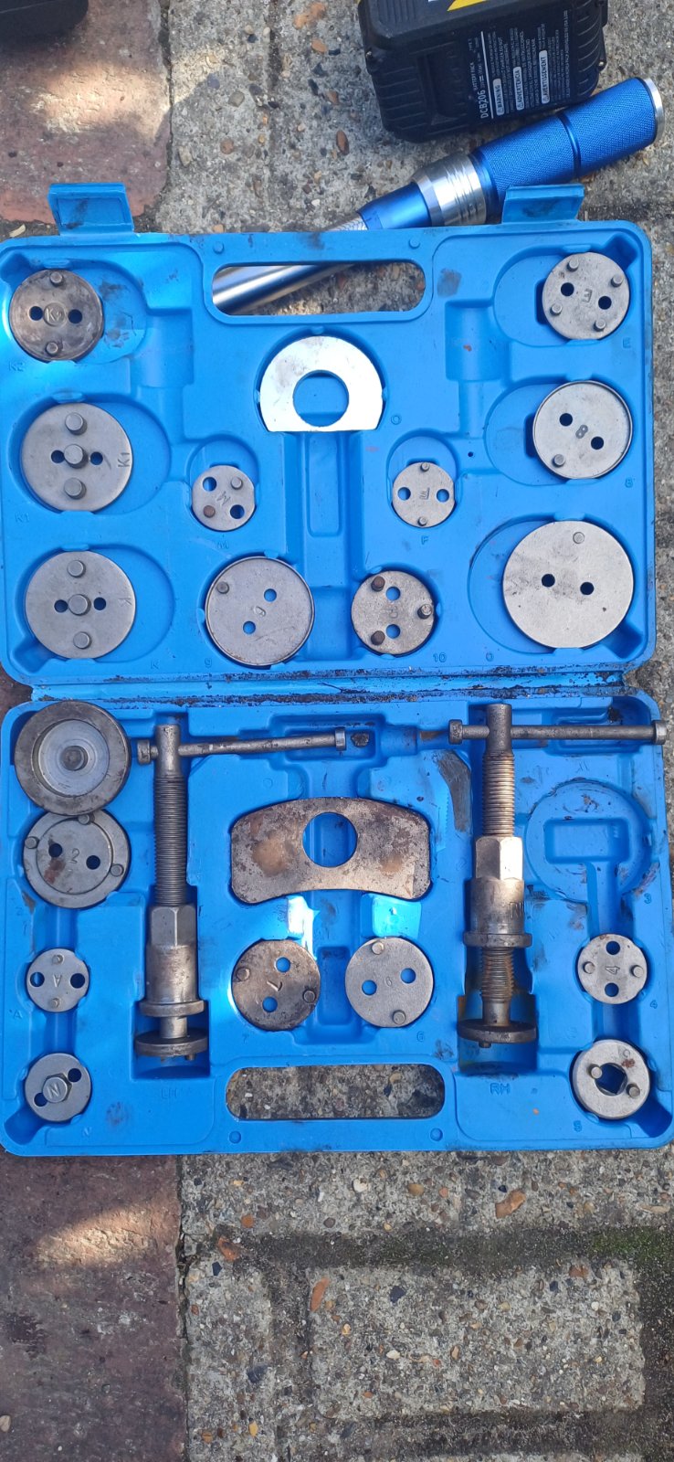

This little set was less then twenty pounds and has paid for itself no end of times .
