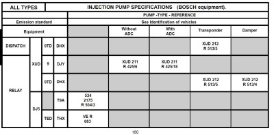

Is the sheet you attached from Citroen or Bosch? What's on sheet 179 and 180 regarding the astrix after the R425/*
The information I get on Haynes Pro for a Citroen Relay DJY is giving the static timing as 1.07mm. Is your data a more reliable source? I had a quick measurement of it the other night and from memory it was around 0.80mm with the cold start cable that's connected to the wax stat disconnected from the injector pump. This would make it close to your data sheet.
Thanks for the reply.

Re: 1999 Peugeot Boxer 1.9D Static timing
These are official Citroen documents
I have attached page 180, there is nothing on p 179 relating to your engine code
