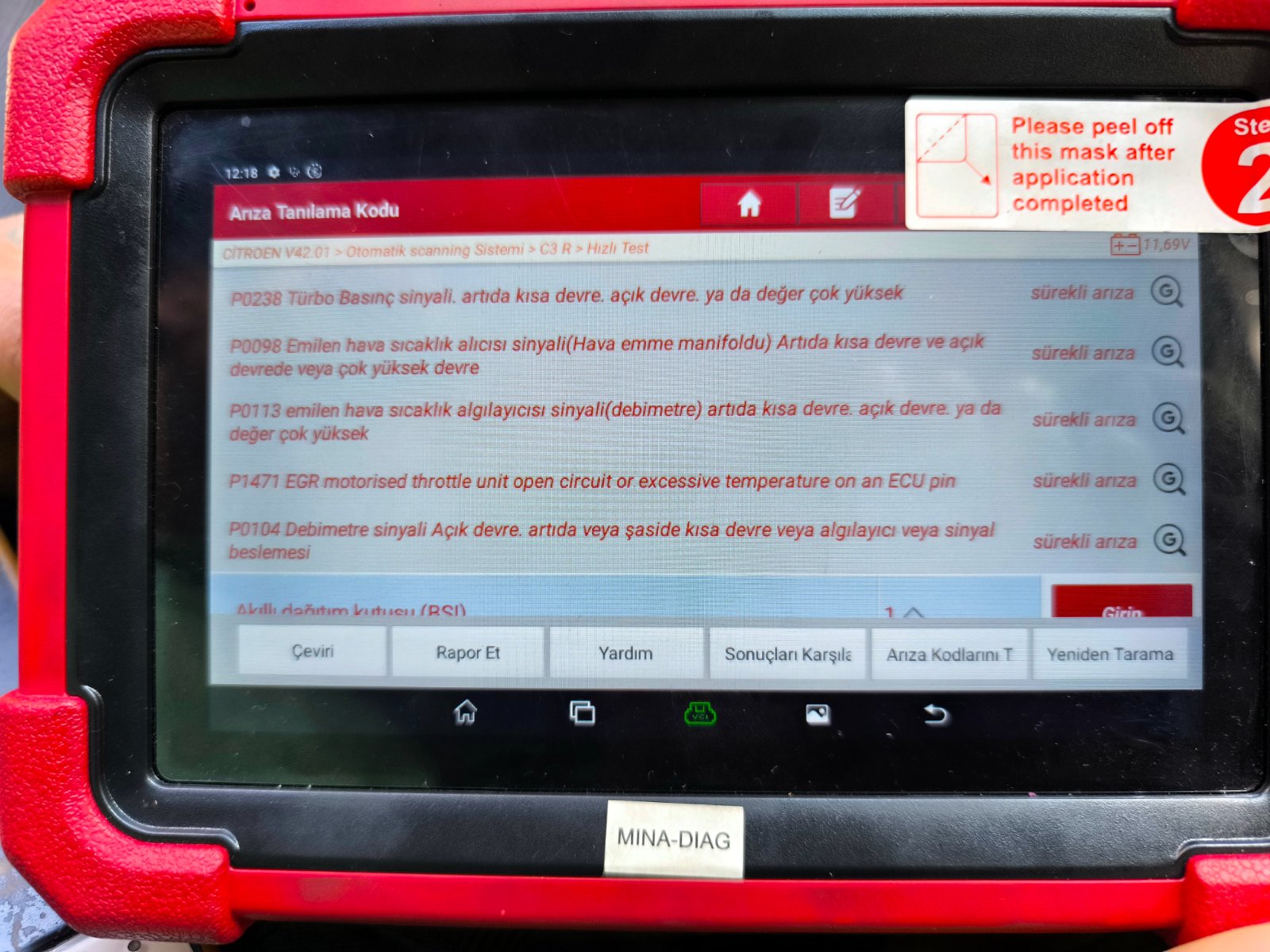

C3 1.4 hdi xfurio 8v 2008 model
P0238
P0098
P0113
P1471
P0104
Hata kodlarını alıyorum aracım Türkiye aracı ABS siz model 8 valf. Buhata. Kodları sürekli ağrızada yardımcı olabilirmisiniz kablo tesisatını komple inceledim kopuk ezik veya oksit yok beyin dendir diye beyni değiştir ECU ondan da deil sensörler de denedim ama sürekli hatadan çıkamadım
C3 1.4 hdi xfurio 8v 2008 model yardım lütfen

Could you also give the definitions for the fault codes but possibly you might have a fault with the MAF sensor, try with it unplugged to see of the codes change after you delete the existing ones. Also note down the freeze frame data before deleting as it might help diagnose the fault.

I'm getting error codes P0238 P0098 P0113 P1471 P0104. My car is a Turkish model, non-ABS, 8-valve. These error codes are persistent. I've checked the wiring harness completely; there are no breaks, dents, or oxidation. I thought it might be the ECU, so I replaced it, but that's not the case either. I've also tried the sensors, but I can't get rid of the error.
I tried the new sensors, but the same errors persist even when I clear them; they keep reappearing as permanent faults.
