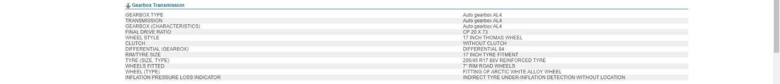

The following are my vehicle's specifications:
