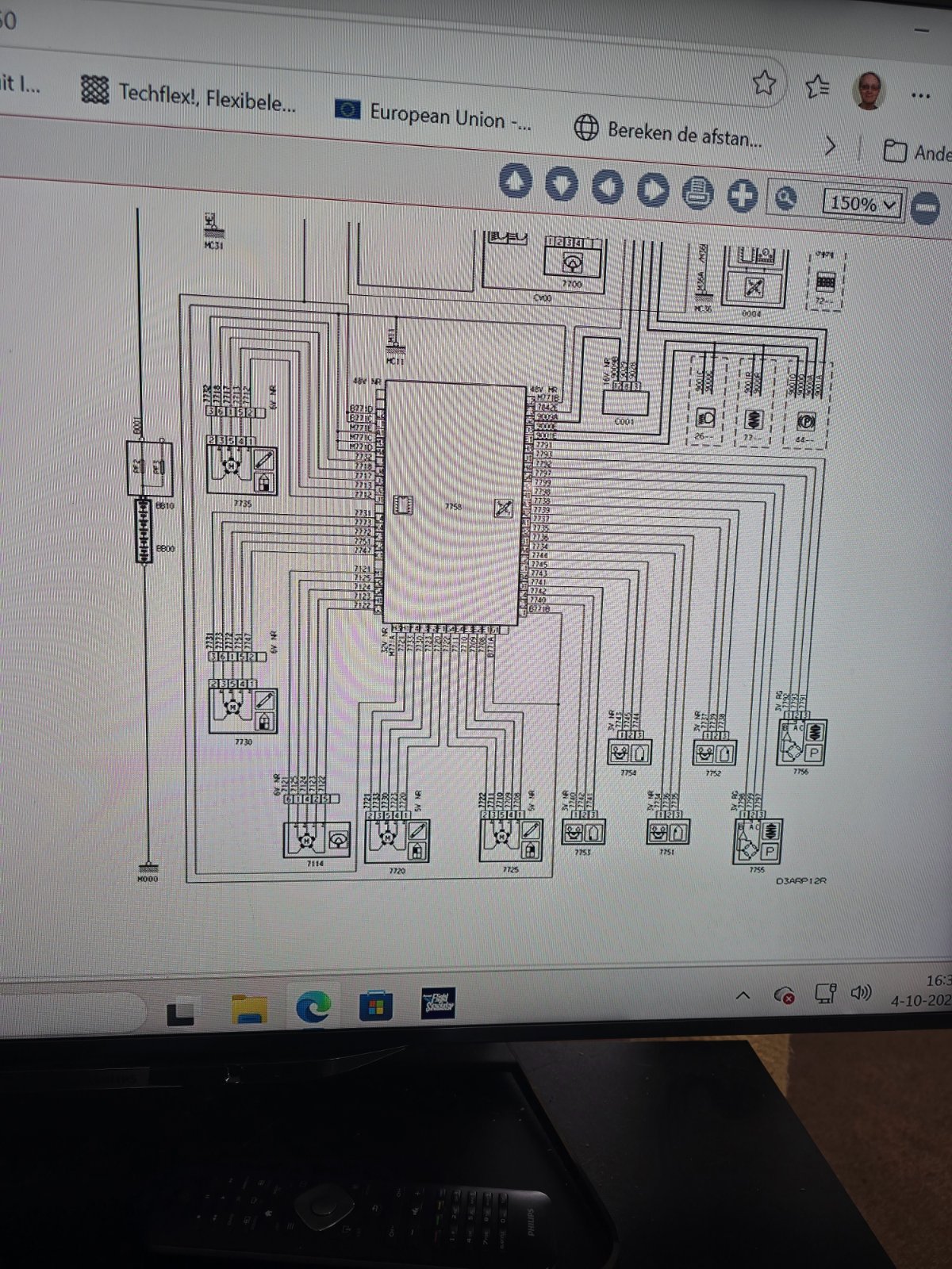

I find the schematic of your car, and if you look at it, there's no BHI, all is done by the Variable Damping System.

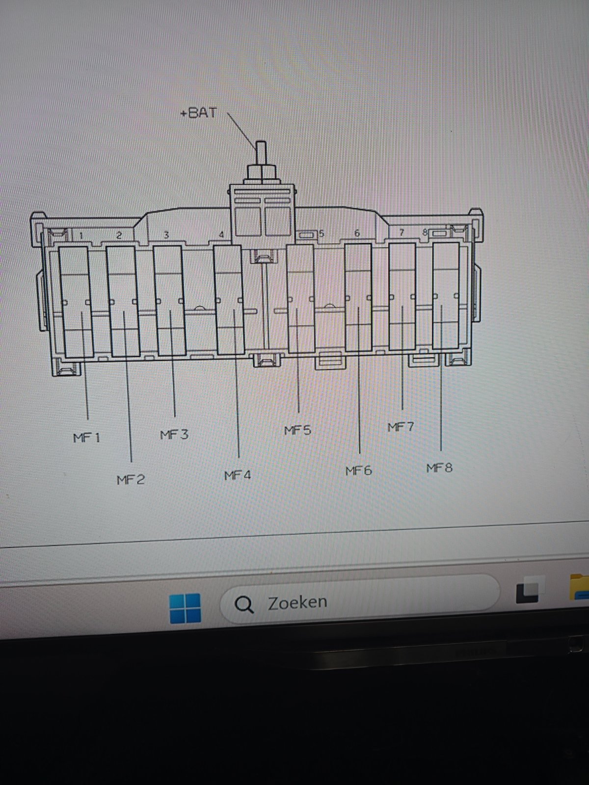

Did you check fuse MF8 20A "computer activity variable damping"
You can find this one in PSF1, it's the one, where the + from the battery is connected.

You mean the one beside 40A for the pump?
OnlineKees
- Posts: 599
- Joined: 16 Nov 2021, 16:16
- x 147
Re: C5 X7 'Suspension Fault'.
No, this one
tpehant
- Posts: 7
- Joined: 28 Jul 2024, 21:17
I've checked those and they are ok. Thanks for the hint.
