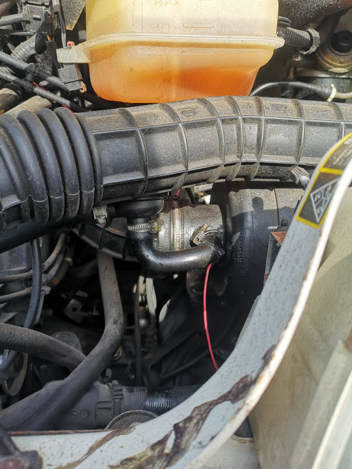

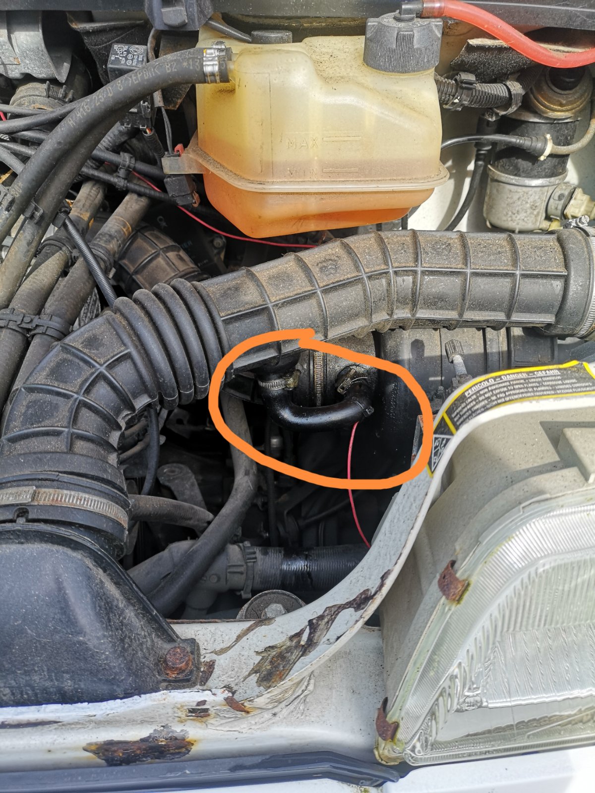

Hi,
My oil vapour hose has a slight split at the top and needa replaced. I believe the OEM number was 1192E1. For the life of me I can't find this anywhere and my mot is due. Can anyone help or point me in the right direction. It does leak a bit of oil so it will fail the MOT.
Thanks in advance.
Tom

You should be able to seal it with self amalgamating tape to get through the MOT and then replace it when you can find one! :)

What is the red wire for zipped tied to the pipe? I may have very similar I got for a Xantia years ago but never fitted it.
It's not exact, it looks like the ends are different sizes, correct me if I'm wrong. The pipe I have (if I can find it) both ends are different sizes. As mick says, you should be able to seal it temporarily with the tape.
