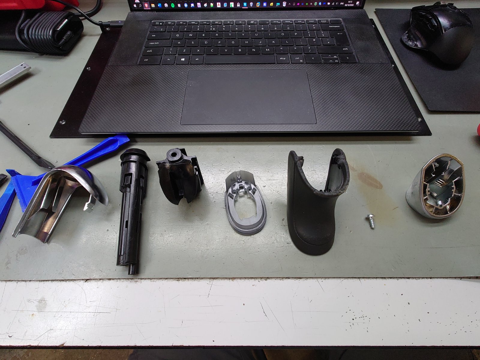

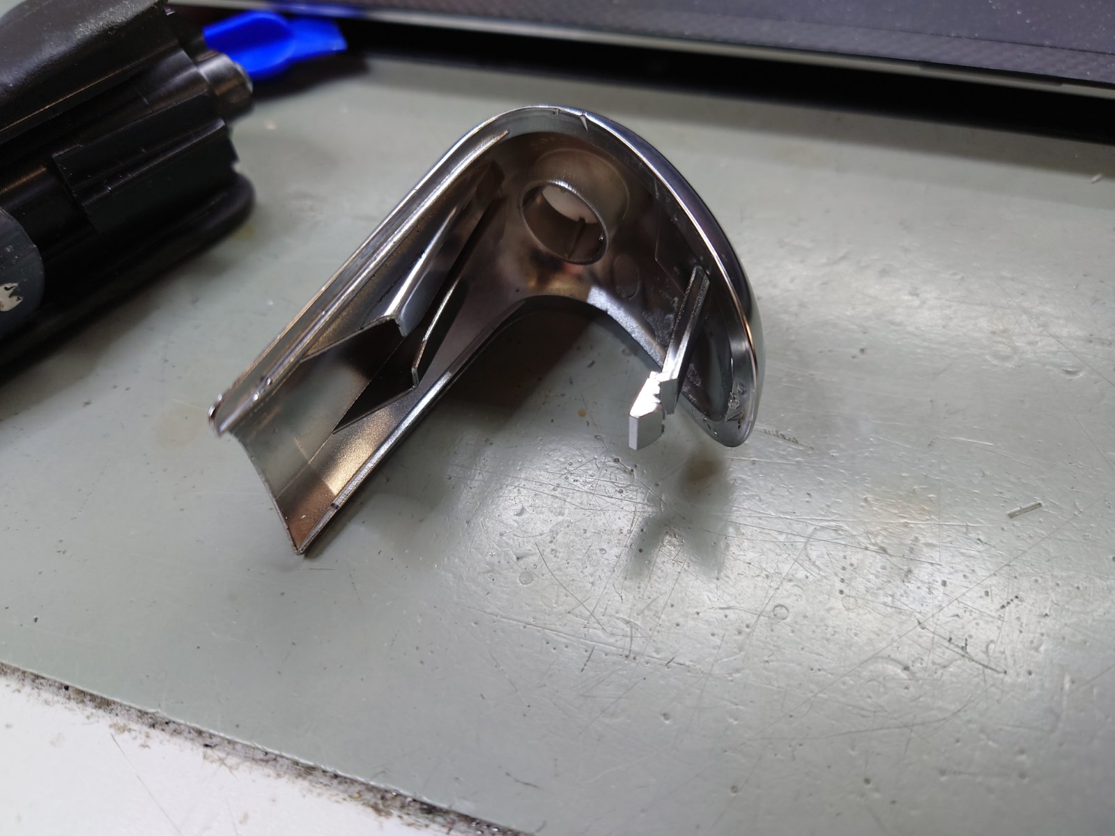

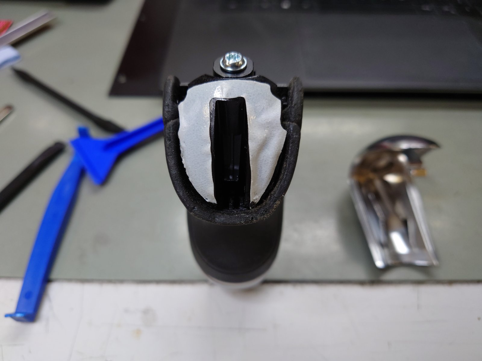

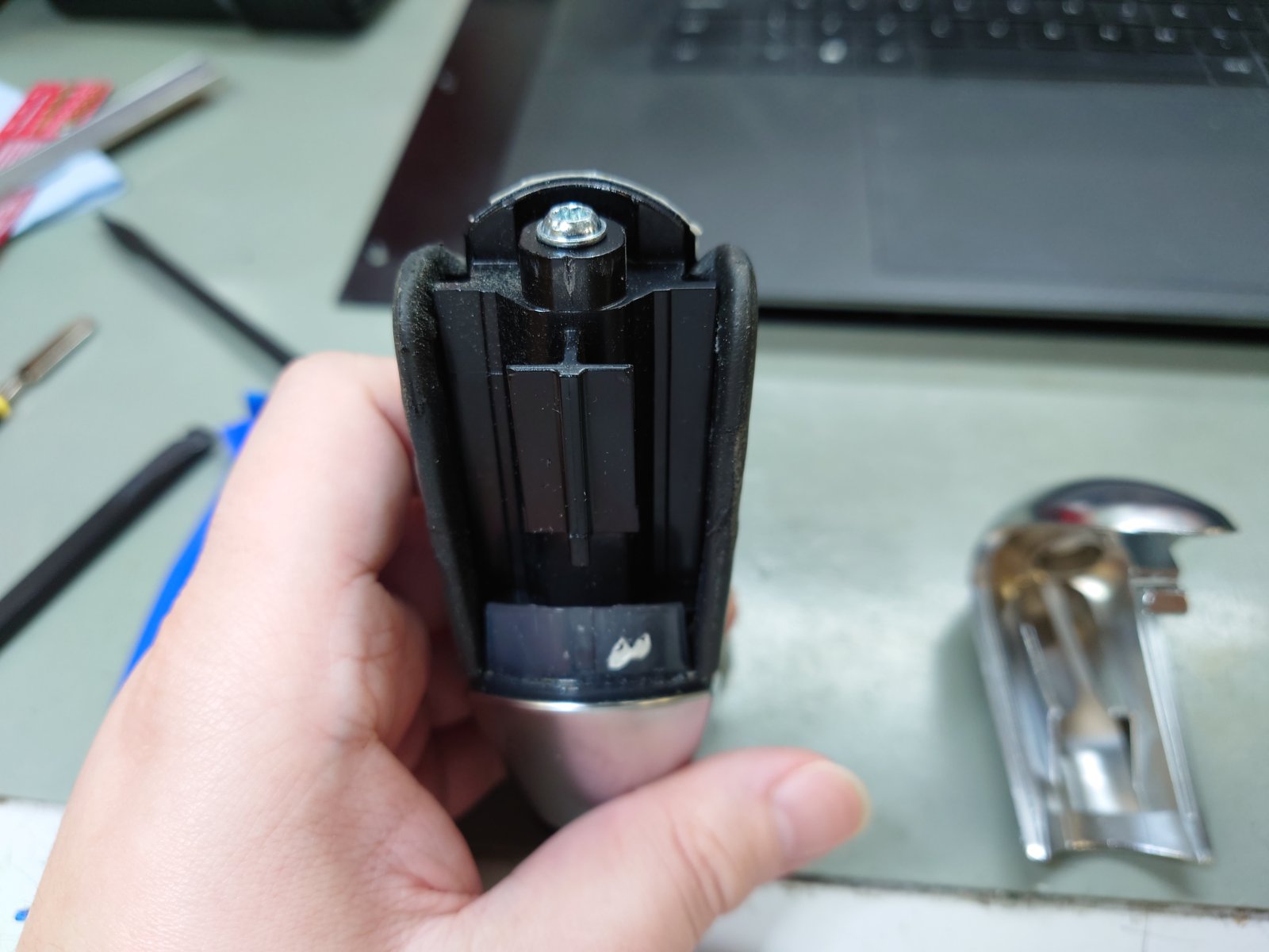

Ok, so things might have gotten a little out of hand. After the initial failure, I decided to tear the knob down in an attempt to flip the mounting channel by 180 degrees so that I could mount it backwards. Well, it turns out nothing inside this thing is symmetrical, it's all keyed. Even all the bits on the "outside" of the mounting channel are keyed.
Construction-wise it's actually quite disappointing. It's almost entirely plastic and is a combo of clipped, screwed, and double-sided-taped together. The "metal" surface on the top plate is actually a plastic panel with some kind of metal foil covering it to give the metal feel. I don't even know if the leather is real. In comparison, the knob of my old manual X7 was a solid lump of metal wrapped in real leather. Though I suspect the cap with the gate map was the same sort of plastic / metal-foil affair. Can't speak to the construction of the auto knob on the X7 but it feels built solidly enough.
It wasn't in the cards, but I guess I'm now designing and printing my own custom gear knob that'll fit LOL. I'll probably share the designs when I finish it, but they're unlikely to be useable for most people. It'll basically use the mounting channel I got out of the 508 knob and printing something to fit over that. The issue is that the channel can't be sourced on its own. The only way to get it would be from a gear knob. I have no clue if all PSA cars with that channel have the same "outer" features that the custom knob would fit over and I doubt the AliExpress knock-offs are designed in the same way as well.
Either way, here are the few teardown photos I took:
